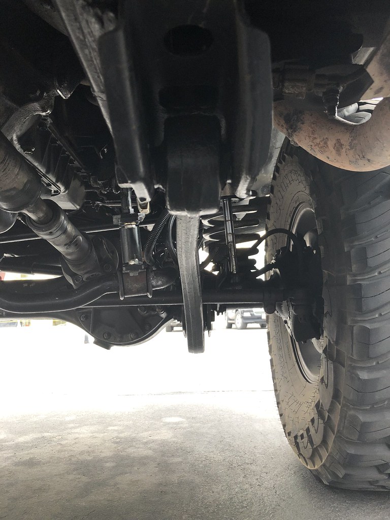

Some product development. Since the install of my HD Whiteline rear swaybar I have been eating the bushings in the swaybar links. With bushings you get too much give before the bar starts to work IMO and wanted to eliminate that also.
Started with this and it looked like it may work.
1948640
No problem with the articulation.
1948646
Totally killed the set up in one short weekend of wheeling. :wtf: On to plan B
1948647
Much stronger, makes for a tight set up and more adjust ability to work with other set ups. Not sure with joints giving only 23° of movement will make the cut. So far liking the set up on to some more real world testing.
Thanks Scott. This set was built to order. I think Figs is waiting for us to put them through the wringer, confirm their quality before he adds them to his product line.
Curious how the bushings hold up. Are they just poly bushings? Is there any "wristed" rotation in the arm at all to take some stress off the bushings?
I've used OeM everywhere but on my Power Steering, I had to use constant tension breeze clamps, they are max out and I can still turn the hose a bit on the large supply. Weird.
That’s true power steering leaks with OEM clamps.
Good questions. They are fitted with SuperPro poly bushings. We're curious to see how they hold up too. They're only a few thousand miles old so time and use will tell. I think we would need to fit the arms with perhaps some piezoelectric strain sensors to provide an accurate answer to the "wristed" motion question. But that is tech lab engineering work. I have taken it upon myself to do the slightly less academic but greatly rewarding field testing. I'm selfless like that. ;) I will try and give you a more definitive answer after we tinker a little more.
No need to get all scientific on the rotation question. Some arms allow for some rotation (wrist) at the adjustment joint so that the eyes can stay static in the mounts. Reduces a lot of wear of poly bushings, that can get trashed pretty quickly in high flex applications.
