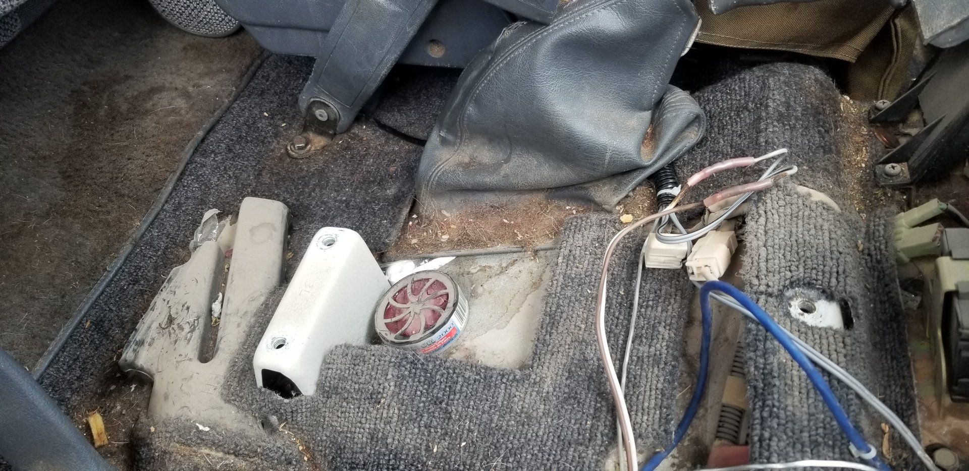

Wasn't this weekend but I started on a list of noises. For the last 6 months it has sounded like something was rolling around under my passenger seat or loose in the passenger door panel. Turns out it was a really old air freshener that someone stuck under my center console with some double faced tape. It must have finally came loose. It was making a huge racket under there lol. It is probably a good thing I pulled the console. It needed a good vacuuming.View attachment 1950138
I pull my console about once a month for just this reason. I have four kids...there is ALWAYS something nasty in or around my center console.
