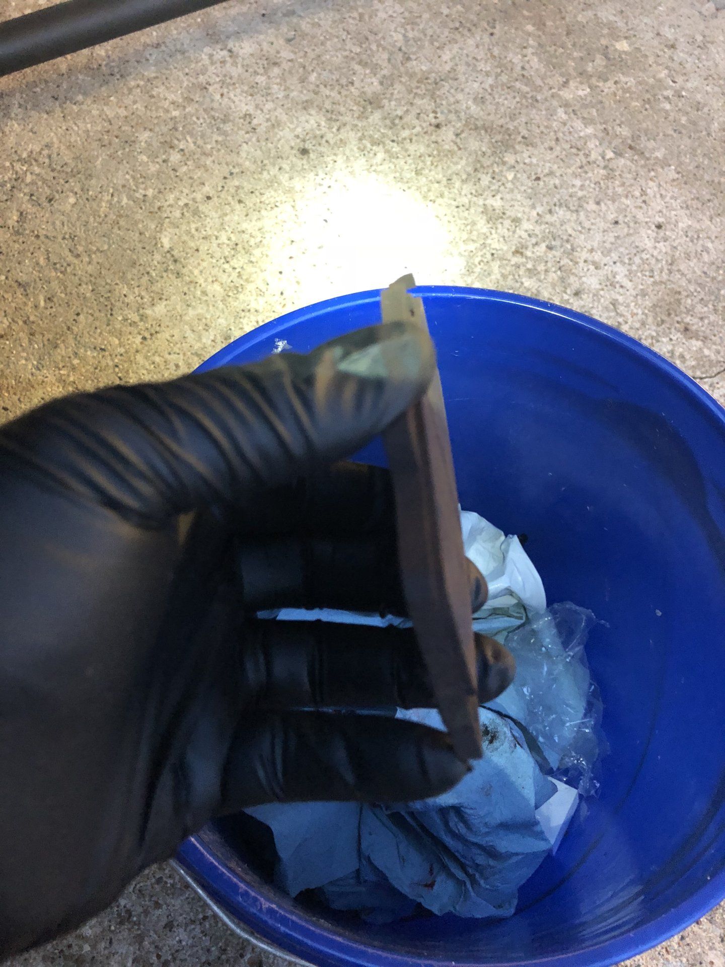

Got home and decided to replace the front pads on my son’s ol’ 92. Passenger side was down to the warning thingy. Started thinking about when I replaced them. Looked at the spreadsheet, sh!t only 10k miles ago.
Got to the driver’s side and found this... pads look like new.
So, what would cause there to be such uneven wear. Both pass side pads were the same. Both driver side pads were the same. But comparing side to side the pass side is doing all of the stopping or something.
Time for new calipers? Master cylinder? I don’t have any clue...
Well the first clue to me would be all the grease and oil on the brake caliper. The pads are not braking they are sliding. Fix the leaking oil and grease and make sure the caliper works.
Yep.
Caliper rebuild or renew and Front axle jobber up next. At least you are experienced now @LS1FJ40
