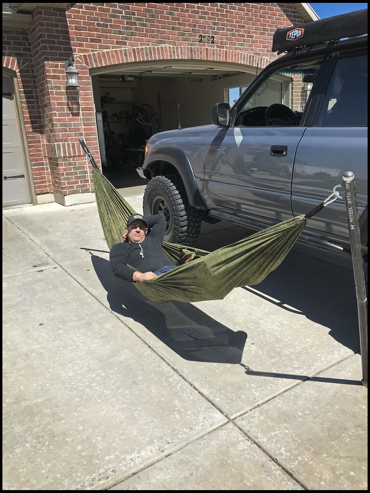

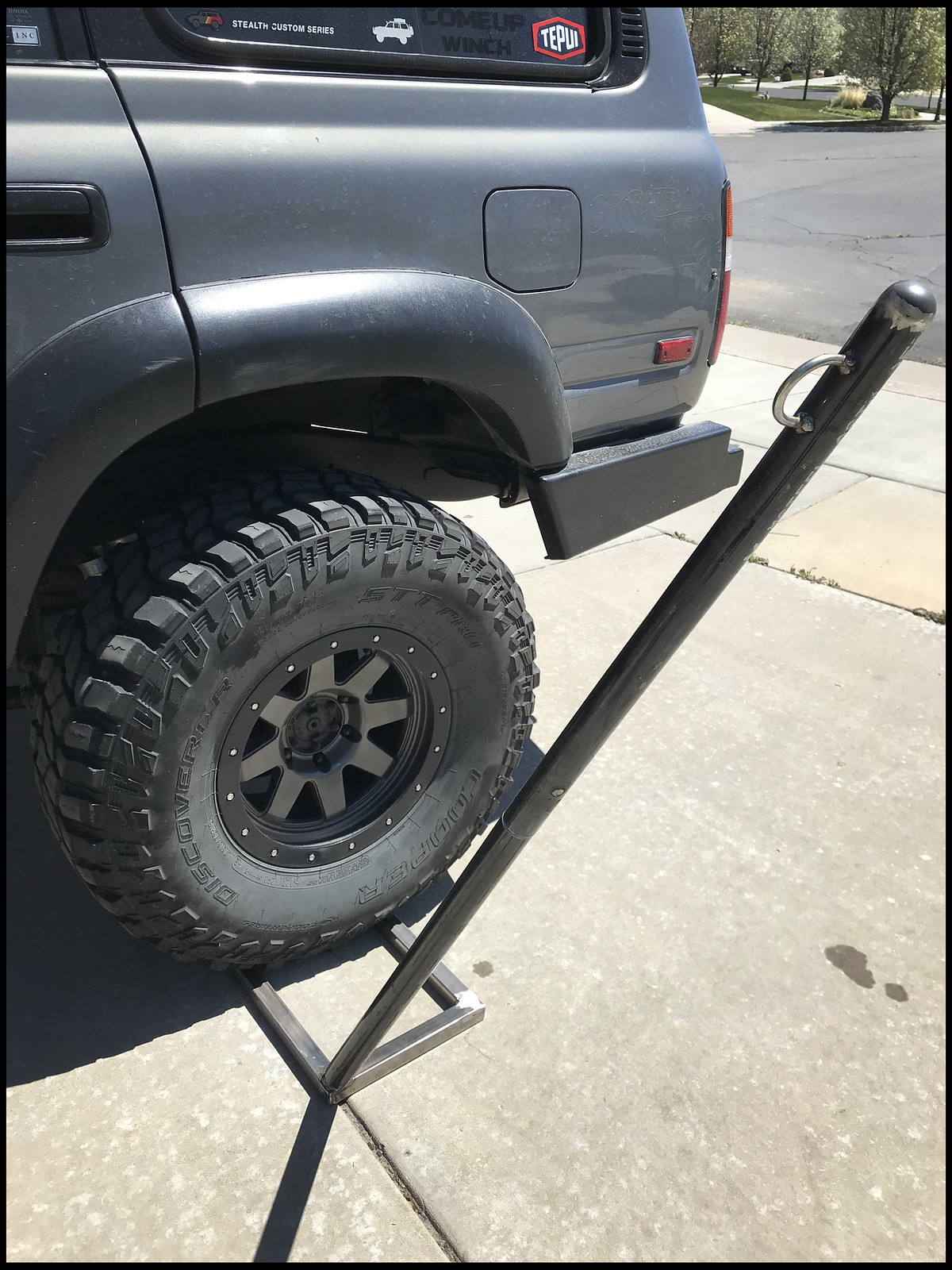

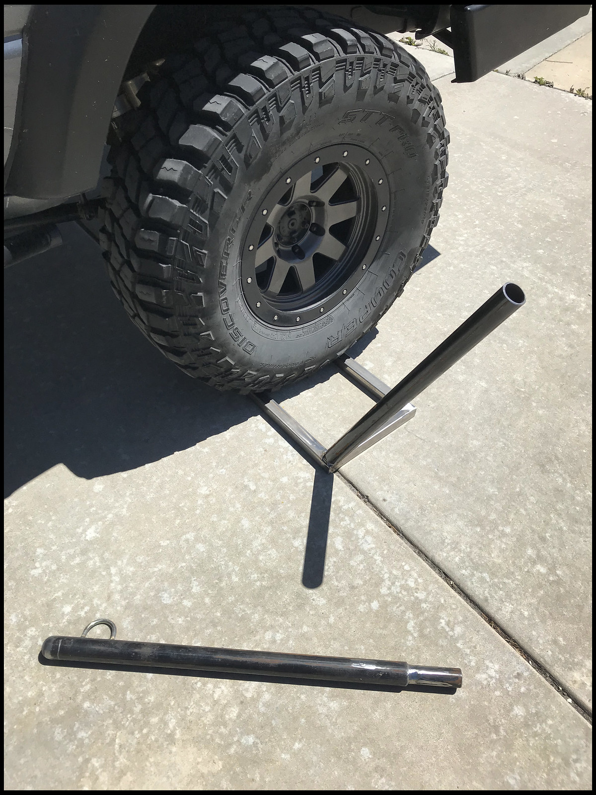

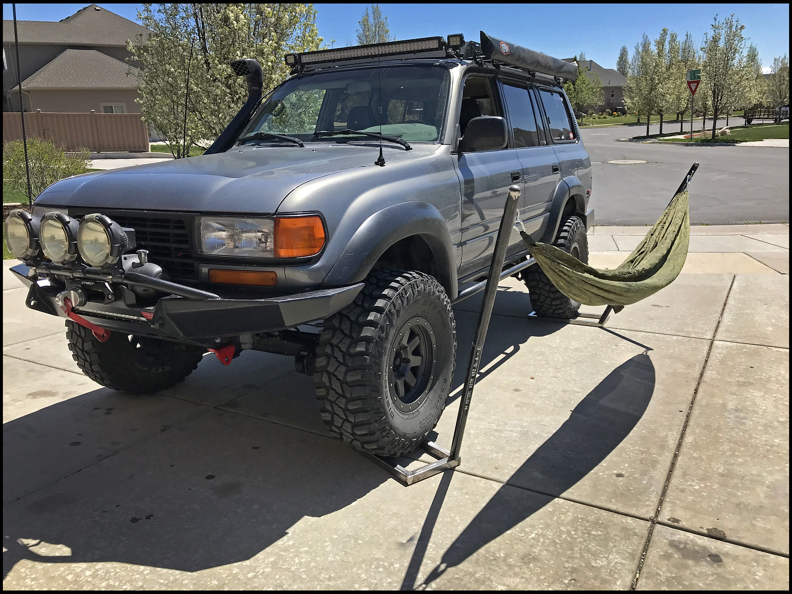

Besides swapping the mirror on Saturday I whipped out a little project. I am doing a 5 day trip ( SW Adventure 2018) with Slinky delaers and customers starting on Saturday and finishing in Moab next Wed in time for CM. I decided I didn't want to take my Tepui tent with me this time but didn't want to sleep on the ground. I got an idea for a hammock stand from a dude on IG. I've seen something similar that attaches to bumpers but I didn't want to modify bumpers. This was a cheap and super easy and seems to work well in my driveway. :) I'll use this on the 5 day trip and see how it goes. Will be my first trip sleeping only with a hammock. I used about $30 of steel I had laying around some 1.5" tube sleeved with 1.25" tube inserts, plug and end welded. I had the hammock already that I got for free from a vendor at Outdoor Retailer a couple years ago and have never used. So all in all was a easy and cheap project. What's not in the photos is a couple ratchet straps that I use to counter the tension from the weight in the hammock. Don't think they are necessary but give me some piece of mind. They attach to the posts and back to the base. Built it in pieces so it packs up easier.
