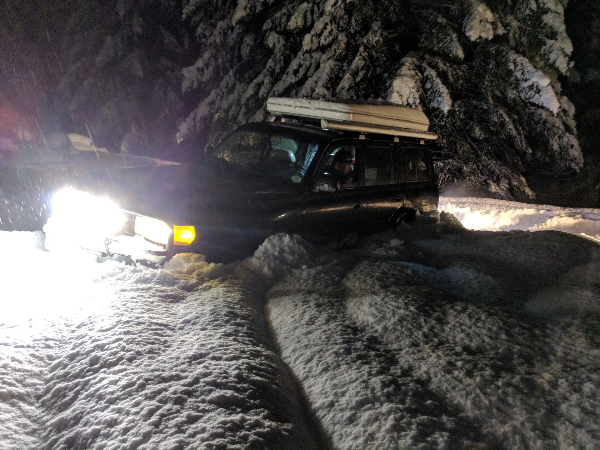

Went looking for snow. Found some.
Truck pictured isn't mine. It's my buddy Salue's. He's a member on here somewhere.
He asked if I wanted to take the lead. I was like, "you go for it, buddy." I didn't know that those that don't plow, dig. Sweating with your shovel in 4 feet of snow is a unique experience.
This is Beckler River Road in Washington Cascades.
That looks quite a bit deeper than last year.
