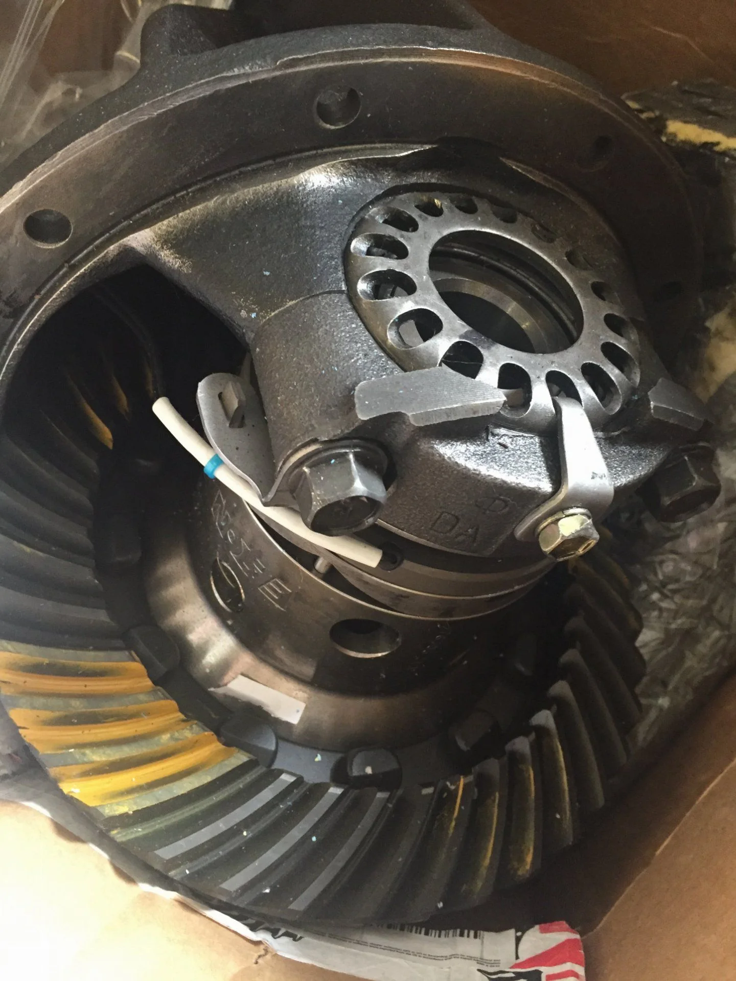

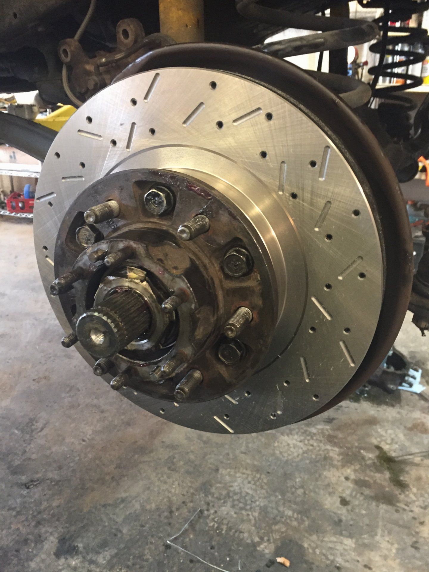

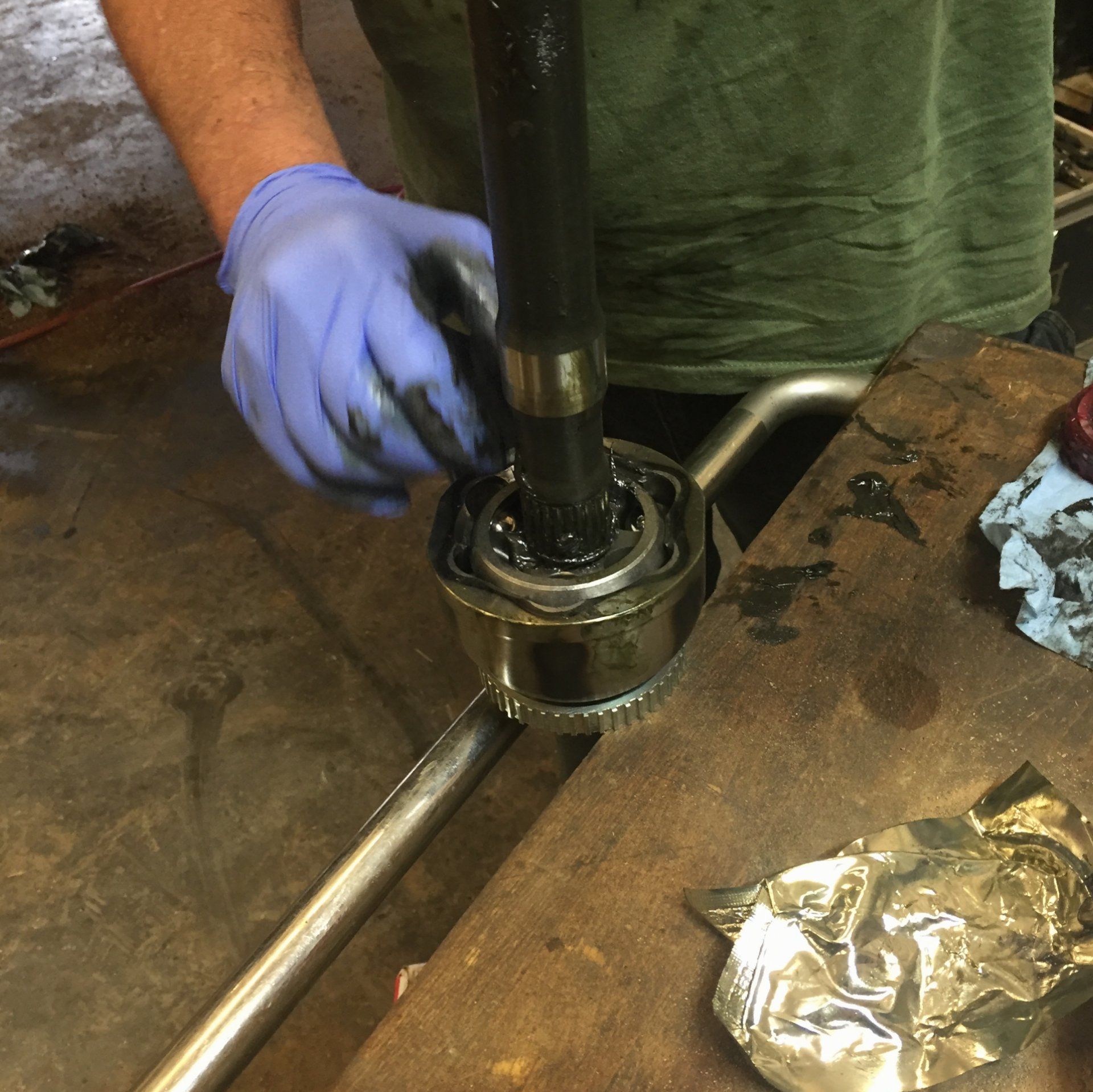

A major milestone in the life of my 80. I installed my new third members, replaced the birfs, rebuilt knuckles, installed high performance rotors and brake pads.
Thirds were upgraded with Harrop eLockers and 4:88 Sierra Gears. Brakes, birfs and knuckle kit were Terrain Tamer.
Thanks to Cruiser Brothers and Valley Hybrids for the parts and to Ken Francisco at gearinstalls.com for doing the setup on my locker and gear install. He even posted my project on his website. Harrop 488 Sierra Gear

A few questions. What rotors and pads did you install? Also can you say what gearinstalls charges for the work depicted in the link?

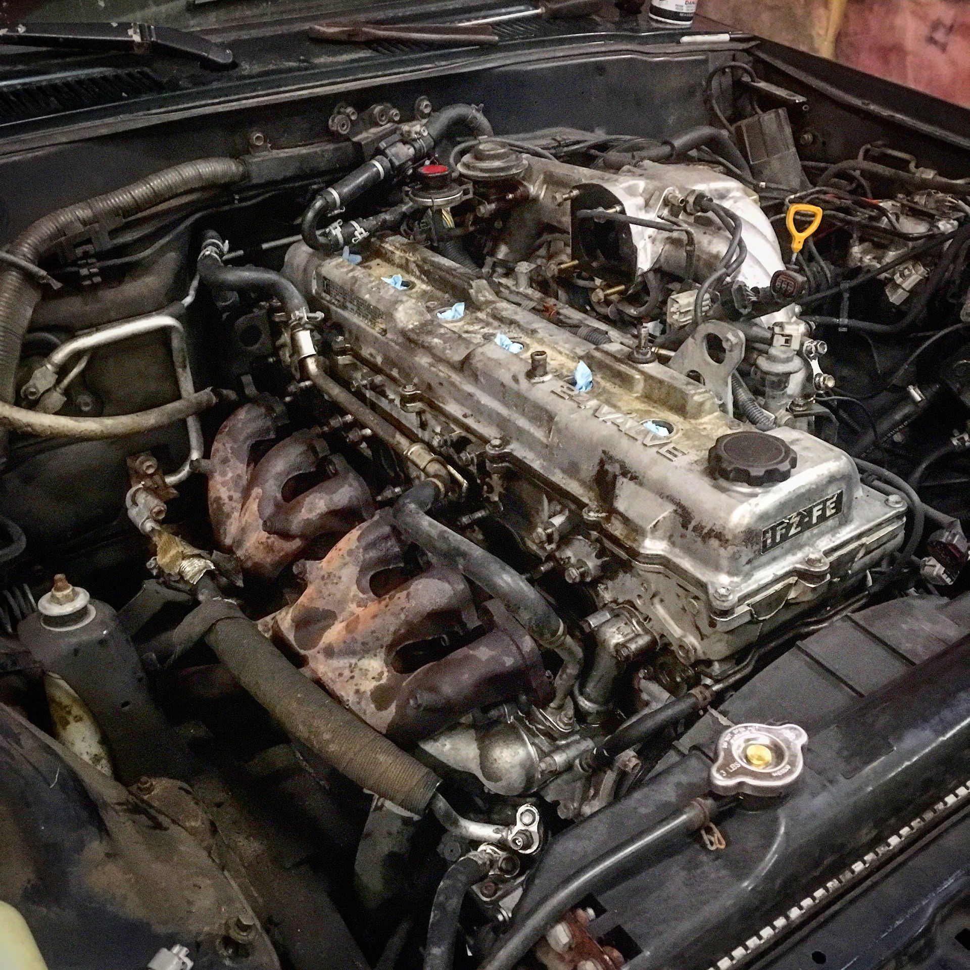

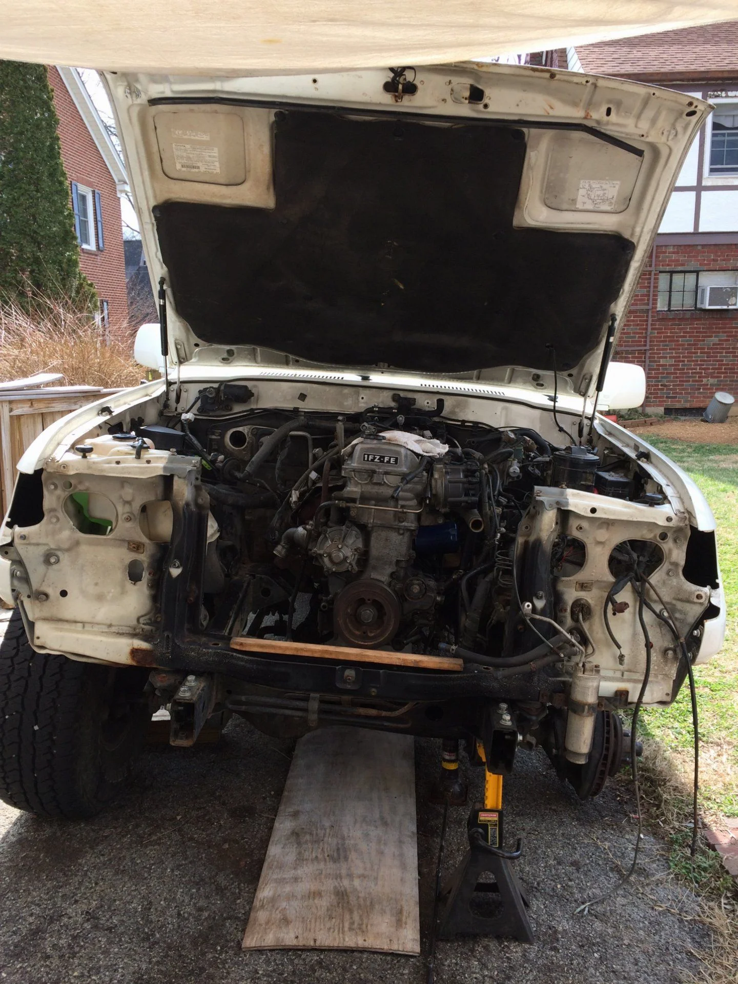

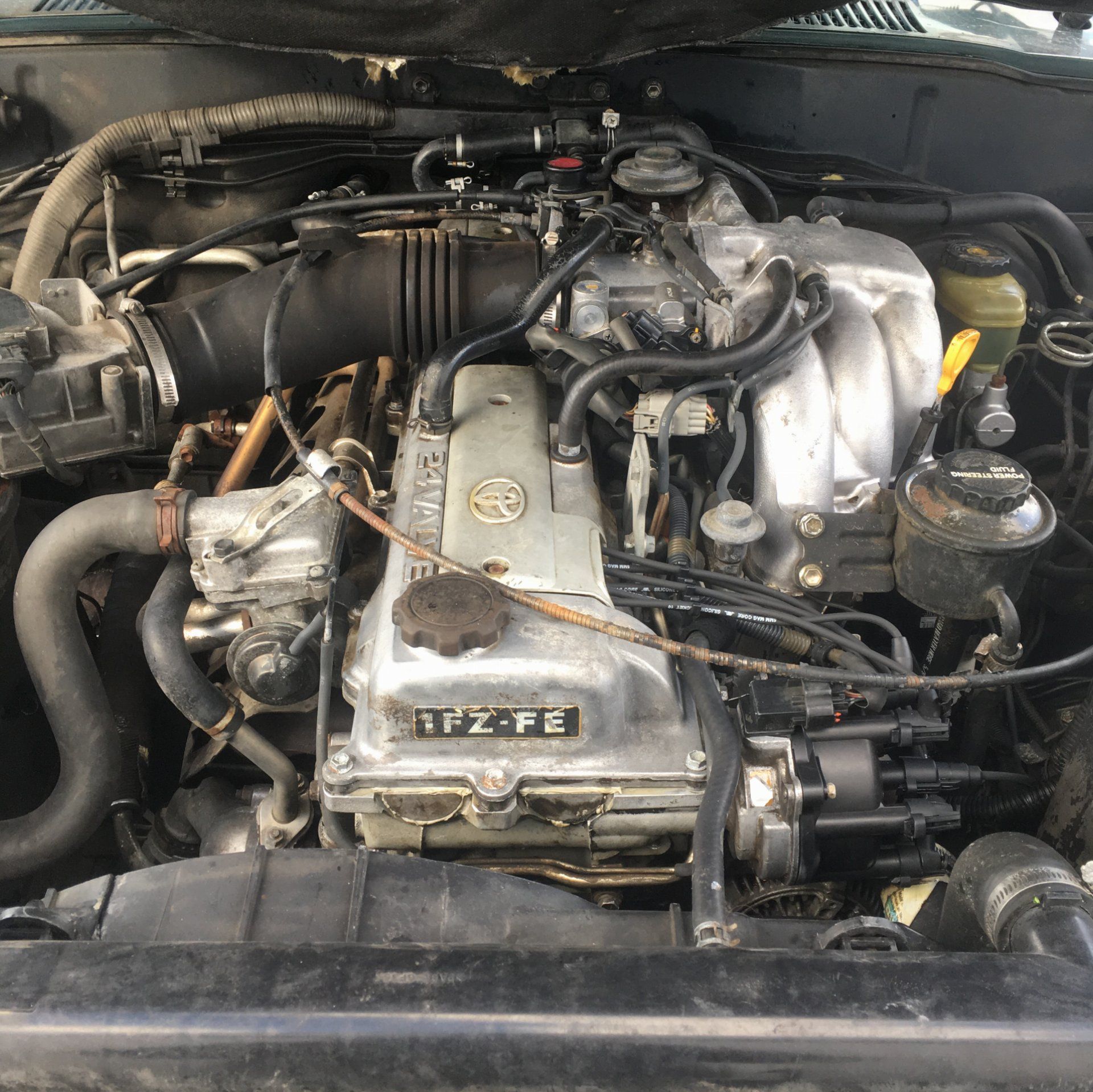

Well, Castrol super clean and hot water pressure wash, because A) head gasket time and B) it was +9C today, and it's February, in Canada.
Little cleaner now.

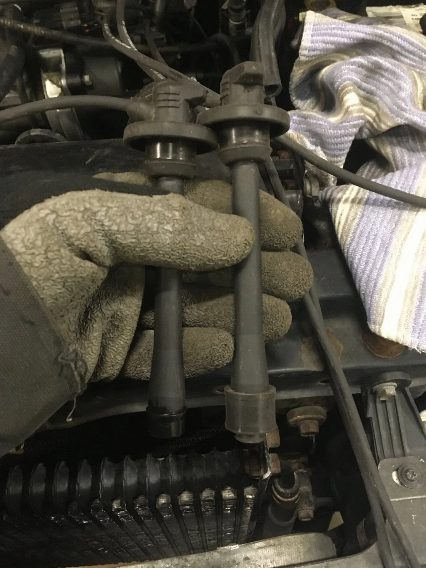

Then proceeded to tackle a "simple" start. Pull the plugs. Yeah right. Notice what's missing on the left? Two of them - guess where they are. How the F%* do I get those out so I can get the plugs out??
-(Tried crazy glue, didn't work)
-Kelly clamps are not long enough.
-compressed air doesn't pop them out.
- cursing doesn't have any effect

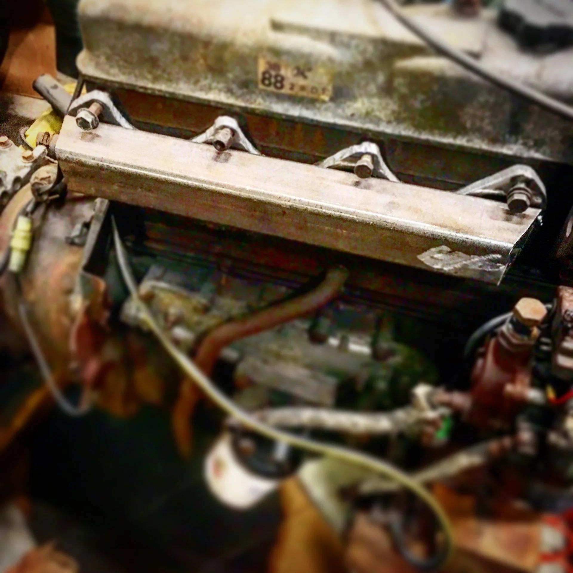

Gave up. Pulled the hood off and then went back to welding the megacheap turbo manifold for the BJ70.
Had the same thing happen to me on #6..Took me longer to realize this than I care to admit. But what works well is a long angled pick.jab it into the rubber and twist it out.
Ken checks in here on ih8mud and we'll have to let him quote it. Go on his website for contact info-he's very good about getting right back.
I've had 3 diffs recently done by him with harrops and can give my highest recommendation.
Rufus was driving and Mikko (neighbors dog I refer to as "Kitty") was shotgun. Slowly becoming a :banana::banana: shade tree mechanic. Motor is back in and I am making progress on the electrical. Should have waited an extra weekend to get injectors back. Putting everything back together while the engine was out of the truck would have been SO MUCH EASIER! Wasted Saturday trying to get the EGR pipe reattached. I finally gave into the temptation of #6 and said F#*^ It. I am constantly amazed at how high my tolerance is. Sunday afternoon was a breeze thanks to my daughter installing the EGR pipe. Sped things up a little after that.
The pads and the high performance rotors are from Terrain Tamer in Australia, their US importer is Cruiser Brothers. Cruiser Brothers
The re-gear and harrop install was $350 per third. As you can see from the link, he is very detailed and knows his stuff. I had the parts shipped to him direct and I sent two third members to him and he shipped them back read to to install. I drive my truck daily so I picked up a couple of thirds and sent him those so I could keep driving my truck until I could get to the install.

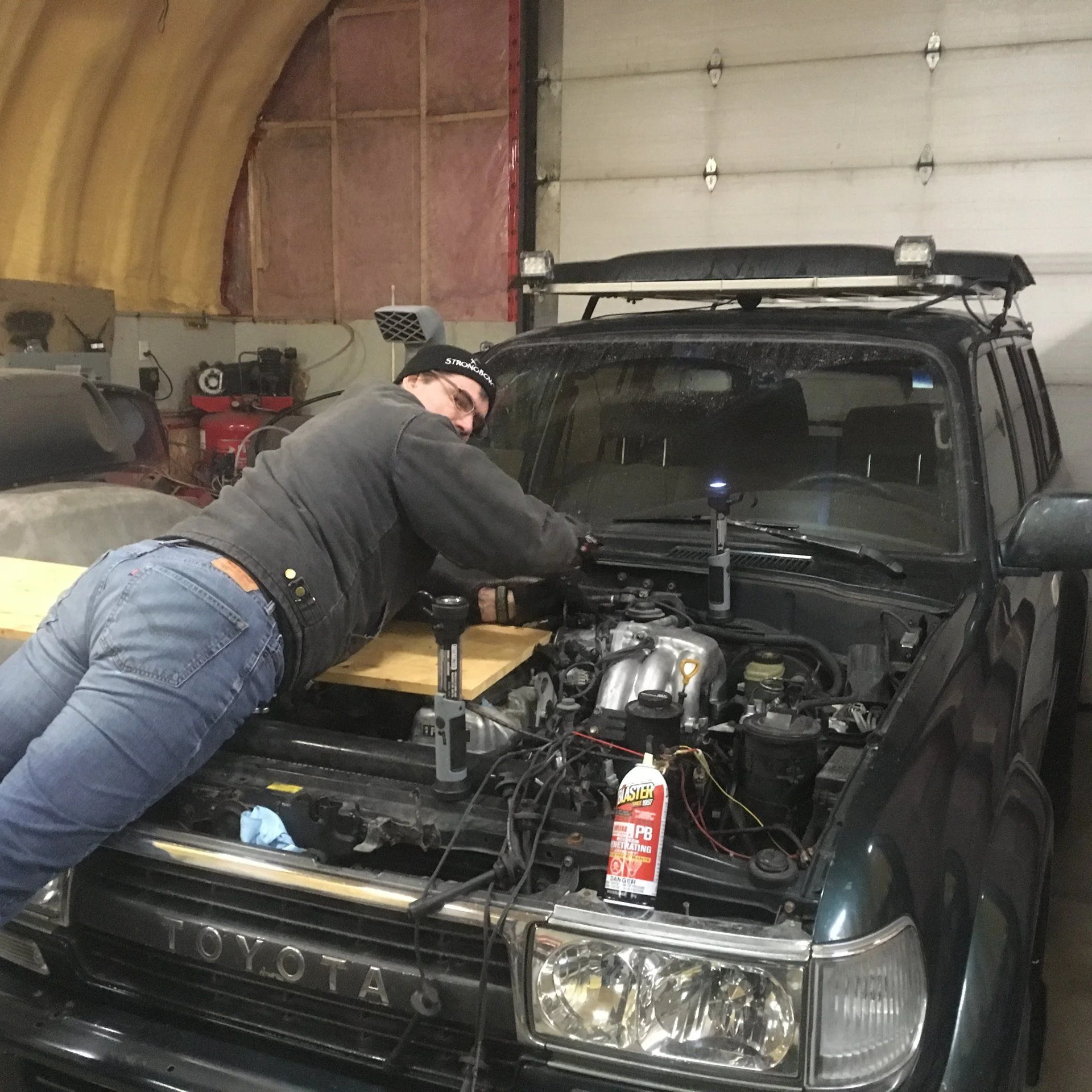

Still the weekend. Holiday today. Friend came by to motivate me and we started tearing into the head gasket job. He was the designated board crawler.
I will say one thing, owning a truck that lived 95% of its life in California and New Mexico is a HELL of a lot easier to work on than one that has been in Canada all its life. These bolts are coming out like they were put in yesterday.
Attack #2 tomorrow night, then hopefully have parts to put it back together for the weekend.
Yep, my buddy managed to get them out with two pieces of TIG rod bent with little hooks on the end. What a pain in the nuts.
