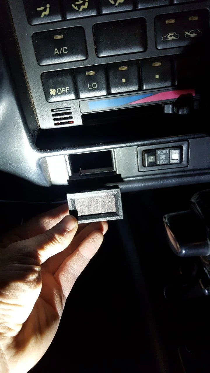

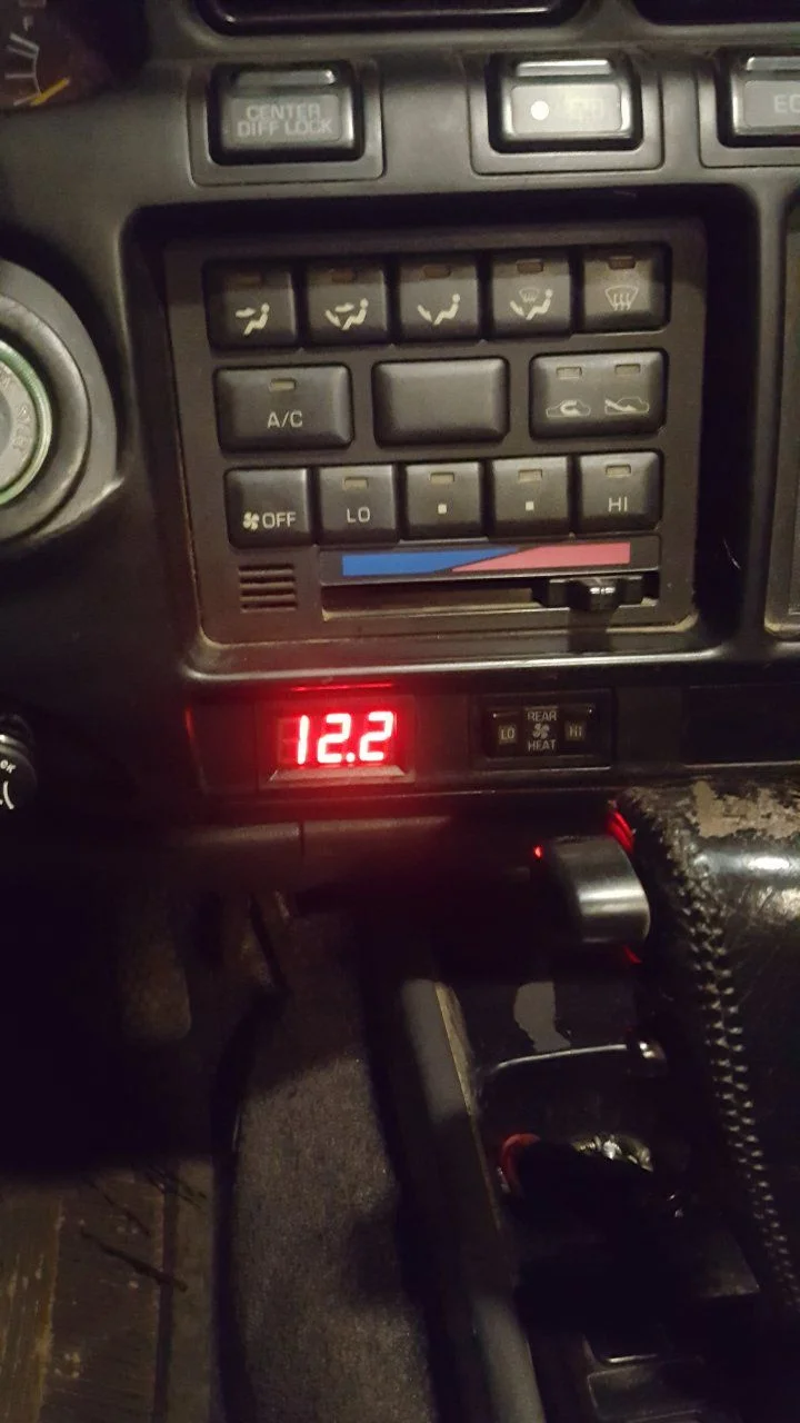

Did some electrical work. Which is generally not a good thing. However I have never had anything light on fire...yet.
Started by trimming the dash panel in my truck with a dremel to fit my gauge. Always use eye pro, because I dont. Also dont gouge it too far, because I did.
Then wire stuff together constant hot from the battery. I surprisingly fused it on the hot lead, which is really rare for me to actually do. The 80 is changing me, things are only marginally getting cobbled together...
After driving it, i would probably move my rear heater switch over to the left and punch out the center and left for voltage gauges. If I could. My steering wheel obscures the view when driving. When I toss a second battery in ill be using the other blank spot for a second gauge.
