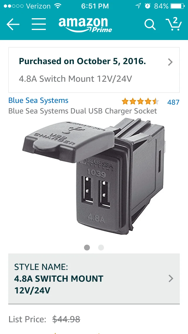

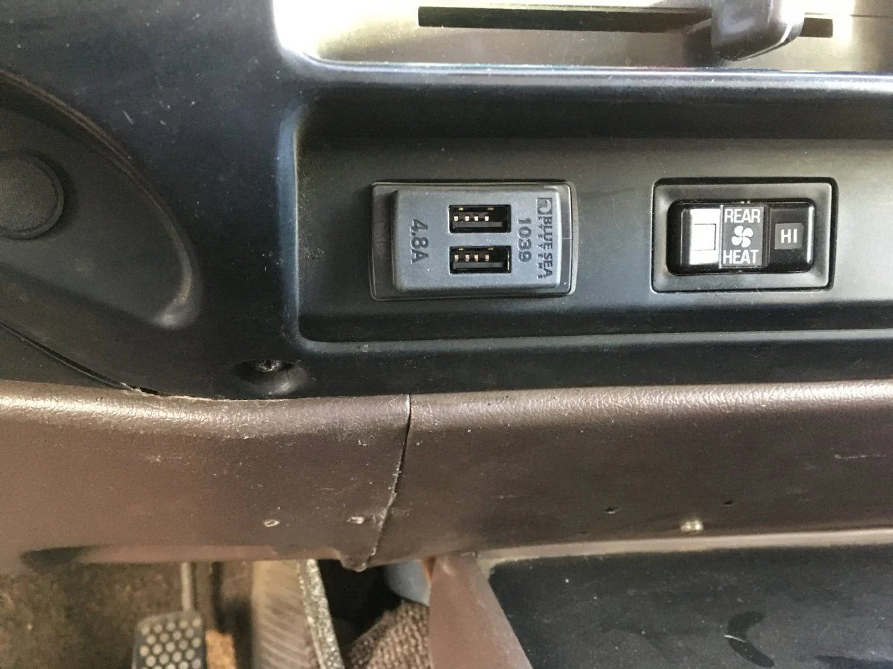

Gave the 92 a little love. Added the Blue Sea USB outlet.

I threw one in a couple weeks ago but haven't wired it up. What did you tie it into?

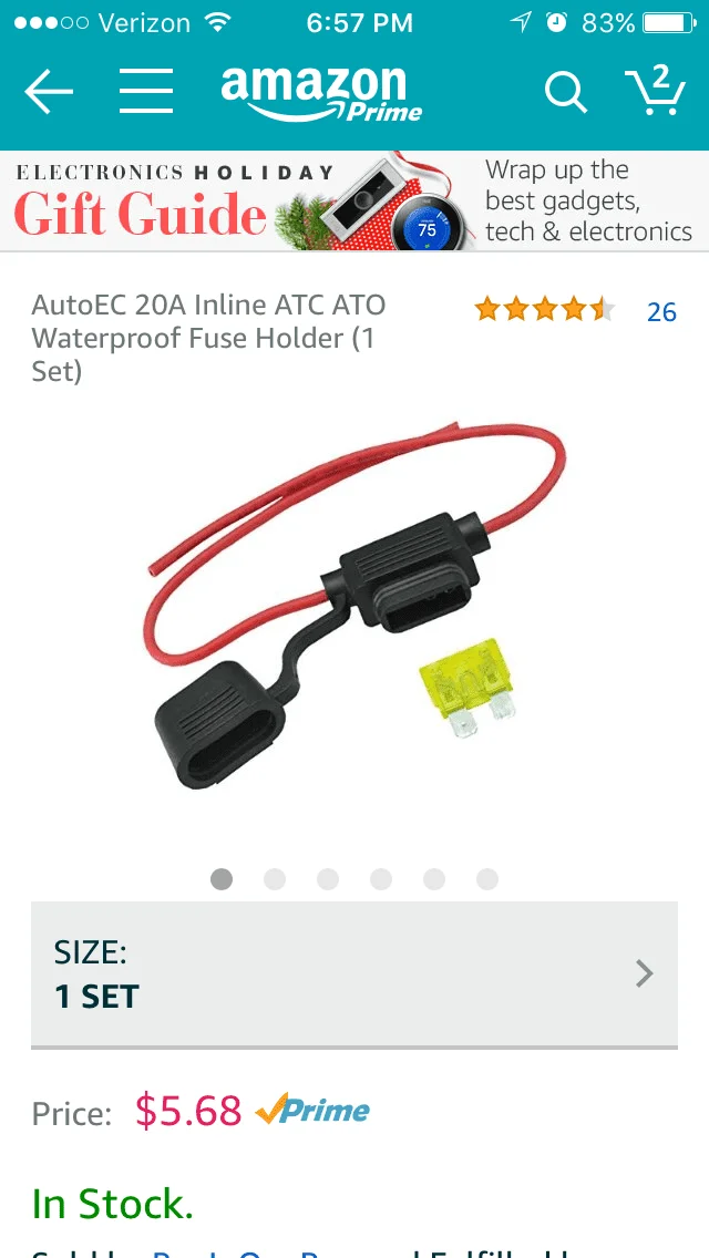

I ran t all the way to the battery and ran a 15 amp in line fuse on the positive wire. I wanted it to be always hot like on my 93. Otherwise you could probably splice in to the wiring for the cig lighter. I like them being independent of each other so I always have charging.

I almost tied mine into the cig lighter but decided against it. I'll follow your lead and go straight to the battery. :smokin:

They aren't cheap but they are worth it. I put one in my 93 back in June. Have had this one sitting, waiting to go in my 92 for a month. It takes 15-20 min to install.

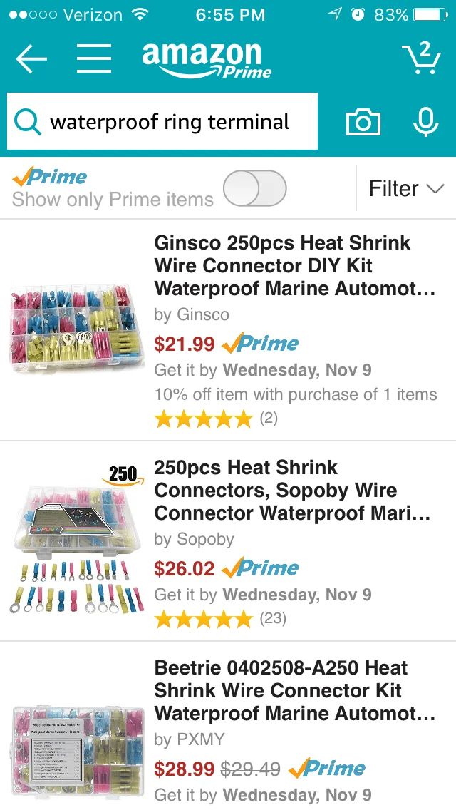

You need a file to shave down the opening a hair in the dash. That is about as difficult as it gets. Order inline fuse holder while you are at it and waterproof ring terminal connections. Good to have around.
I keep a few of the inline fuse holders laying around for when I decide to do something like this.
Put the fuse holder as close to the battery terminal as feasible. Heat shrink butt connector to the 12 ga positive wire. You can possibly just put the heat shrink ring terminal on the inline fuse holder. Run your wires up along the cowl and down through the rubber grommet on the fire wall on the driver side. If you don't have anything running through that grommet you'll have to poke a hole and feed your wires through it. It comes in to the cabin above the brake pedal. May have to move the insulation on the fire wall to see it. Then feed your wires behind the dash, below the steering column. There are two screws below the ignition. Take those out and lightly pull the bottom of the dash out. Stick your fingers behind the dash and pop the blank plate out. File down the bottom of the opening (you'll see a little lip). Test fit your USB plug until you get it shaved just enough to be a tight fit. Feed your wires through and plug them in to the back of the plug. Voila you have USB.

And I originally purchased the cheapo $12 plugs. They are crap. Spend the money and get the Blue Sea plug. It's worth it.
