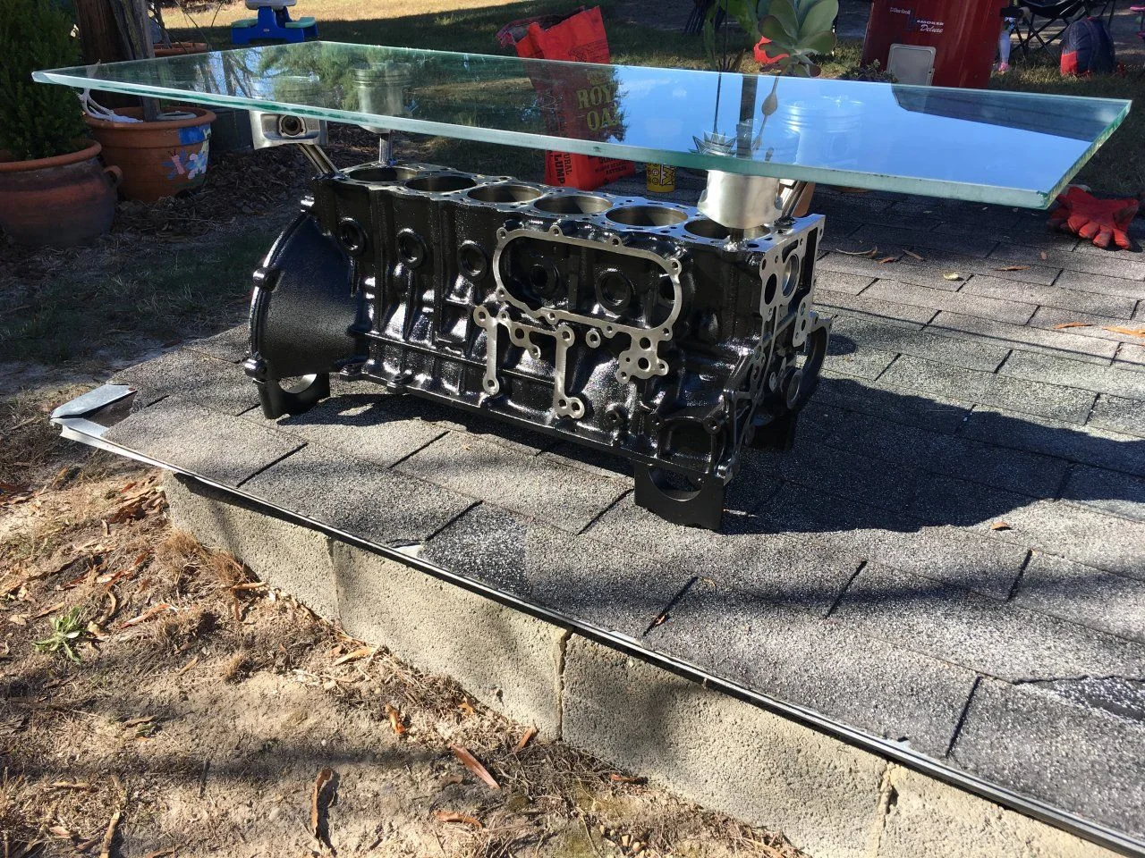

Pulled the shortblock, polished the front oil cover seal surface, and reinstalled in the living room :grinpimp::grinpimp::grinpimp:
img_8850-jpg.1347570
Yup. Its an 11400-66040 coffee table compliments of @Rice and his 1fz project.

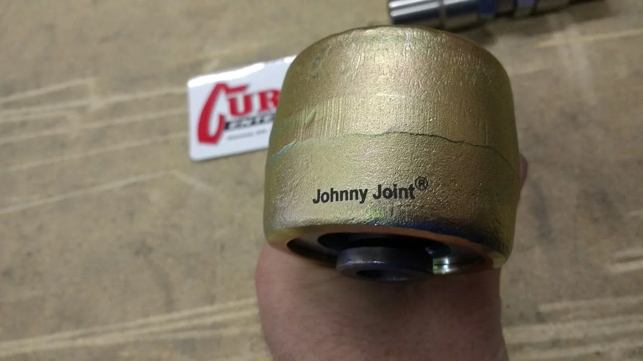

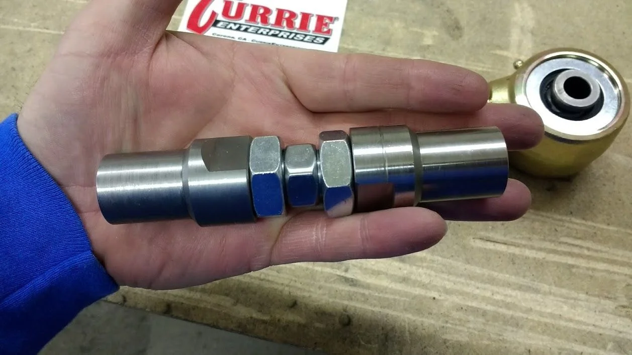

Got most of my parts in to make the new Trail Tailor adjustable upper and lower control arms..
Also, as of today I'm a Currie Enterprise dealer... let me know of anyone needs anything.
Uppers will be 1.5" x .250" DOM w/ CrMo tube adapters and 3/4-16 jack screw w/ greasable poly fixed ends
Lowers will be 1.75" x .250" DOM w/ 2.5" x 1"-14 Currie Johnny Joints, CrMo tube adapters w/greasable poly fixed ends
@Box Rocket will be getting a prototype set to install and review in the next couple weeks.
EDIT-- @AMMO had a good suggestion and I'll make another option for those that need/want this. ULTI-FLEX arm setup with a Johnny Joint and screw jack for UCAs..

View attachment 1349006 View attachment 1349007 View attachment 1349008 View attachment 1349009
Please don't take this the wrong way.
Your kit will be like the Metal Tec LCA, and a Slee UCA....?
What I'd like to see is a Johnny joint UCA with the screw jack.... Now that is an option no one has.
This would allow full adj of the UCA with out removing from the rig and give max articulation....
I've actually bent my Slee UCA's causing me to loose the ability to adjust them. I contribute that to torsional flex in the fixed joint beyond what the Polly busing could take. (I'm in the market for new UCA's)
Basically the Metal Tec LCA flex beyond the UCA with fixed joints. If you were to add a Johnny Joint to your upper (to match the lower) and keep the ability to adjust on the truck you would have a distinct advantage.

Unlike those two companies I will always build one off custom units... If you're interested, I'll make whatever you want.

Pricing for adjustable upper and lowers with heims? @AMMO 's idea is good, much stronger
Allows for more articulation and reduces binding. Pricing will be released once I get everything in and have built a set or two to figure in labor.

@AMMO can you point me to an example of the screw jack that you think is what you're after? I'd like to get my head wrapped around as many factors as I can before I do some testing on the prototypes.
