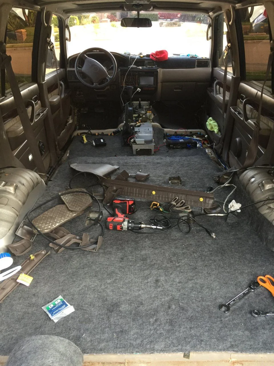

Finally finished the thermozite install got all 4 seats back in. Quick tip, make sure to cut out areas around second seat mounting area/feet or reinstalling them will be near impossible.
I haven't been following the details on this. What's the deal with the Thermozite? Primarily a heat barrier? Sound deadener? both? What is the benefit of the Thermozite over something like Dynamat?

Dynomat is a resonance deadener, it is good for that resonant tone from metal but it was not made for heat or other noise. Ideally you would add about 25-40% resonance deadener like Dynamat and then put a heat and noise barrier over it.
They work somewhat concurrently. Not necessarily an either or. Although the Thermozite has insulating properties to cut down noise. I went with just Thermozite because I a) wasn't going to spend the time and money putting in Dynamat b) don't mind a little noise in a 23 year old vehicle with 323k on it c) was more concerned about heat than noise d) I've never liked Dynamat.
Gotcha. Thanks.
Gotcha. Thanks.
Thermozite suppose to provide insolation and sound isolation, one side is aluminum foil so it suppose to reflect heat also. At the end of the day it's a sheet of aluminum with some fairly tight woven synthetic fibers. I hope it's as good as some people/review says.
I was on the freeway this morning the noise level is about the same but the 80 has way more noise from the side and top so just the bottom is probably not enough to make a big difference , I'm hoping that the center console doesn't get really hot on long drives.
