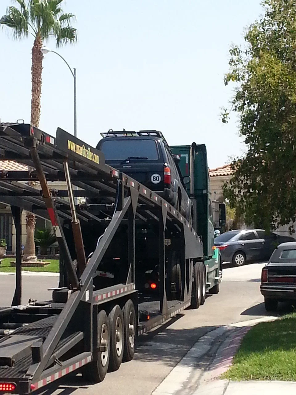

Received delivery! Filthy from the road but apparently no worse off from the trip than that.
Now if I could just find someone to deal with the DMV for me....
