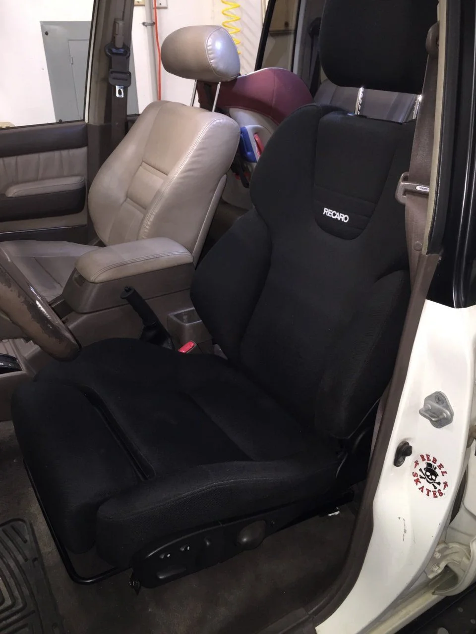

Installed a Recaro Style XL Topline that I scored off Craigslist. Heated and cooled seats in the 80 FTW!
