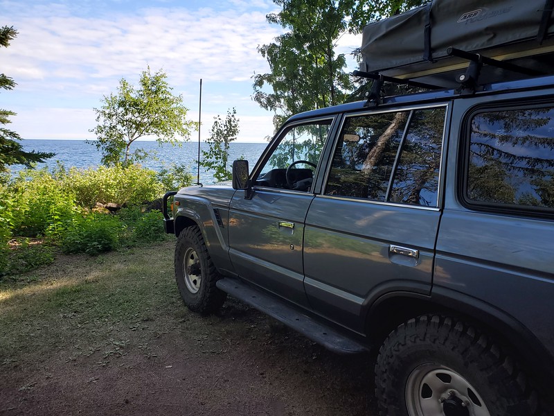

Did the first oil change on the new engine, transmission, transfercase and also did the differentials.
After that I swapped out my CB radio for a GMRS with a 3ft firestick antenna. Just waiting on the antenna mount bracket to show up and it will be all set.
Finally, I got my "air conditioning"... "installed"... along with a beaded seat cover to make the vinyl seats a bit more comfortable in the heat. (Good call on the seat cover @EasternYeti )
Hopefully these help with the drive through Nevada and Utah to SAS 5 next month.

May I ask what the difference between CB and GMRS radio are ?? Would really like to know. 👍

More or less it operates at a higher power output and a different frequency than CB, but still uses fixed channels like a CB. There is a big difference in clarity, sorta like comparing AM and FM radio. I don't see the point of spending the time to learn about and get certified for HAM for what I use the radios for, so this is a good compromise between power and simplicity in my opinion.
I'm sure someone who knows more about radios will reply if I omitted anything.
