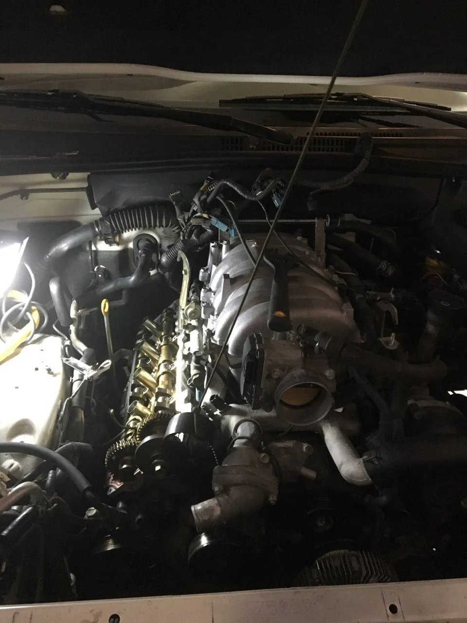

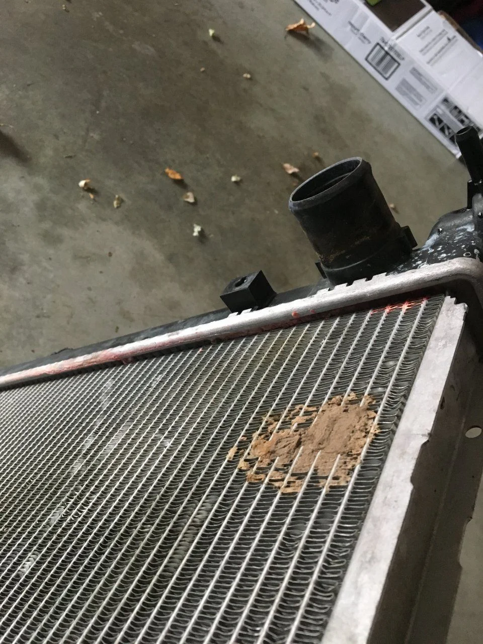

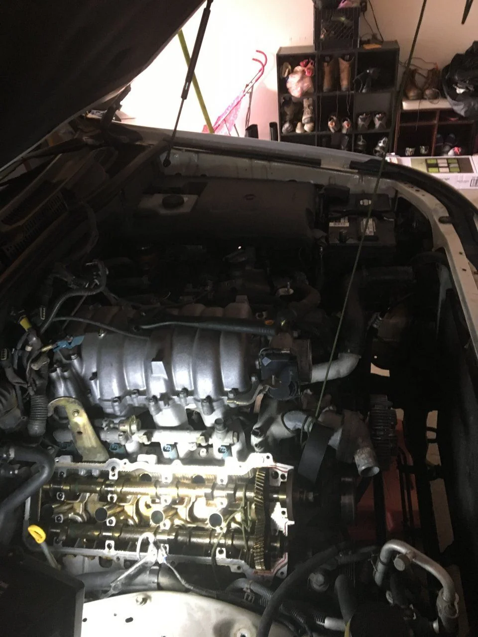

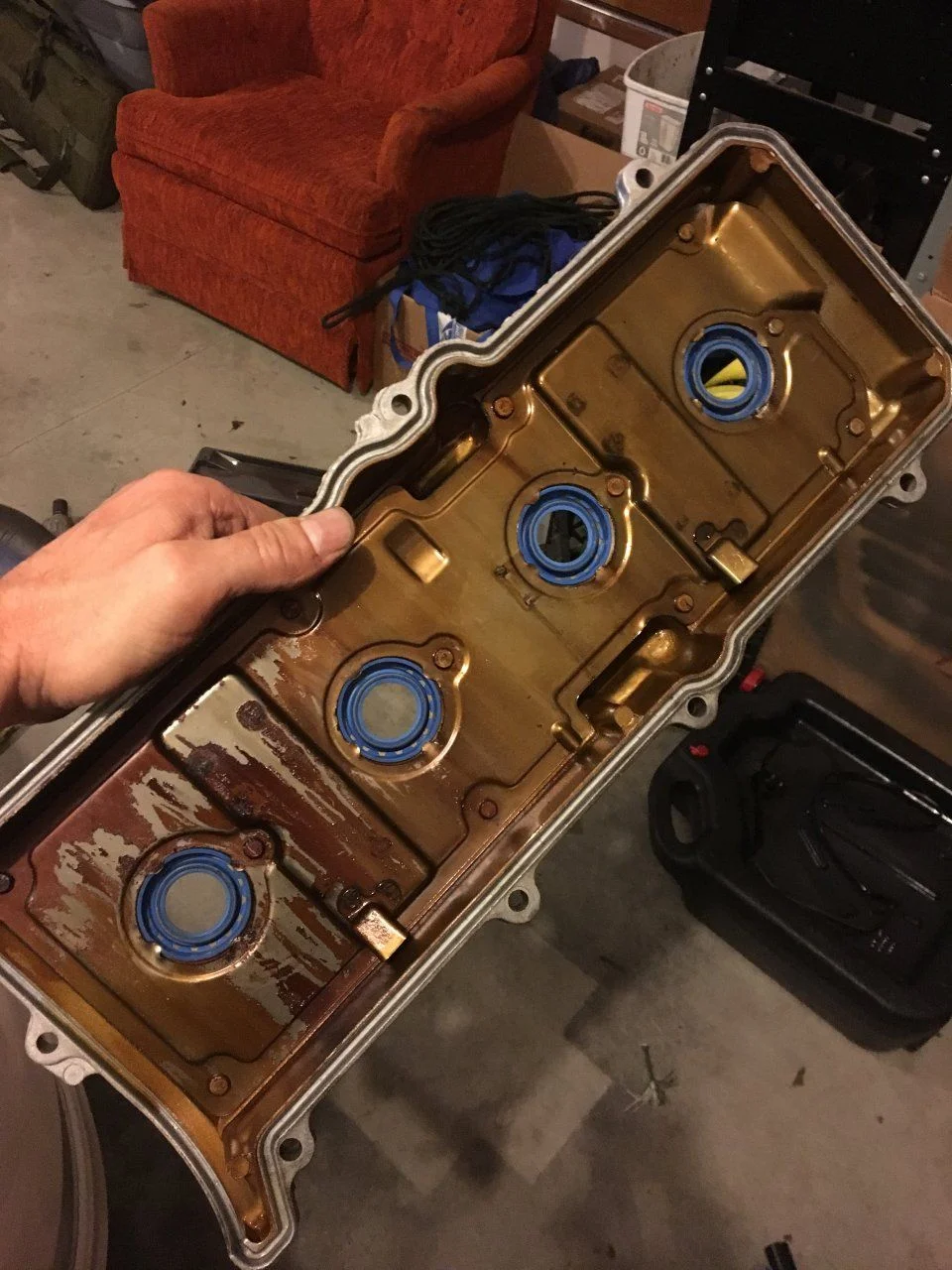

On a different not, what I did today was remove the radiator for a new denso and started on the valve stem seal replacement. Not too difficult, VERY time consuming and tedious. The radiator was leaking intermittently and I could see the remnants of coolant on the seam on the metal and plastic. Also, a pic of the inside of the valve cover. Not too shabby for a rig with 210k on the ticker. So far I got one cylinder done (4 seals). I hope to get this bank done and buttoned up tom and get at least one cylinder done on the DS tom.

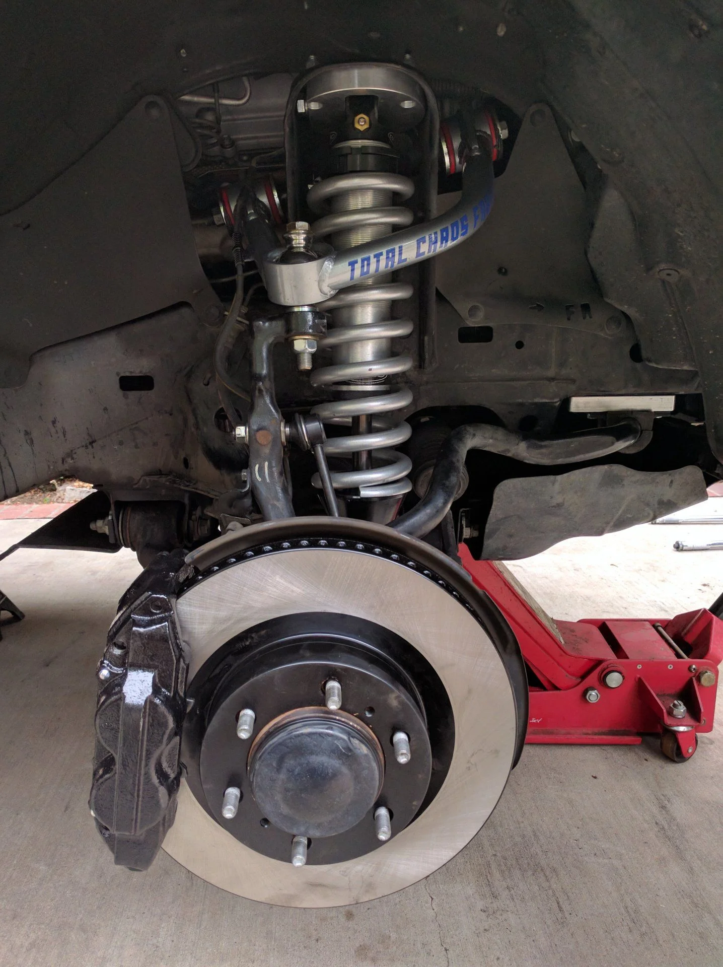

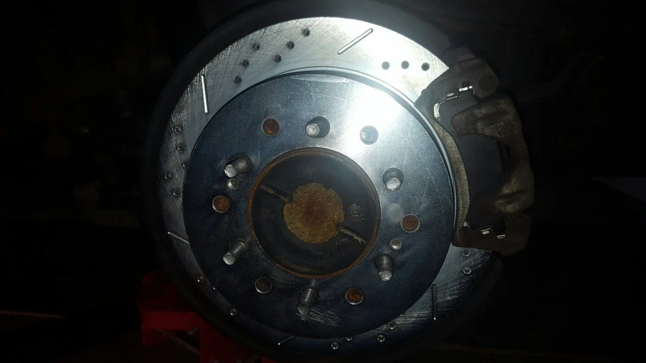

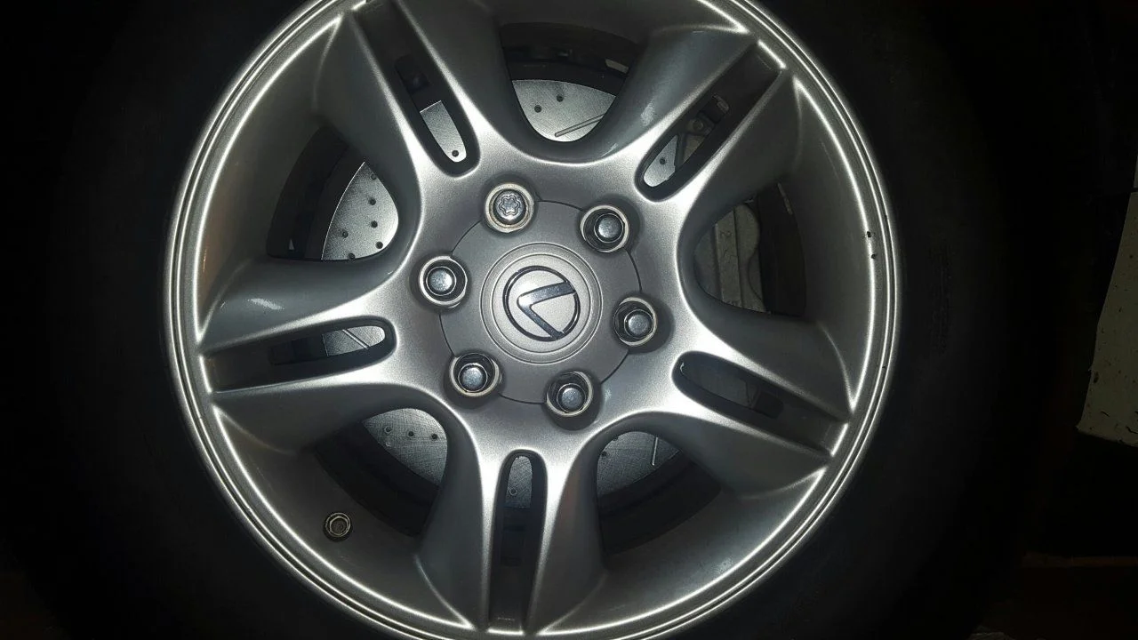

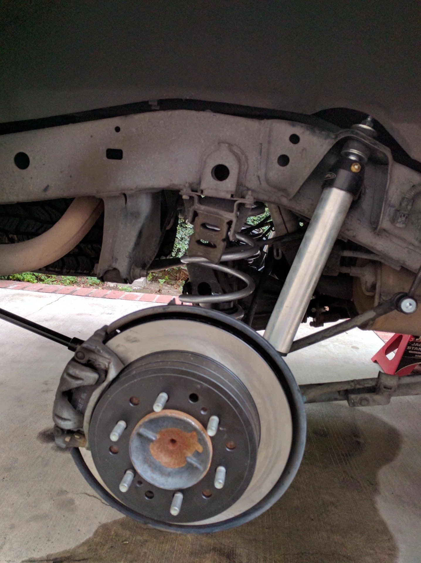

I received the PowerStop Z23 front+rear brake kit, part#K2422, from Amazon late last week and installed yesterday. My initial impressions are positive:
  • The kit included everything I would expect: replacement springs/shims, rubber boots, and lubricant.
  • The rotors are nicely coated on nearly all surfaces. From my first impression, I would not expect to see rust on the rotors for a long time.
  • Each rotor has some milling in one area of the circumference, showing that there was an effort to balance each rotor.
  • Everything fit well. Other than a few stuck bolts that I experienced, total time to install should be around 3 hours.
  • I followed the break-in procedure and noticed that there was an obvious "hot odor" during the first steps, which the instructions say is normal. No unusual noises were heard during break-in and brakes felt as responsive as I would normally expect.
I will try to post some longer-term impressions later on. Here are a few shots of the installed parts: Front rotor installed, rear rotor during install, and milling/balancing on one of the rear rotors.

@Joeshark , @Springs505 , @GXO - thx for the feedback against the PowerStops. Are these bigger than stock? Any improved feel over stock (which feels non-linear and soft to me)? Anyone know of any comparos with these and Tundra bigger rotors/pads?
I did a similar upgrade on my '92 FJ80 a couple years ago (93+ rotors, 100-series pads). Huge improvement, hoping the same is possible here.
Rotors do absolutely nothing to make your truck stop better, a blank rotor is all you need. Pads (compound) and fluid are what you modify if you want your brakes to actually perform 'better'.

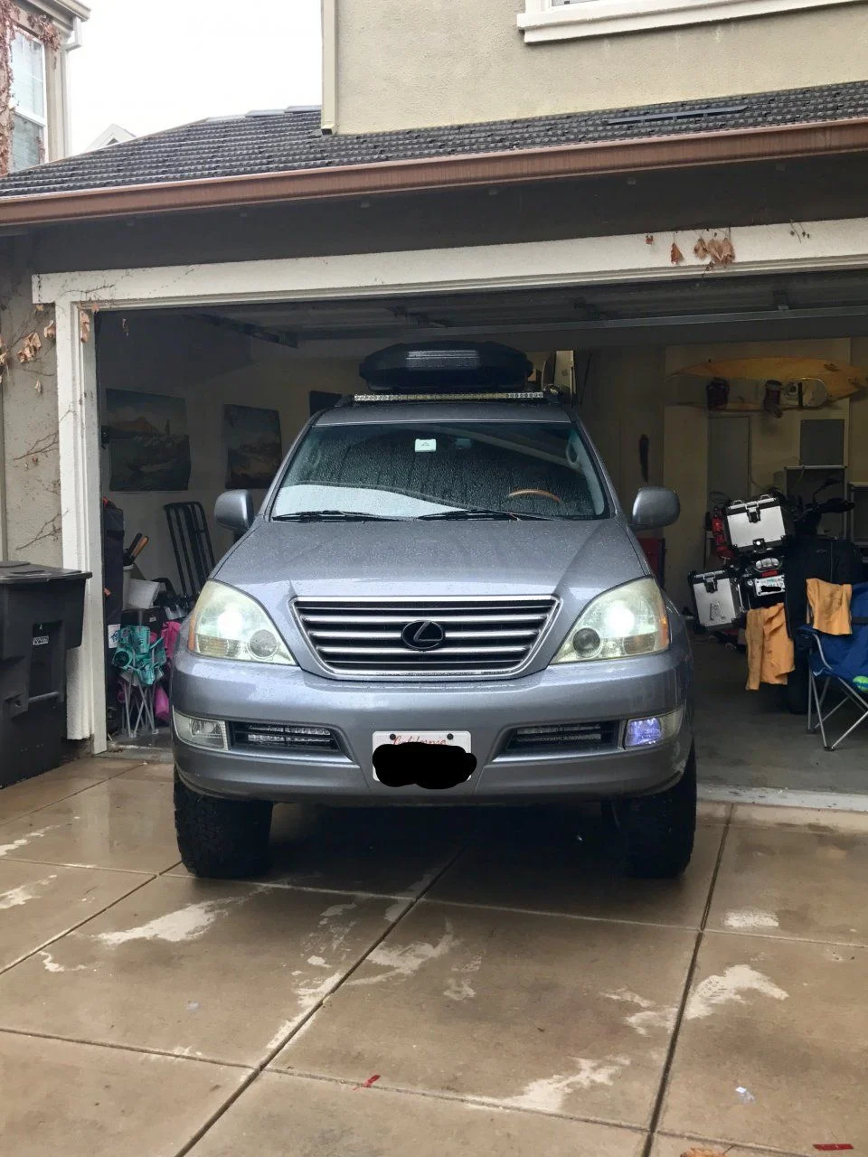

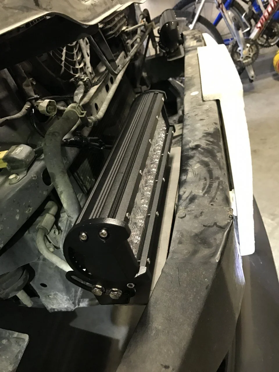

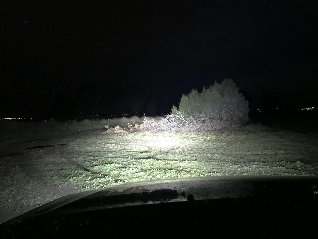

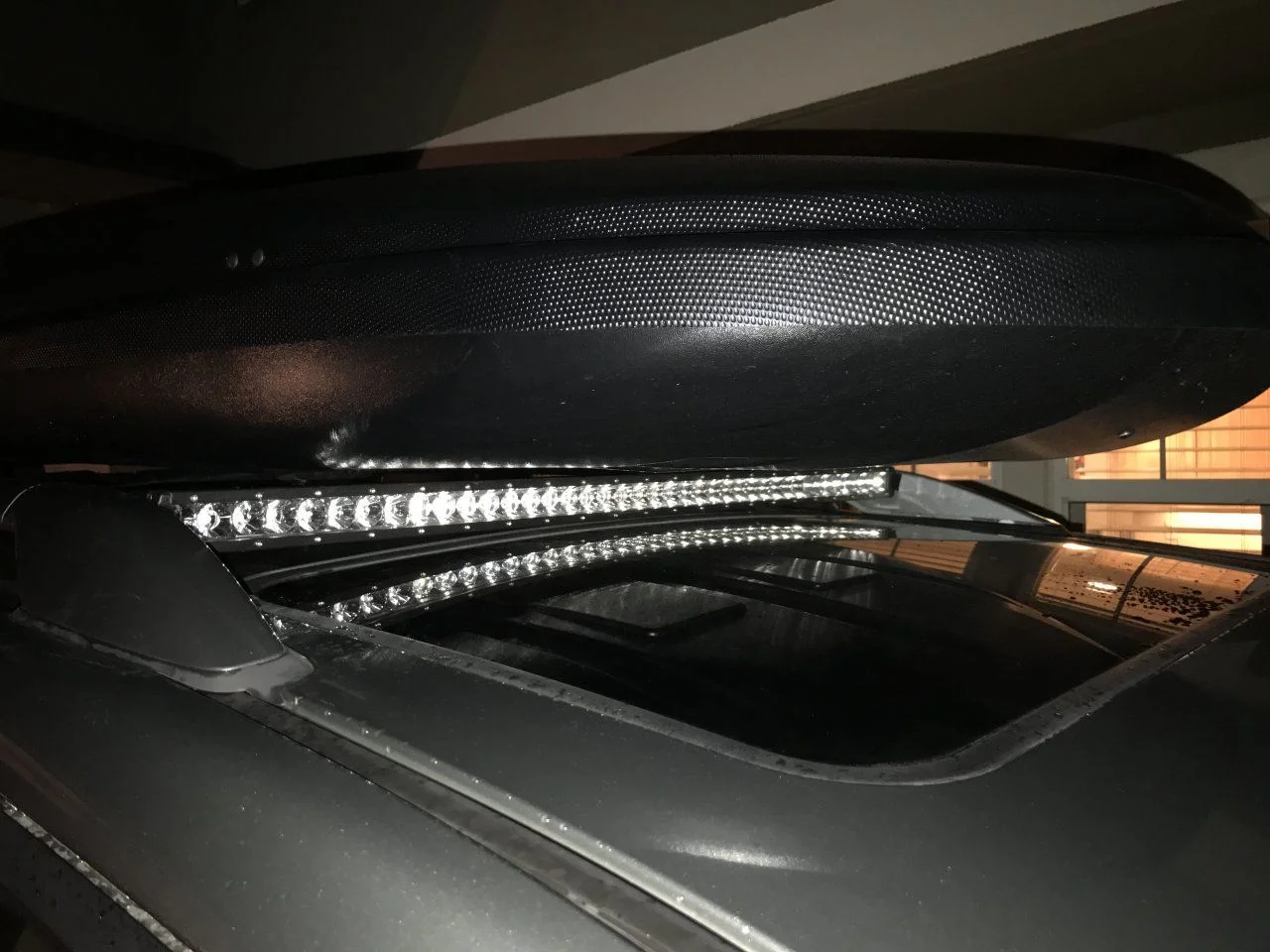

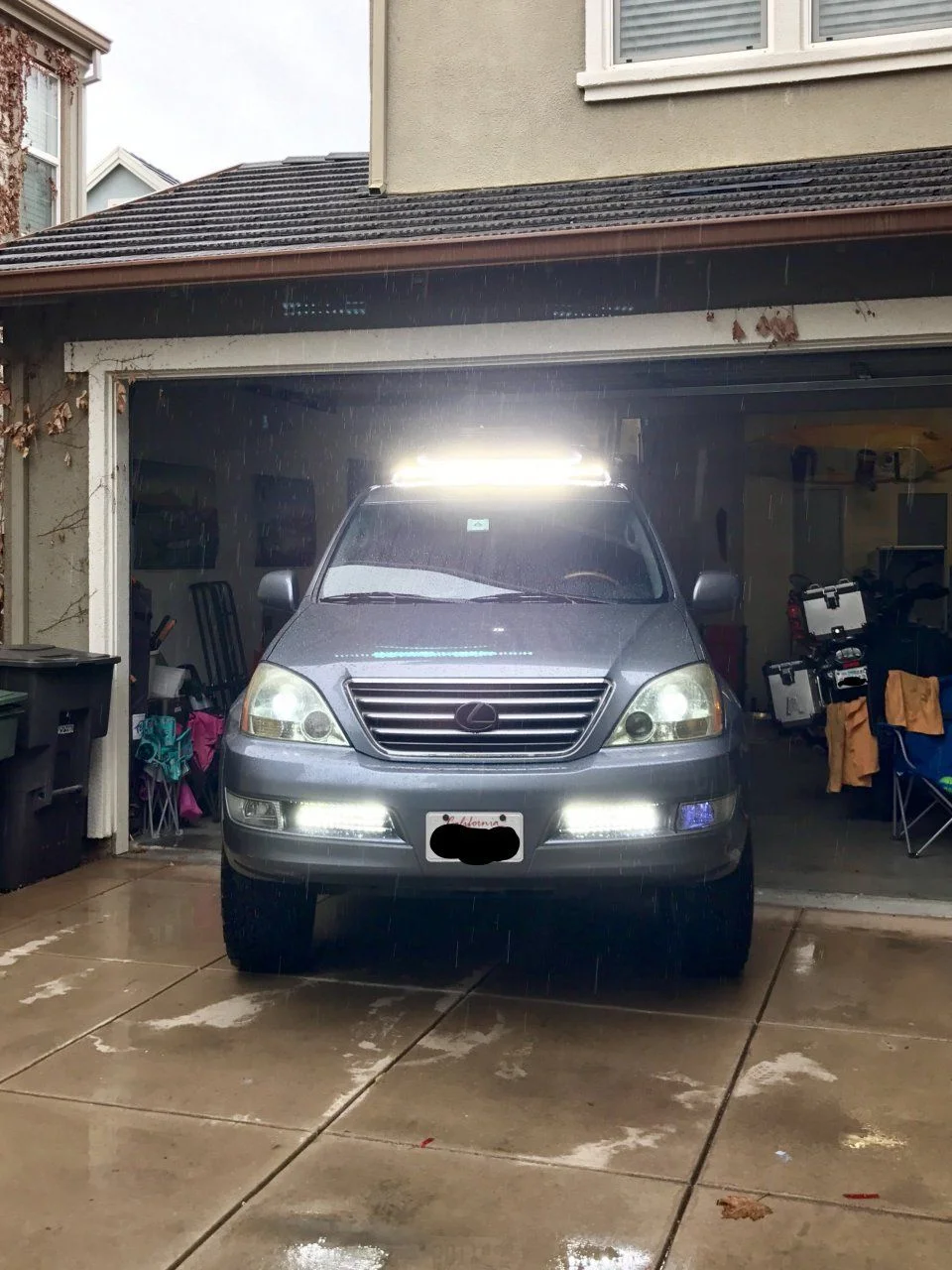

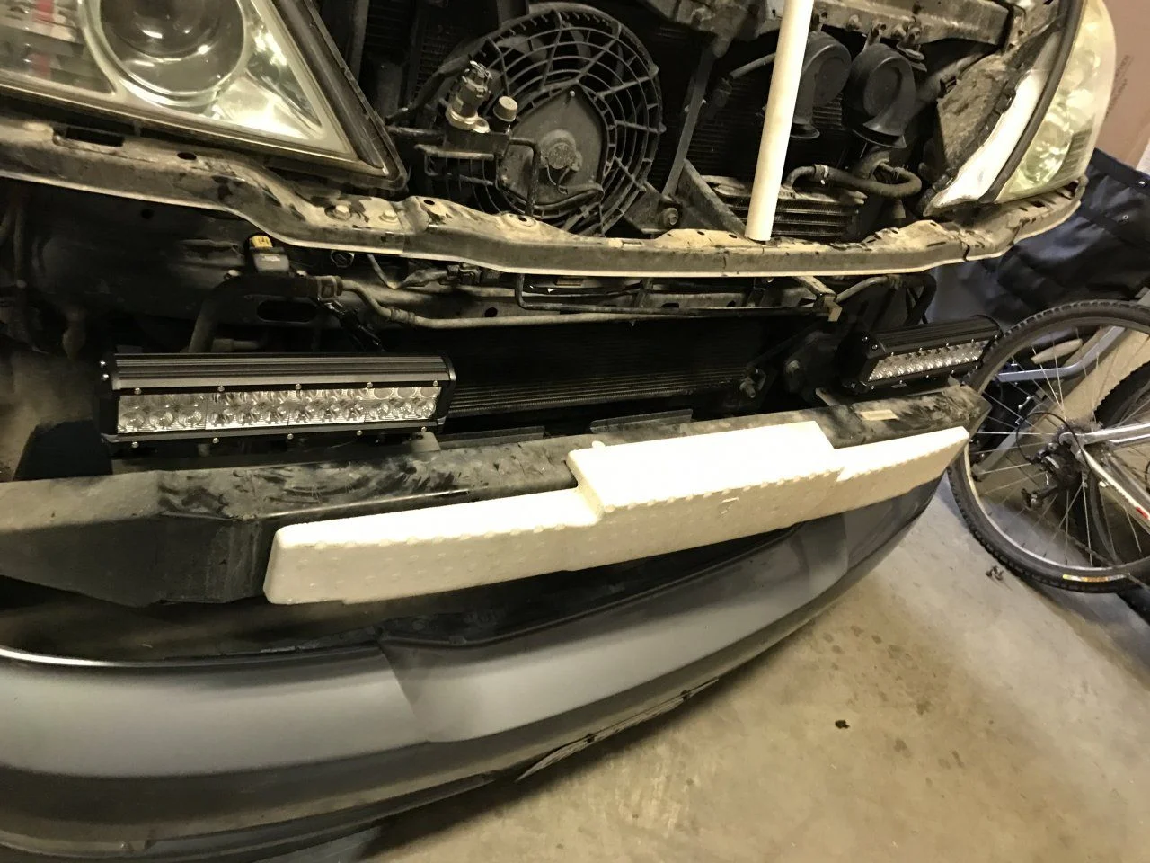

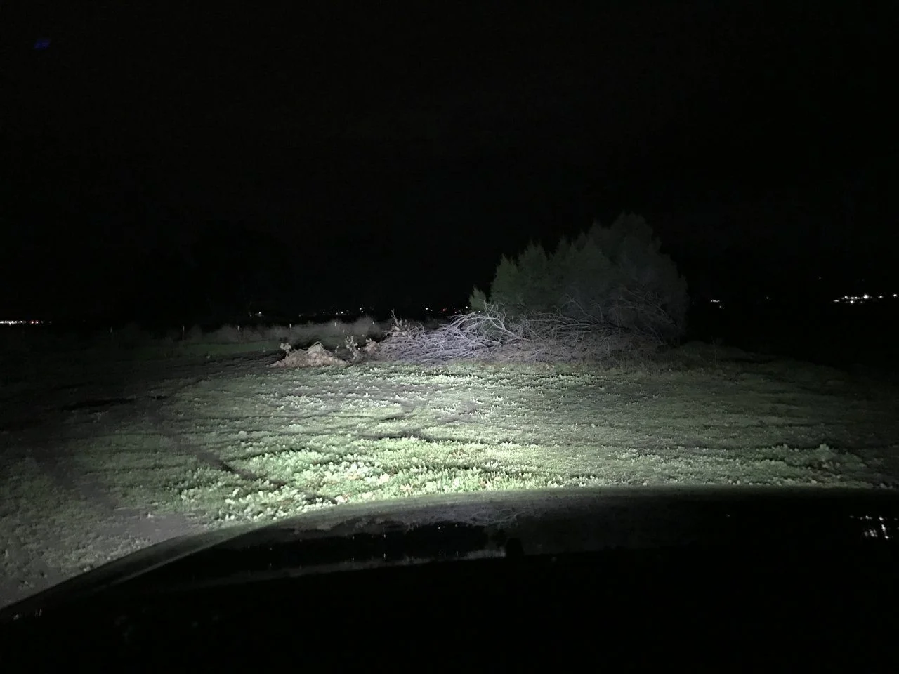

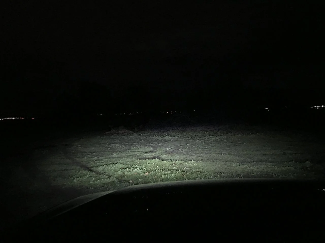

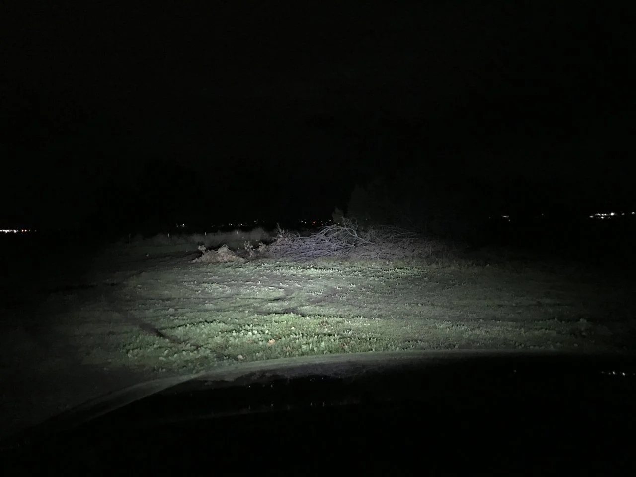

Installed some light bars onto the GX this weekend. A 40" up top and 2 x 12" next to the fogs. The idea for the top bar install came from mudder Wildyoats who also kindly sold me some custom brackets. Didn't end up using his brackets on account of my light bar being slightly too long, but they worked perfectly for the lower light bar install. Switches worked out well too after some careful dremeling. Thx everyone for the inspiration!
I like the stealth mounting in the bumper, and are you using the factory cross bars to mount the 40" bar?
Which roof box is that.....it looks MASSIVE!
