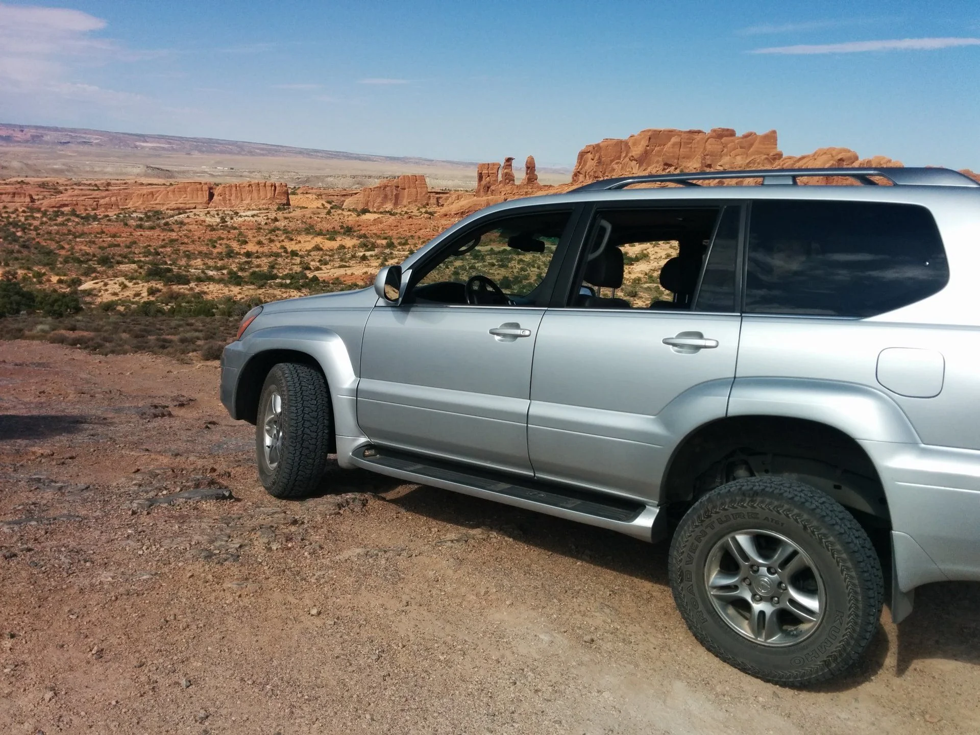

stretched her legs out for a test run up Tower Arch trail in Arches NP today...

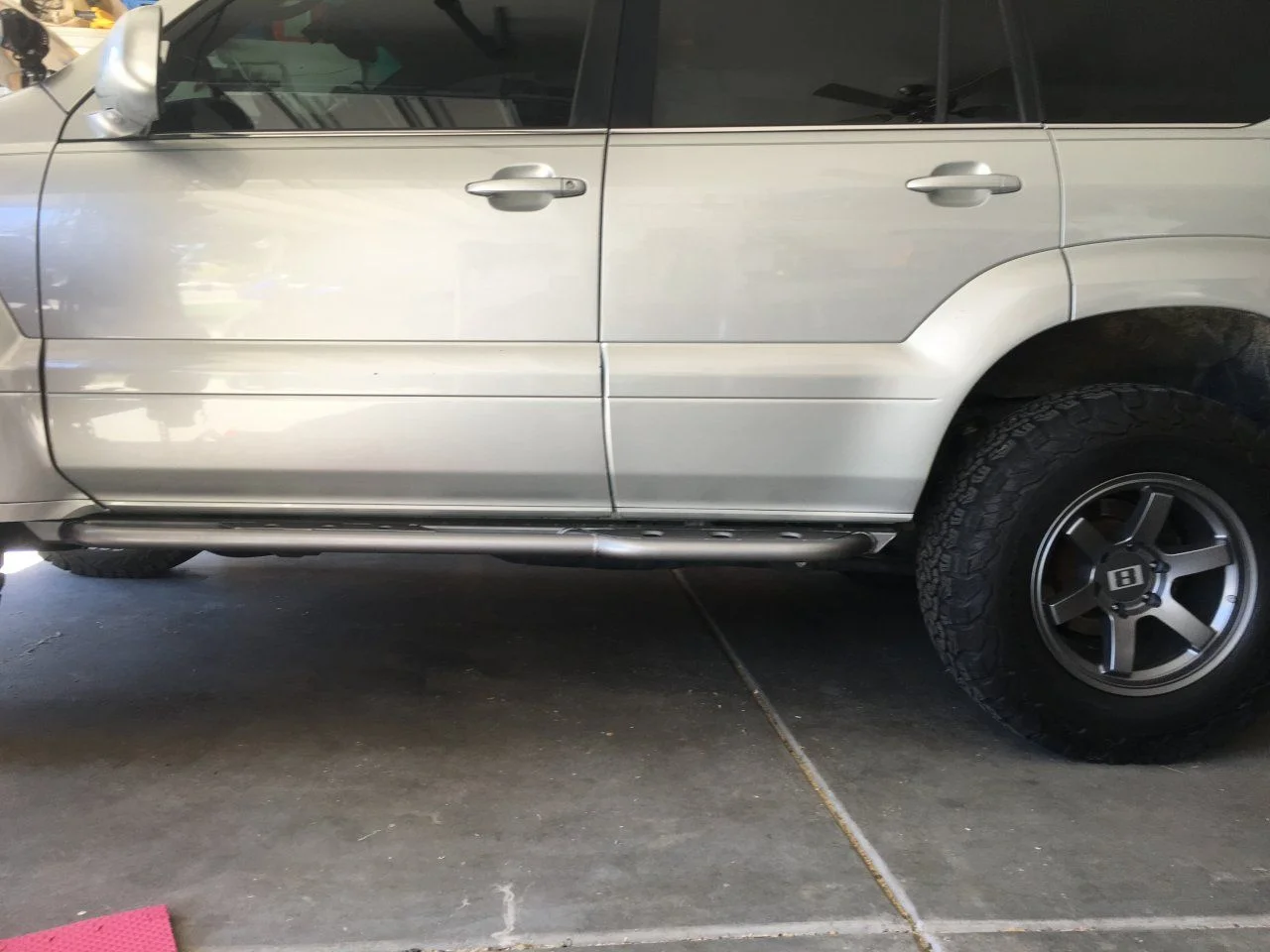

Ended up partially welding mine. screwing around with the crush rivets and drilling the frame was taking to long. Took half the time to just weld them on. I used the U-bolts on the backs of them, the 2 pre-threaded front bolts, and one big ass bolt through the middle foot, and welded the front feet and middle foot.

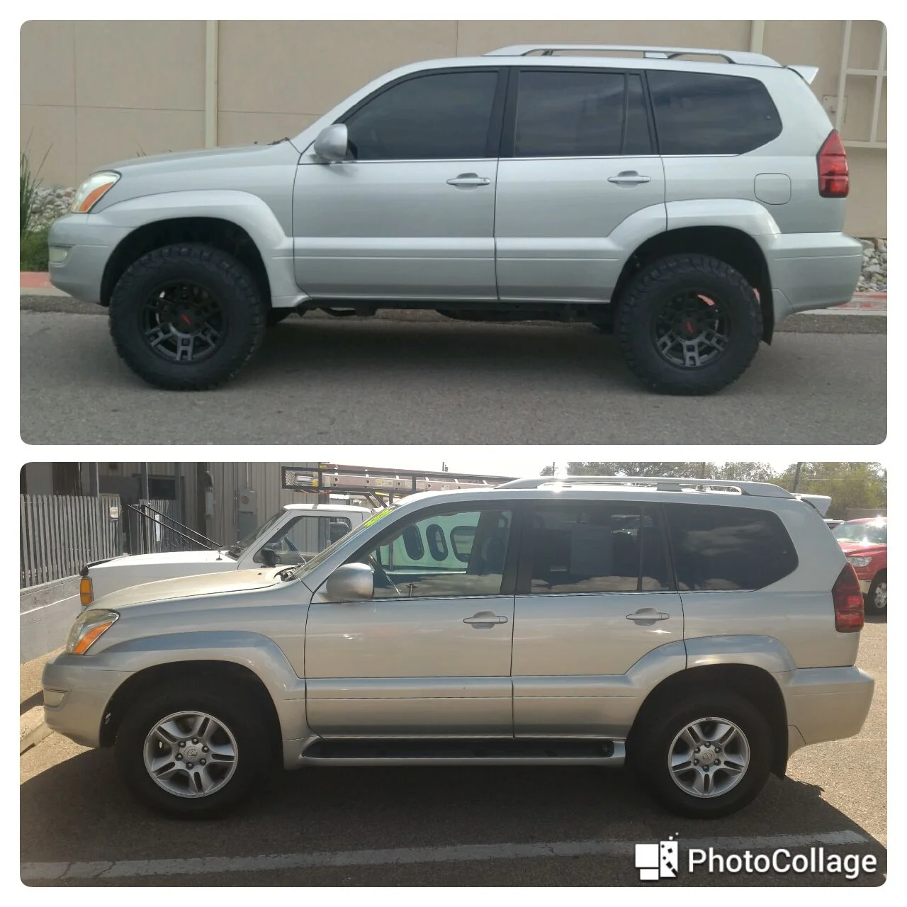

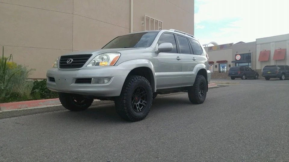

I installed the suspension/lift today. Everything went pretty smooth other than the factory front coil overs being stuck in place. Took about 45 min with a sledge hammer and BF screwdriver to pop them out. I went with old man emu 885/N140S in front and 895/60004 in back. Tires are 275/70/17 ko2's on fn fx pro wheels. Here are a few pics right after I was done, I will get some better ones after I clean her up.

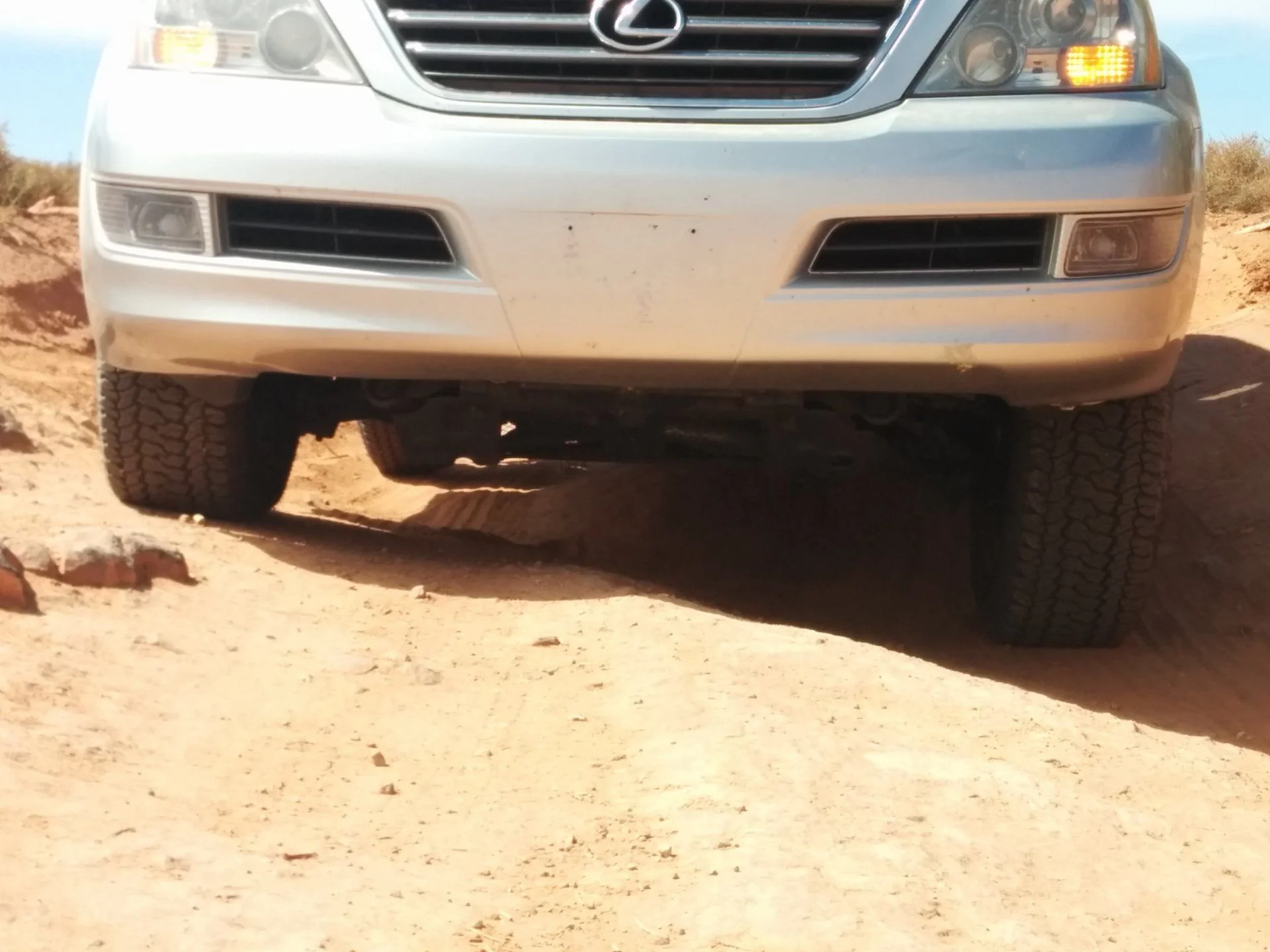

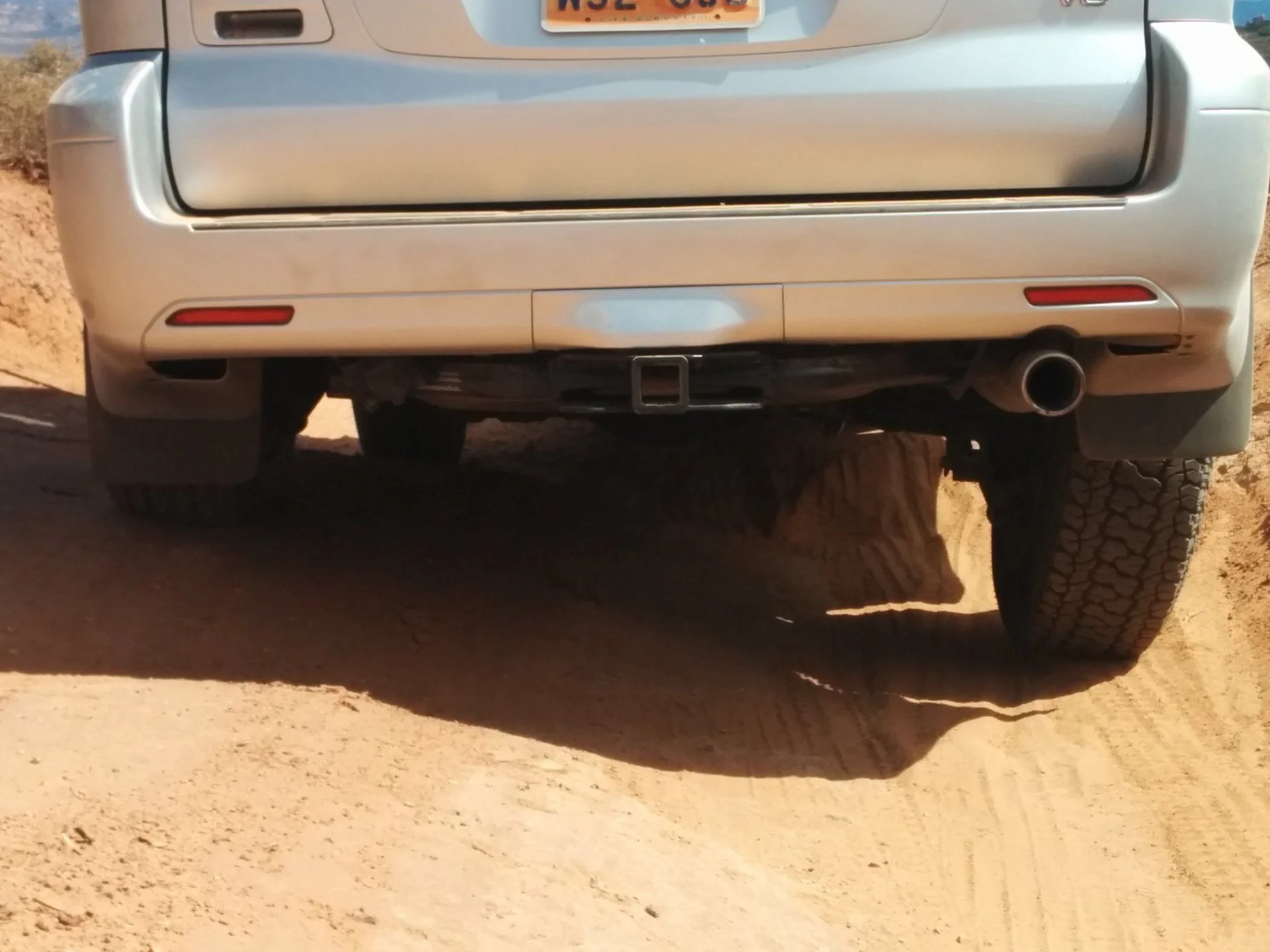

full
full
Articulation awesomeness!
