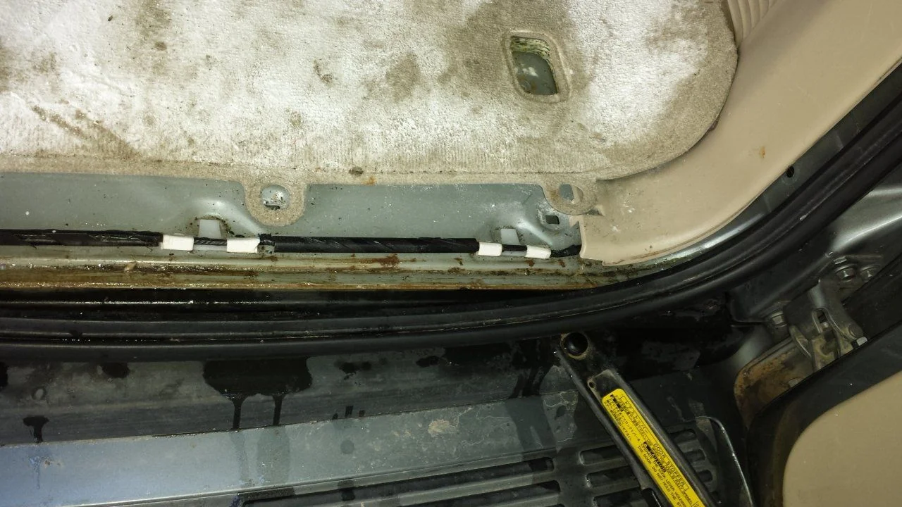

Well my wetness issue does not seem to be a sunroof drain as they were surprisingly clear. Looks like water is trailing down the inside of the glass on the back door after a rain today. I pulled the door gasket and it was packed full of clay/mud on the bottom and was retaining water bad enough to start rusting the body seam. I am not confident this is 100% the issue but it's a start.

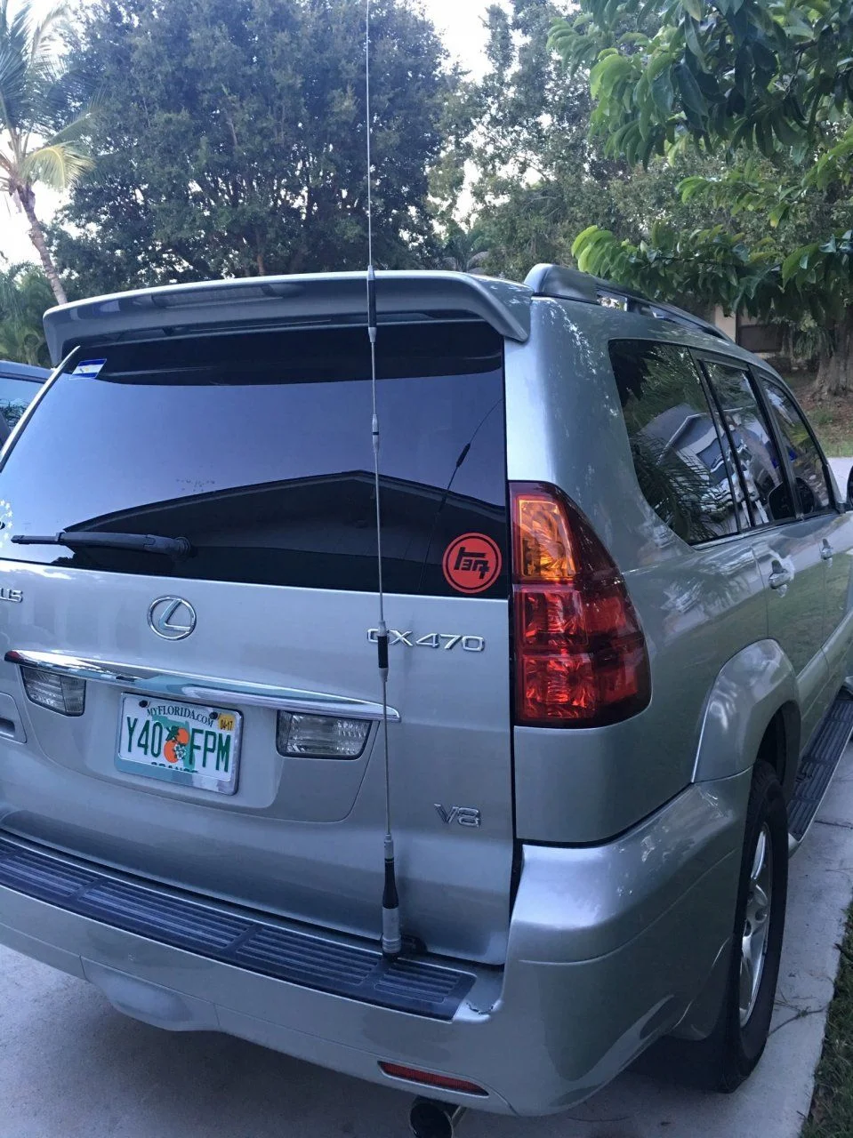

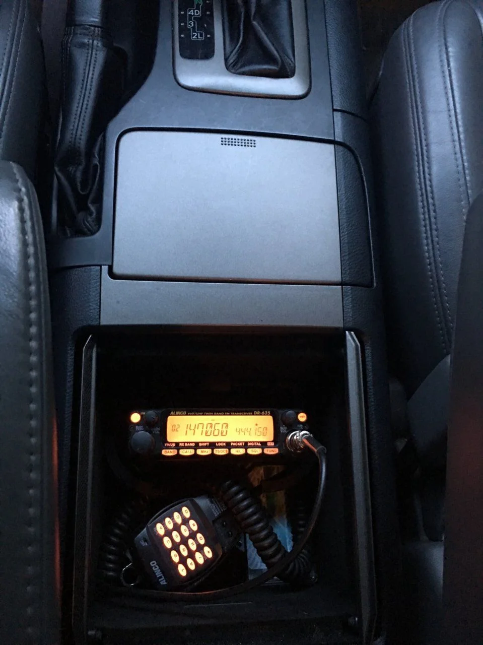

Installed a uhf/vhf ham radio. That is just the face plate in the console. The actual radio is under the driver's seat. I used a comet "no holes" bolt on mount for the antenna. I have a HF to put in there also but I'm not sure if I want to put on another antenna (especially a hf one).
Confirmed the leak is definitely from the weatherstrip door seal. My wife drenched the truck with the hose while I was in the back, I could see where the water flows down the inside of the weatherstrip and pools in the back corner of the truck (where the carpet was wet). I am contemplating trying to clean out the weatherstrip and use 3M adhesive to attach it or buy a new one and 3M that one. Mine is pretty nasty on that inside of the lip.

I use a magnetic antenna for the CB since I mostly use HAM and I can use CB if I really have to go back to the stone ages. But still need to get everything set up on this new rig.

Nice install on the inside.
Your antenna is too low and you are going to lose range big time. Conskder a good magmount on roof.
