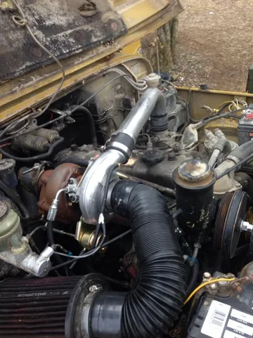

Notice anything clean and shiny.
Nice Hunter. Had much time to tune it yet, or just getting it bolted on?
Man a turbo and a locker, that think should walk on. Now you just need 4 matching tires and you'll be set. :hillbilly:

Yes it's a world of difference. I can run 65 and stay there the whole time. It's been on for almost a week and I thinks it's tuned in pretty good. It seems to be efficient and much quieter than before ha ha. As got the tires I do have one for every occasion.
