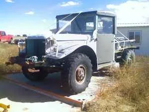

anyone know what axles these might be? I know it is hard to tell but could they be rockwells?
yep old power wagon. 1952 M37. Could they be portals? guy only wants $500 for the whole thing. gearing is 5.38 this could be perfect. measured my wheel well. I could fit 42's!!!
1952 m-37
image.php
Doesn't look to be portal, certainly not the famous 2-1/2
ton rockwells found under the duce and half. Way cool truck though, way cool $ does it run?? I found this pic on one of the military vehicle collector web sites.
James
TLCA # 4219:beer:
Same as I discovered. bummer. it does not run. no engine, trans, or wheels. some form of dodge axles. military grade though. it's on craigslist if anyone wants a cool project. I think I'll pass.
It's too bad those axles are probably hard to find parts for. I think it would be awesome to have some big, crazy, off the wall axles like that just for people to try and guess what they are. Try and convince them they are some long lost toyota 1 ton axle from japan.......lol
surprisingly they are actually easy to find parts for. Not sure what their actual strength is. (will they hold up to the abuse of rockcrawling) I know the aftermarket axle shafts are 1 1/8 inch in diam. 10 spline though.
