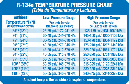

9. Once you are getting close to the approx charge weight, close the low side valve and let it sit for 1 minute before checking pressures. Refer to an R134a temp/pressure chart like the one below. The ambient temp is the air temp in front of the condensor for the high side and the temp at the cowl for the low side. The cowl will always be a few degrees warmer due to engine bay heat.

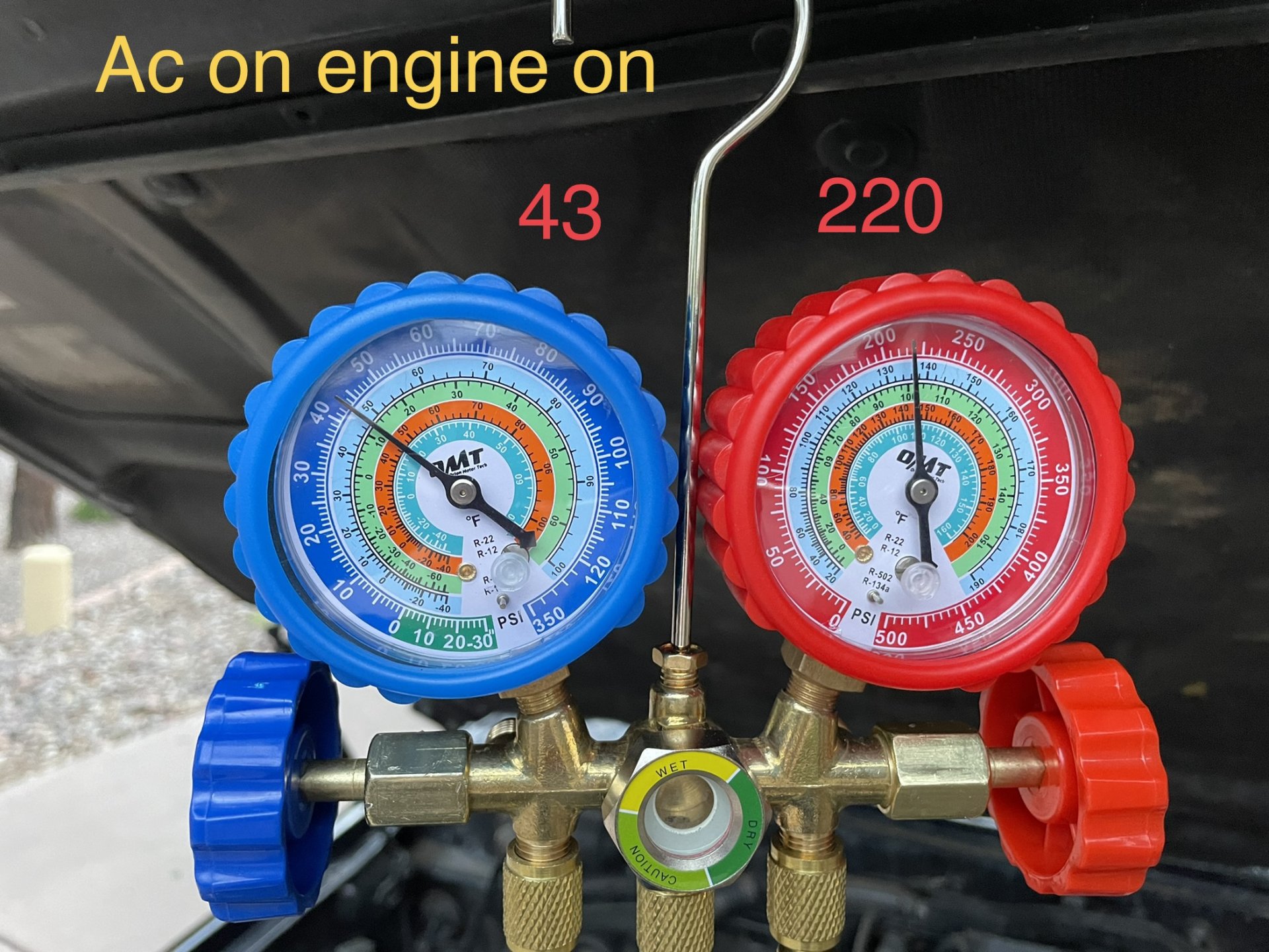

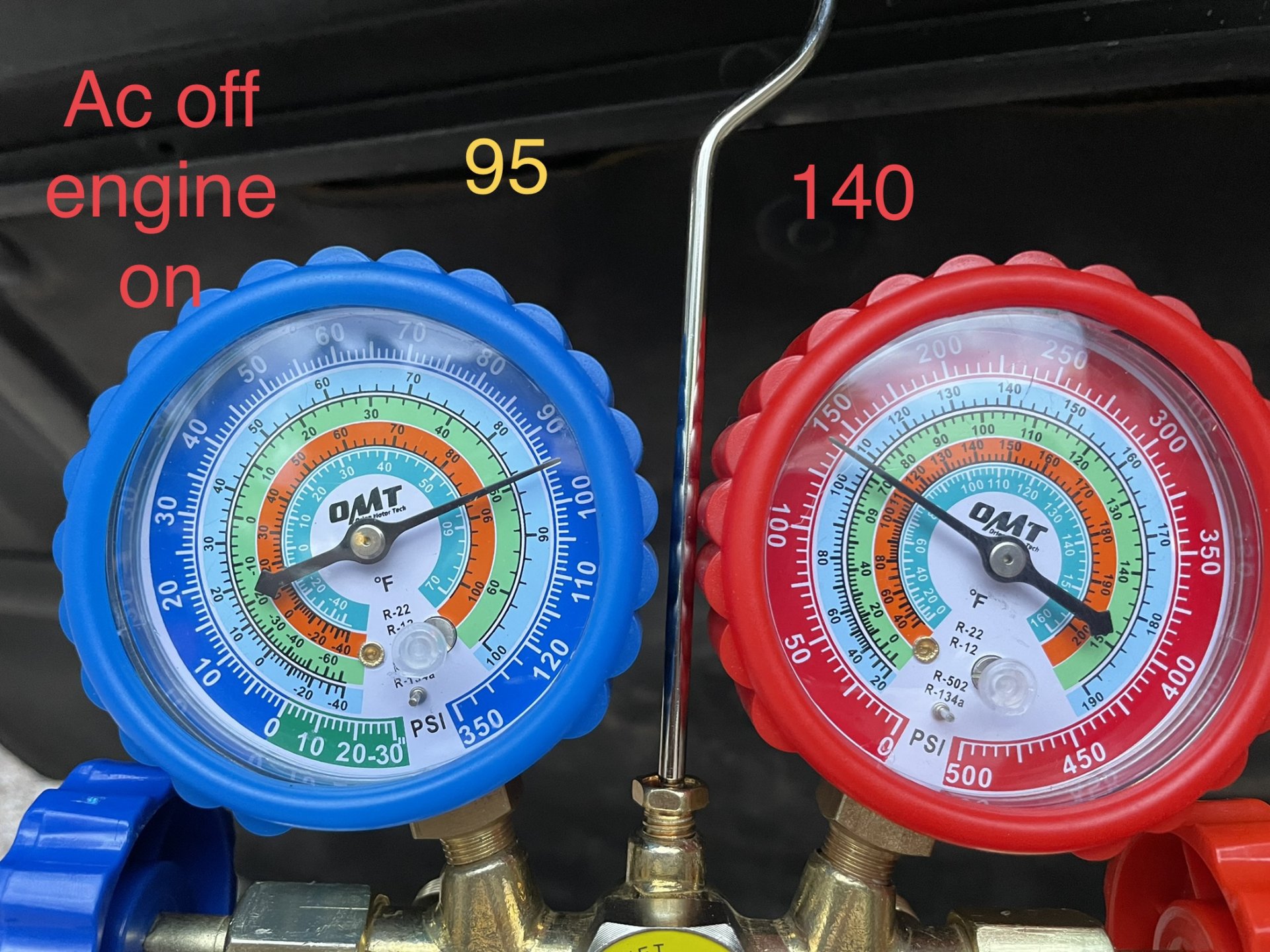

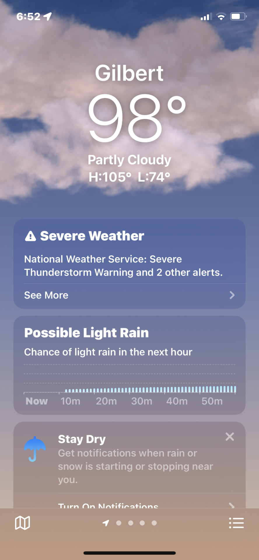

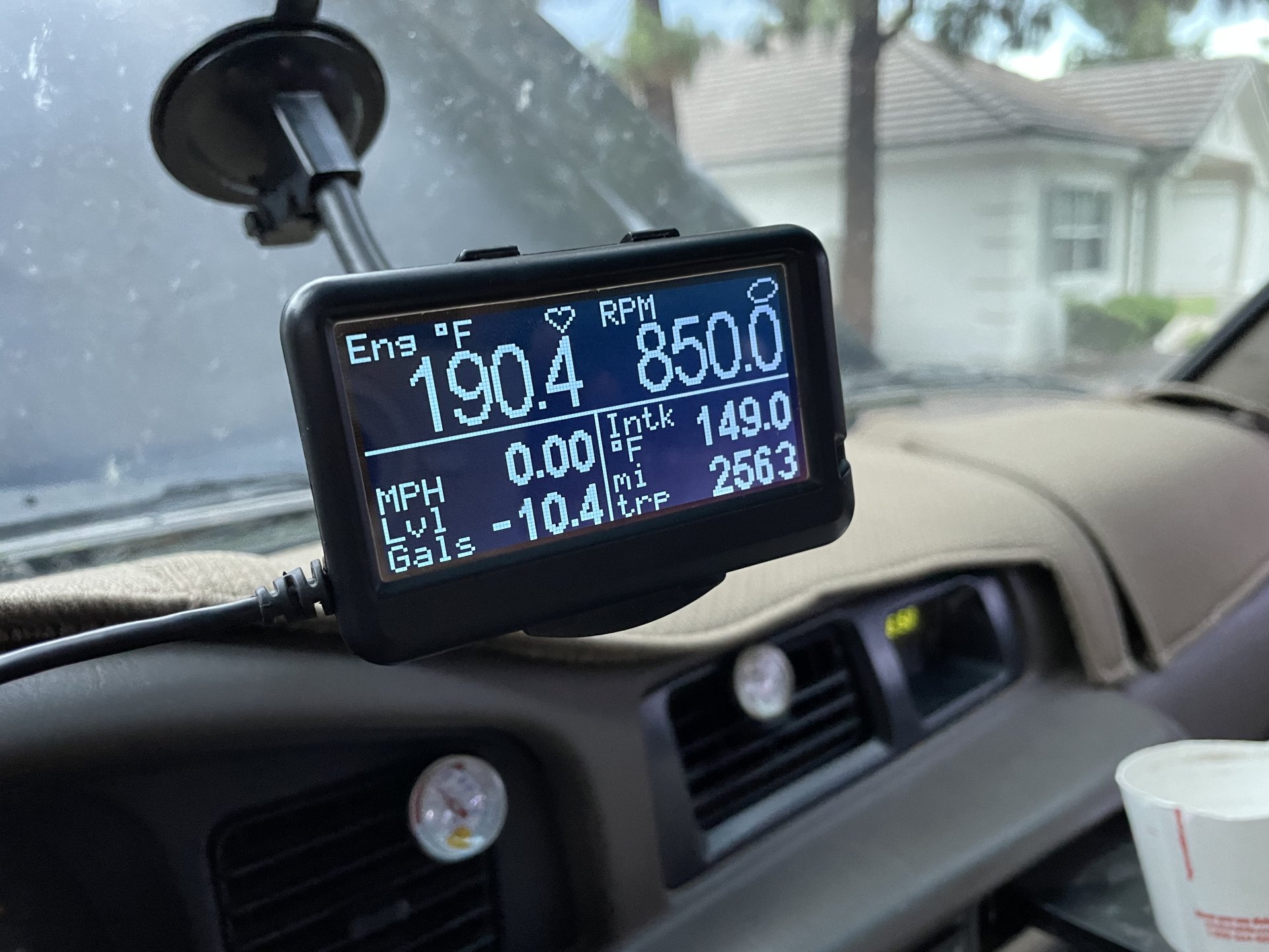

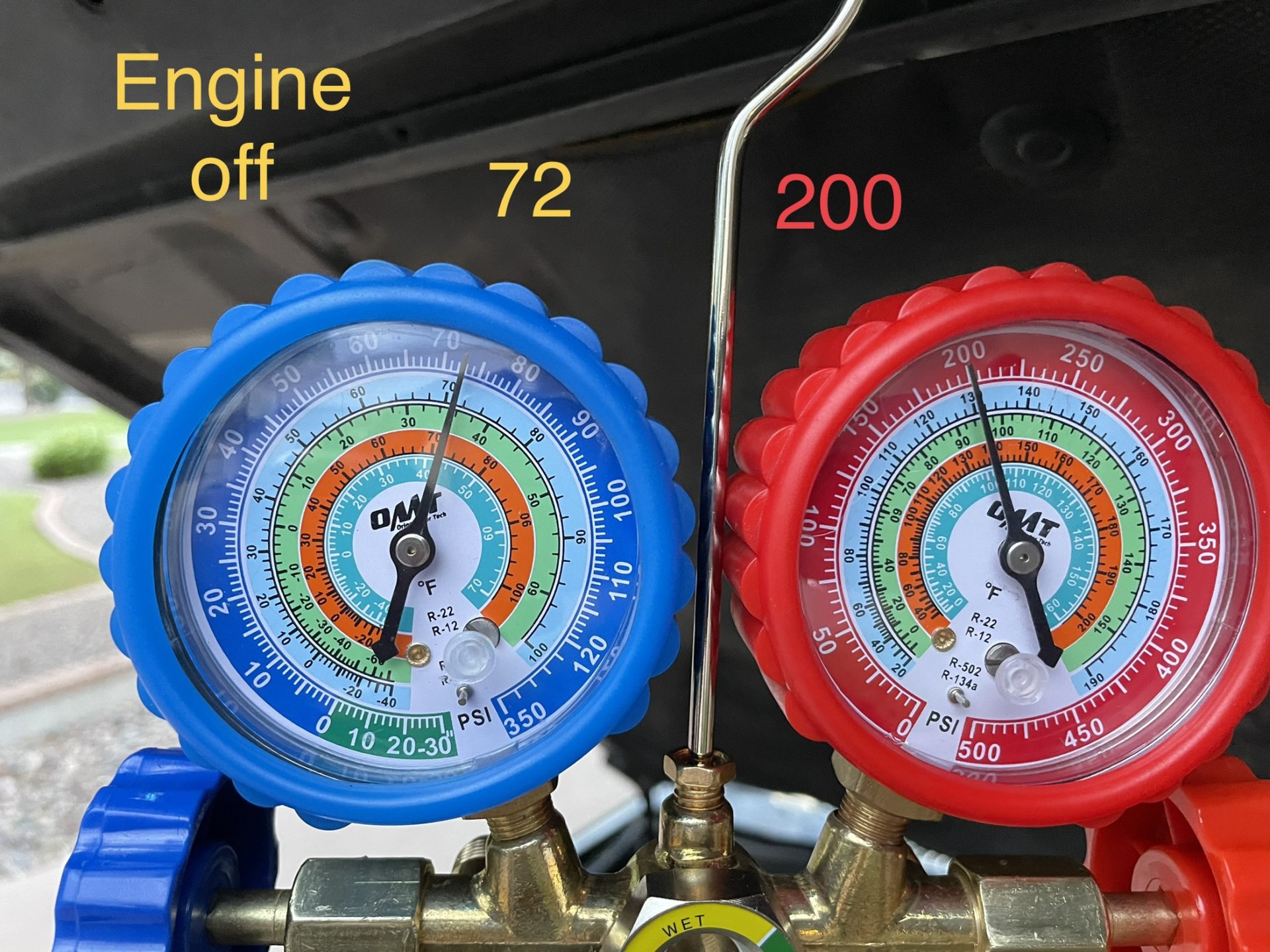

Ok. Ambient 98. Engine 190.
Here are the readings. I have not researched to guess at what they mean. Vent Temps still around 60+/-
Definitely undercharged.
Follow the directions I posted above to get the charge up, then repost how its doing.

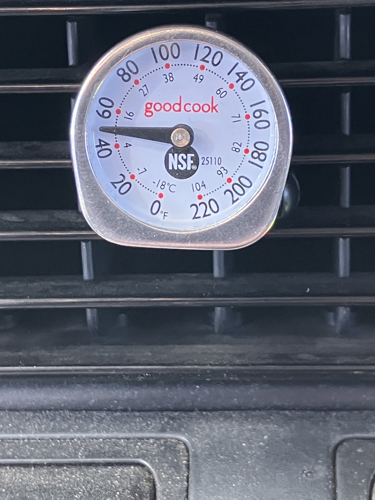

Here are my temps.
Starting at 91° outside temp.
First is just a few minutes driving with fresh air
Second is about 10 minutes driving recirculate air
Third and fourth are idling and parked. I think outside air is 95°
