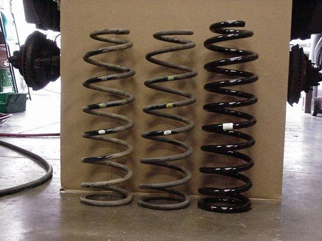

AL you failed to mention front or rear…. Anyway the length of an 80 spring will change with as little as 100# added weight and an 80 weight is more then a 60. Dont know what you are think about but here is a picture of a Land Cruiser FZJ80, Lexus 450, and an OME 850J (all front) with no weight to get you thinking.
Sorry, Sorry I wanted both front and rear measurements....thanks for posting the pics....def. got me thinking...
