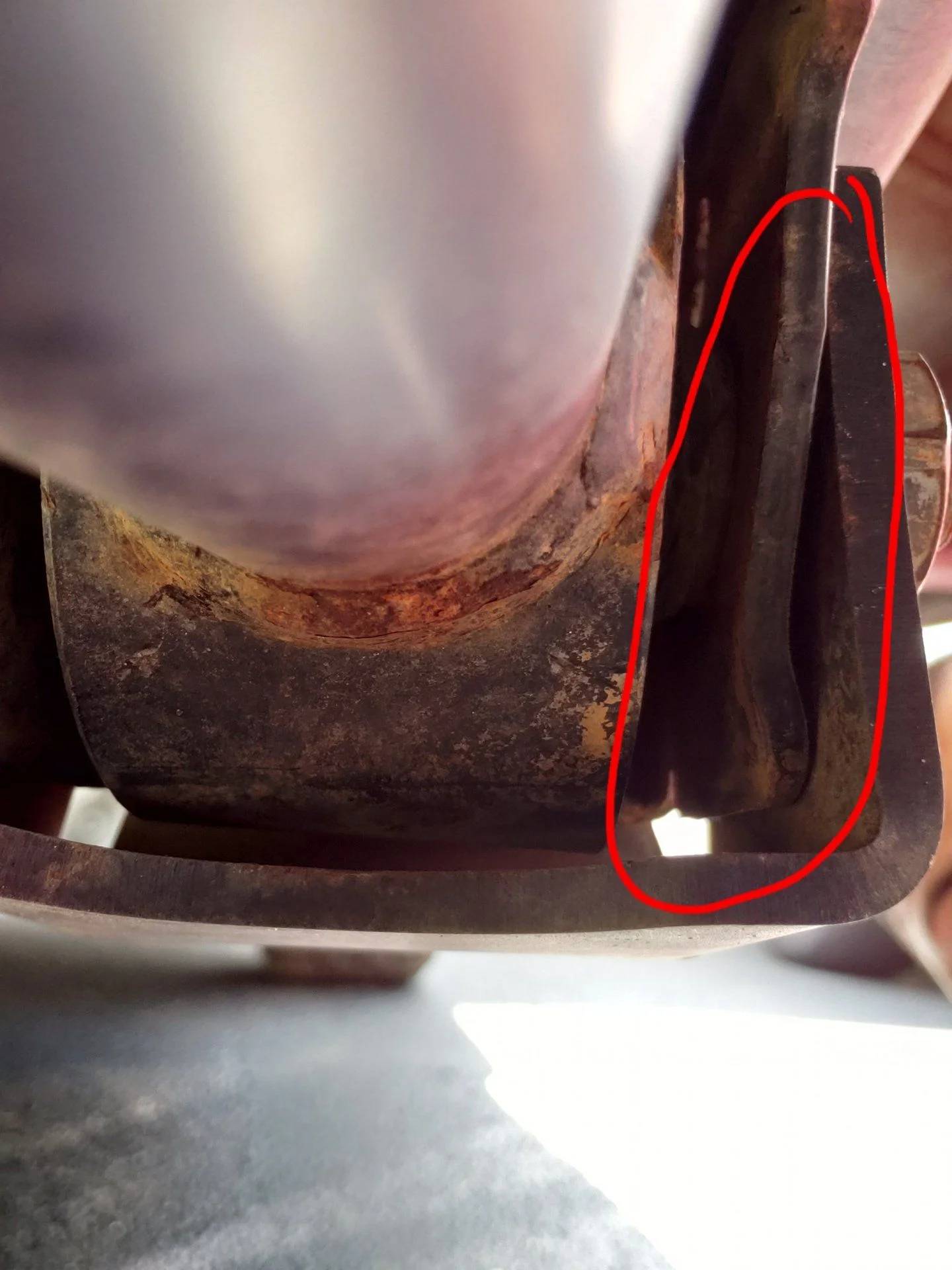

That skid protects the frame side mount. Around where the Rear LCA can be removed, the metal is relatively thin and easily bent if you end up resting/dragging your rig along it. I had to bend mine back out a bit since they folded in.

Looked thru my phone to no luck. Don't take my post as if it completed folded. But let's call them ears, they were starting to bend to close over on one side and the other opening. I threw the guards on after my first time wheeling and seeing it as a week point since they hang so low. I'll try to see if I can get a decent picture tomorrow without removing the guards

Here's the part I was talking about. What is circled in read can bend into the LCA or away and seems like the weak point.

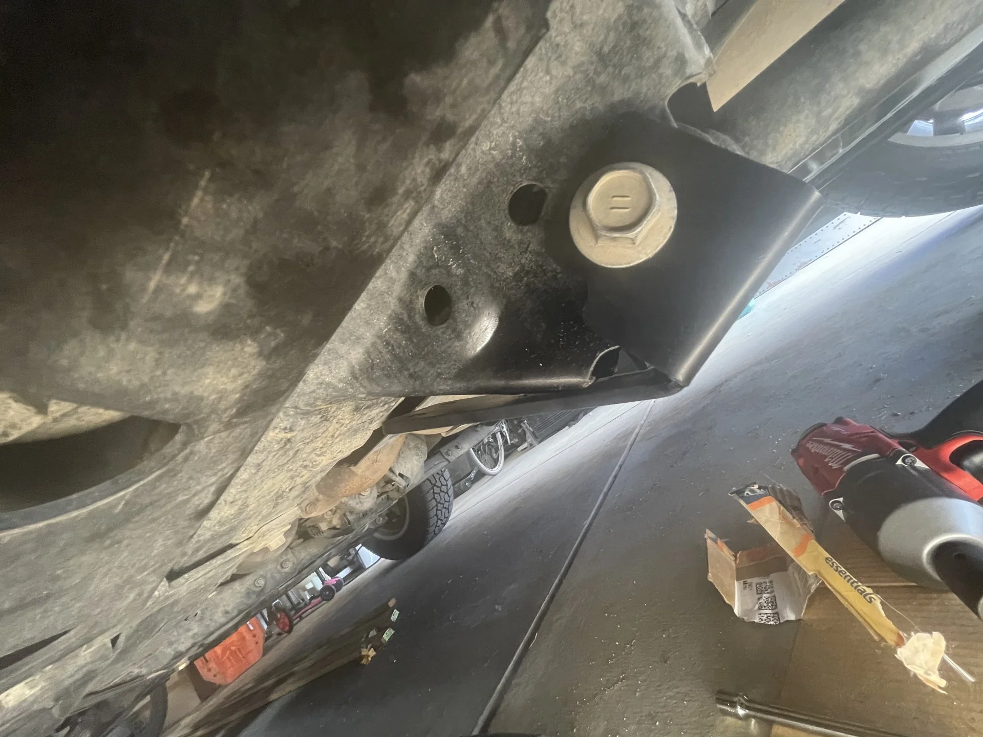

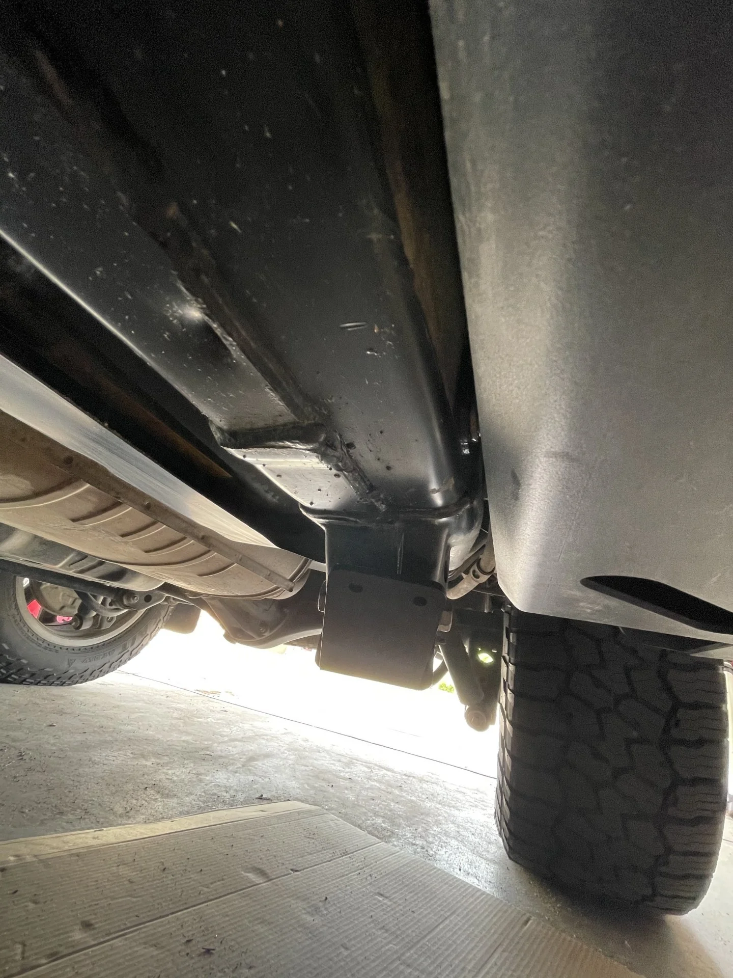

So I’m finally getting around to installing these... going with bolt in but there is quite a bit of gap. Is this normal? Do I need to “persuade” these to fit closer?
