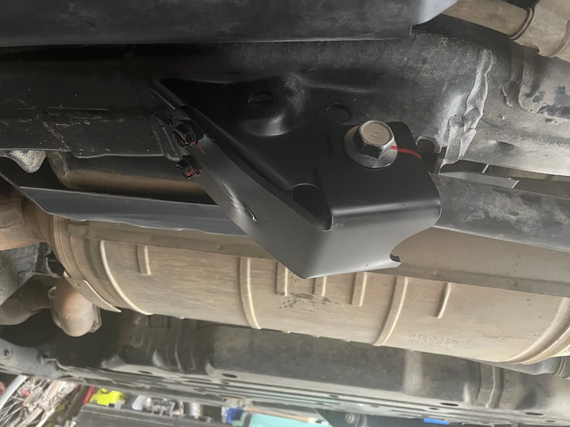

Got them in today. The mounts had been touched a few times in the past needing some persuading to get the skid plate to fit.
I dropped the gas tank skid to make it easier on the passenger side. Took the chance to clean it and touch up any scuffs.
I'm liking the paint markings as a safety feature.
