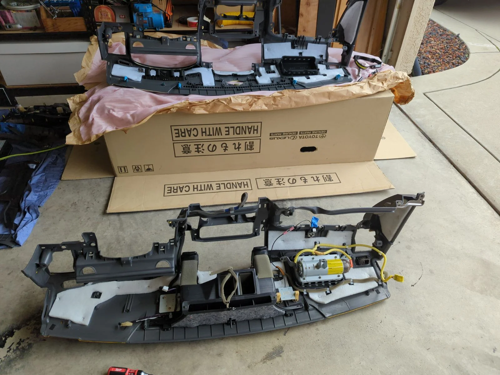

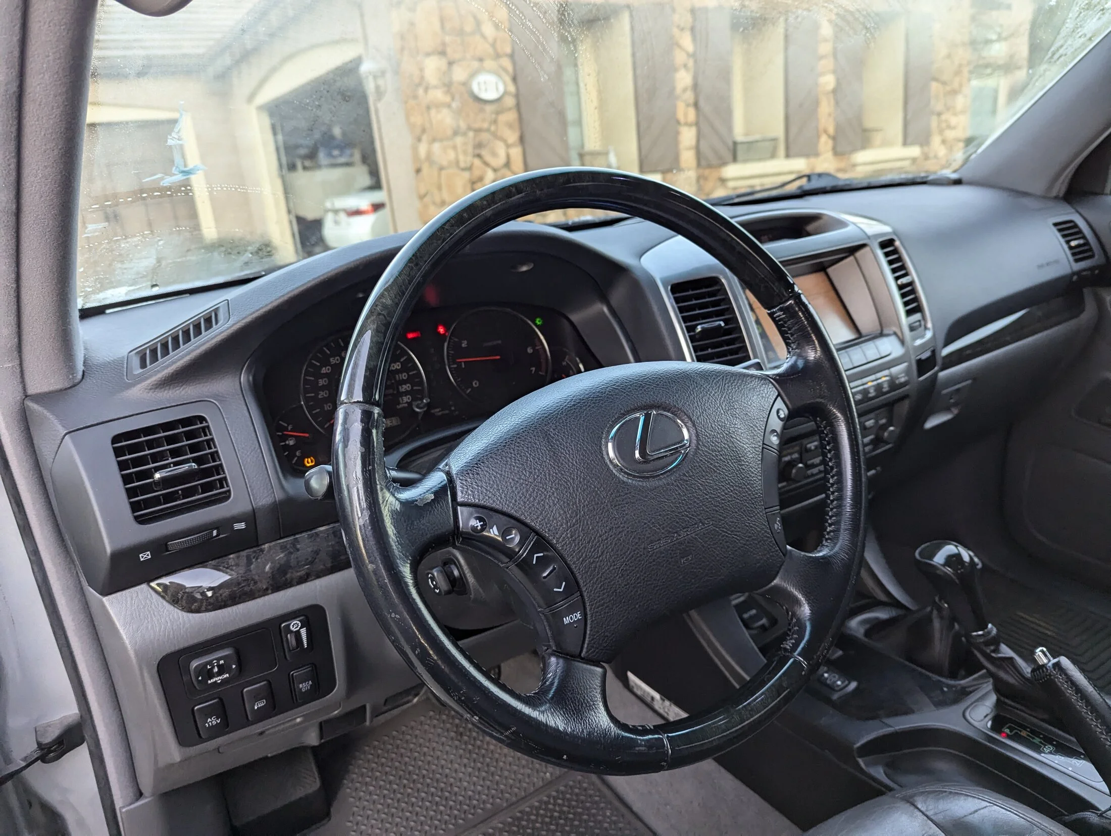

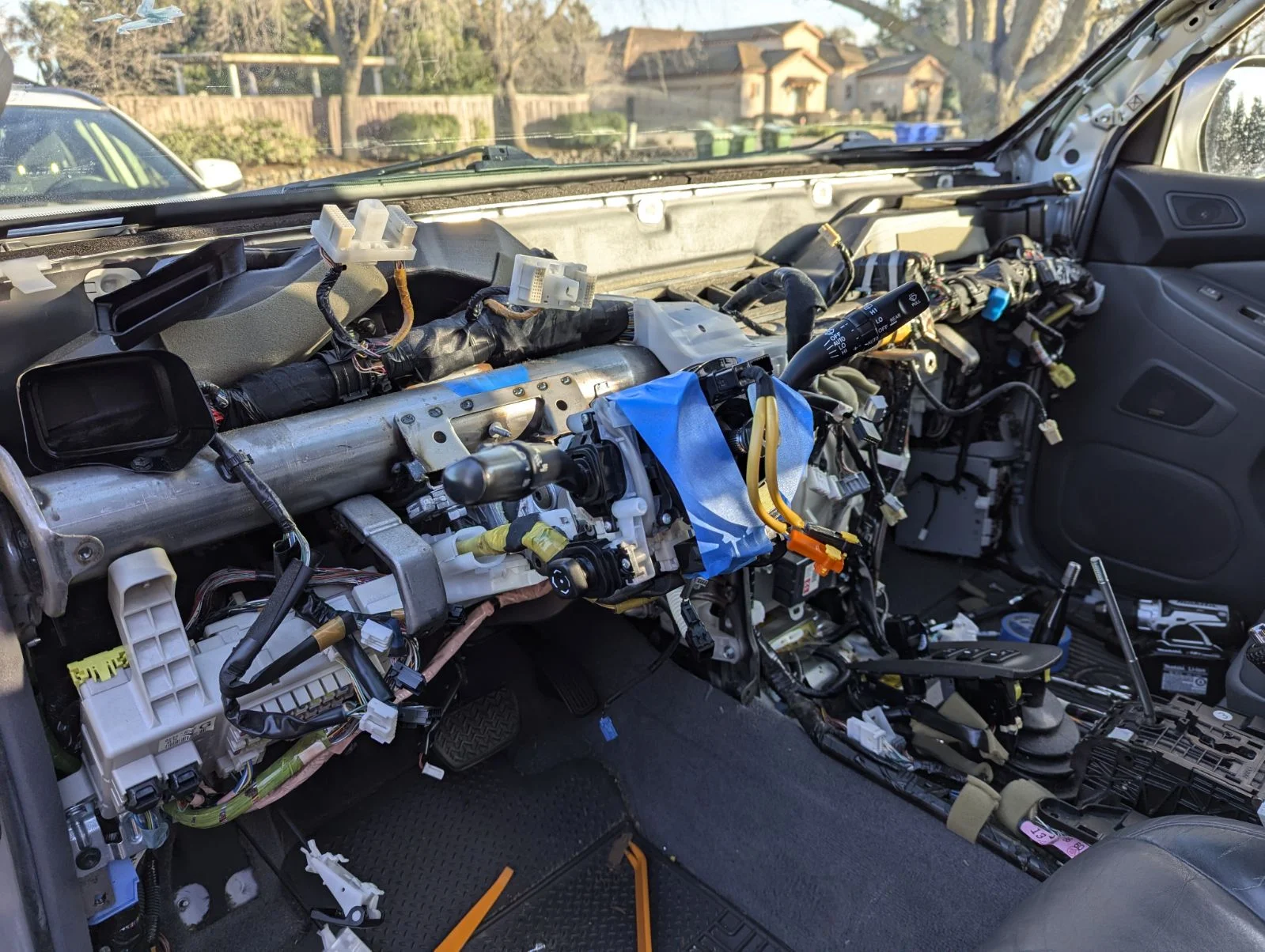

Recently tackled the cracked dashboard replacement. When the initial campaign was running for these, our vehicle did not exhibit any symptoms (probably because we kept it garaged all the time), so Lexus would not do the free upgrade. Sure enough years later it finally started cracking, gumming up, and crumbling apart. But Lexus NA told me I was now outside of the campaign period and they could not cover me (this is the great customer service I paid for Lexus...?). They quoted me $3K to replace it. I told them to pound sand, how much was the part on its own? Bought the new dash shell at what I thought was a pretty good discount, and tackled the job myself over the holiday break. I also took the opportunity to install a GROM VLine unit so I could use Android Auto with the touchscreen, and finally be able to use GPS navigation again. Cool thing was, the dash was shipped to the distributor in March of 2024, so I'm assuming it was fairly new production and not sitting on a shelf for the last decade. It sure looked newly manufactured. Gotta love Toyota. Here are some pics of the job.

@stoshzack - yes, very "therapeutic"...but actually not as hard as it might look. Just be careful about cracking plastic tabs on nearly 20 year old vehicles. One other thing I found was that during a past windshield replacement, the tech had over applied the glue, so I had to cut away some of the headliner fabric on the A pillar panels, and then glue them back down again. Likely they wouldn't survive another windshield replacement, but hopefully I never have to remove those panels again, in which case it wouldn't matter.
