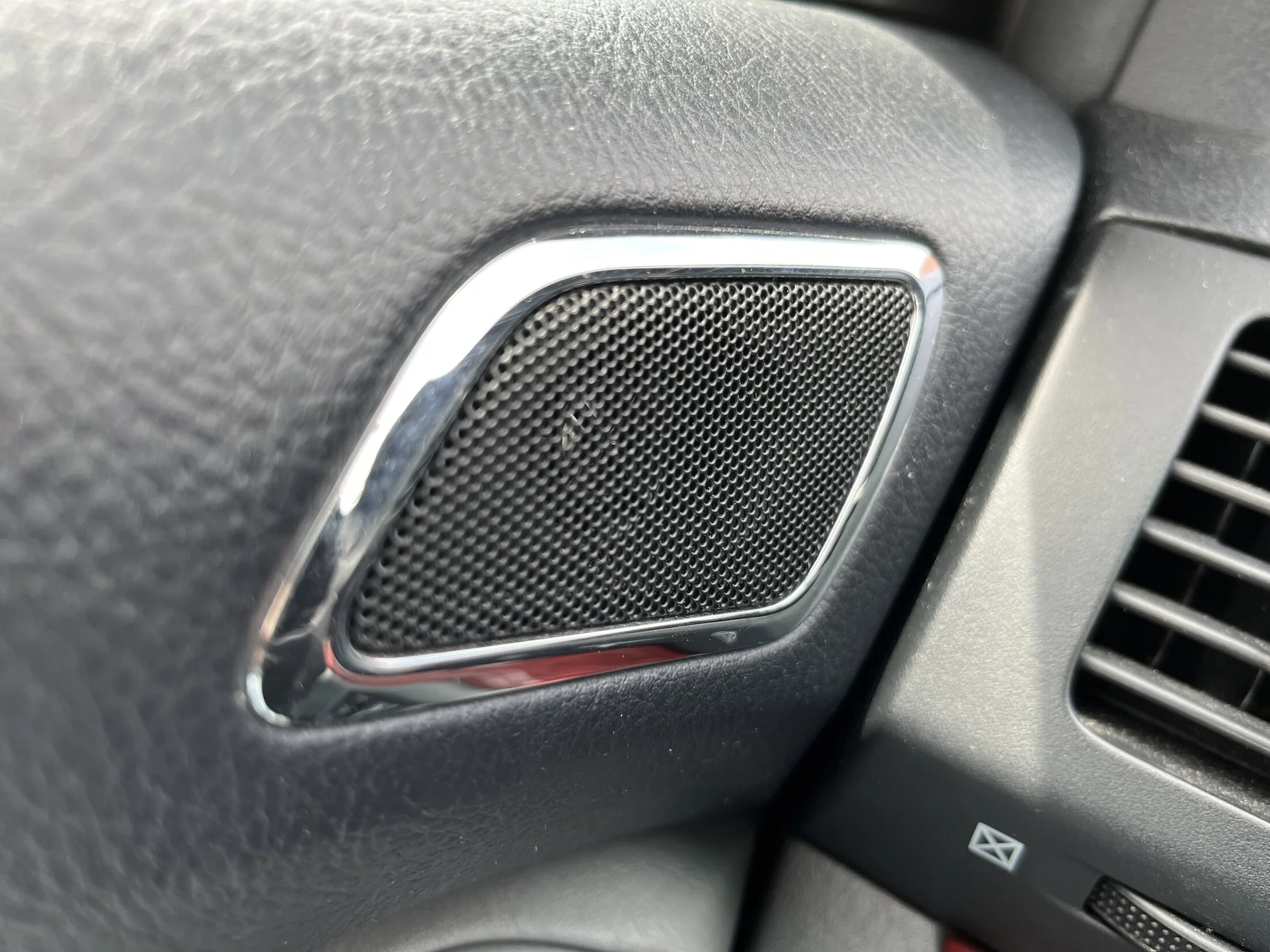

I narrowed down cracking sound on my GX to this speaker. What should be the replacement? I thought this is the tweeter but when I searched on ebay, it looks like most listings with tweeter in the title/description show pictures of the mid speaker. Thanks for the help. ML version.
I managed to open to take a peek at the part number. It is 86160-0w600. $101.62 from Lexuspartsnow. What could be the issue here? The ones that are commonly talked about are the woofers with refoam. Replace or perhaps the capacitor?
Definitely replace. If that is $101 for each tweeter, find a replacement tweeter with the right ohm rating and install instead
