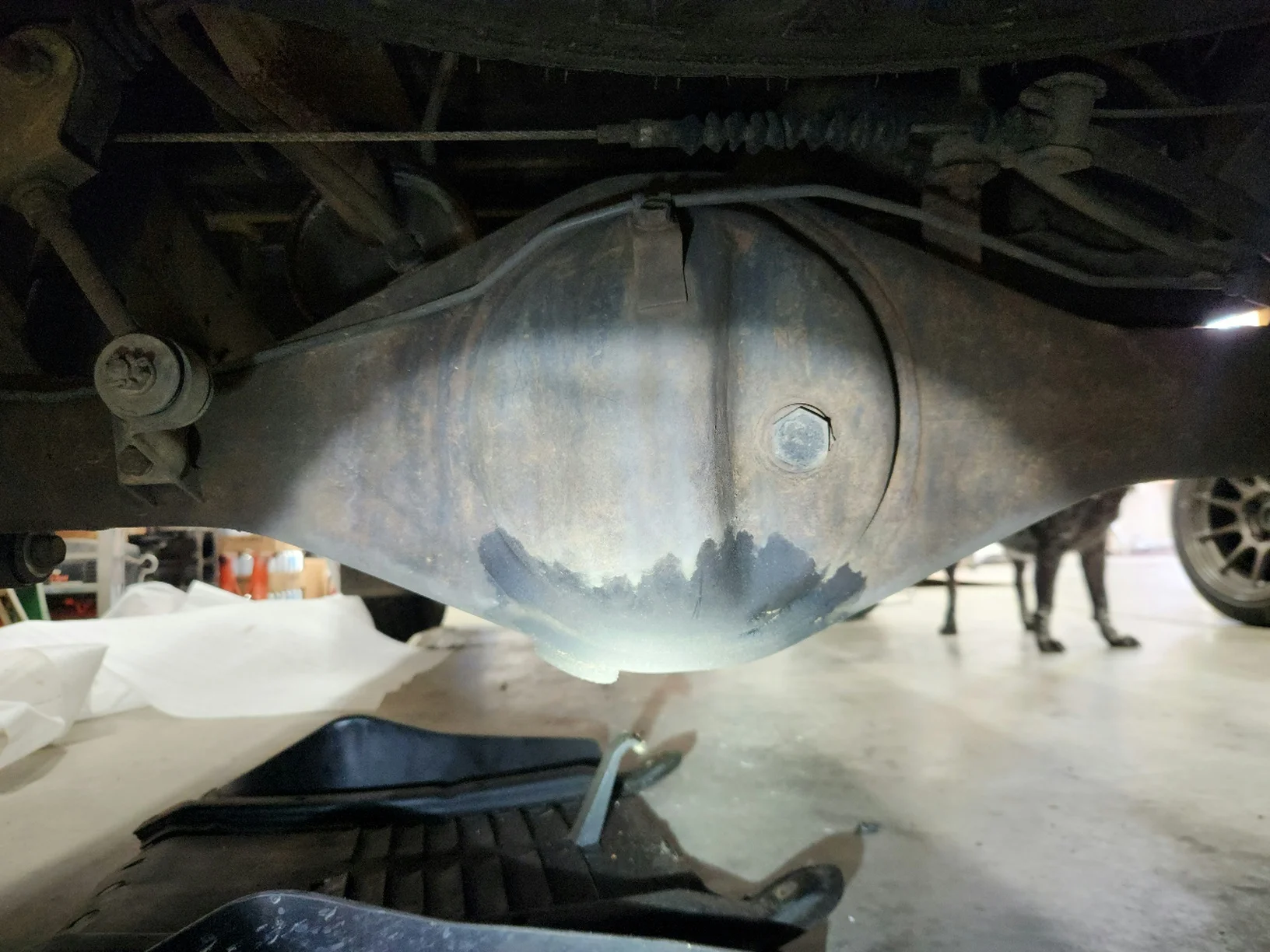

While chasing drivetrain leaks, might aswell ask about the rear diff (ref. other photos.) Pretty sure pinion is partially to blame. Not sure if the rest is drain plug or if I need to pop the guts out and replace the RTV. Any recommendations?

typically with a pinion leak, you have a pinion bearing dying and the diff needs gone through.
