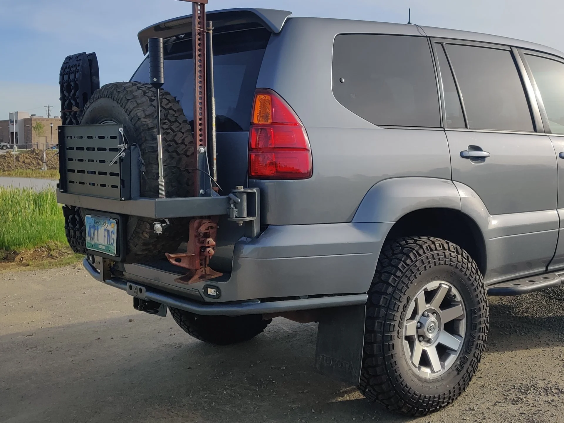

I have the old 5 volt Drive reach for a couple years. It works pretty good. It still lose reception but it's a lot less. The outside to inside antenna separation it important. I used to mount it on ditch light bracket and it worked much better once I moved it to the spare tire swing out.

LOVE that swing out!

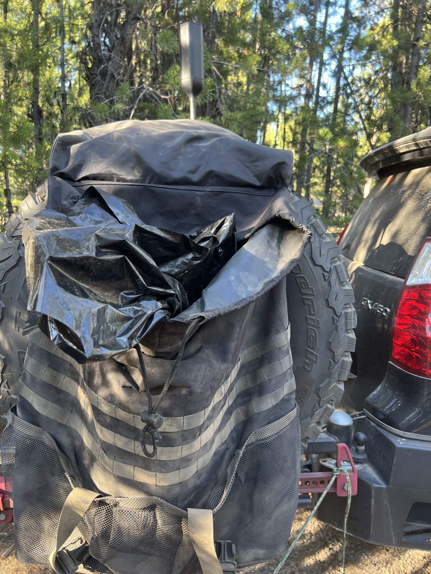

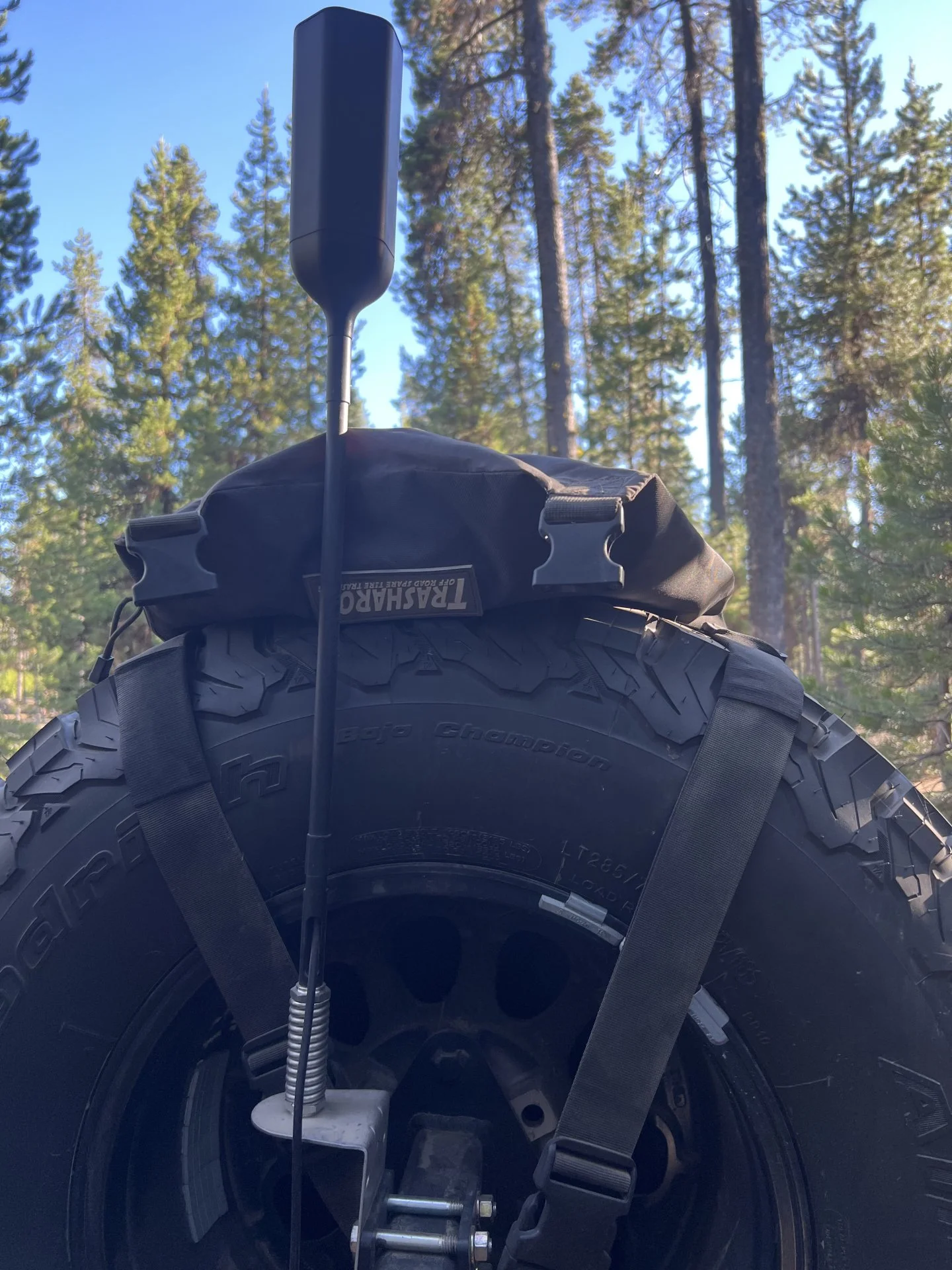

Sorry for the late reply, I’ve been testing it out since I got it hooked up on a 5 day trip. I mounted it behind the spare, mostly so I could get enough height that it would clear the roof line. I’m going to look at a better solution for the mount, now that I know the Weboost is worth it. I’ll probably keep it in the same general configuration, just create more space for it to move rearwards since branches will inevitably hit it.
I was unaware about the 8ft distance between antennas. I definitely have that currently, but good to know. I ended up just mounting the interior puck on my expedition essentials track, it worked but I might try and find a better solution.
THEOZMAN I’ll take a gander at that 12V adaptor, thanks for the heads up.
