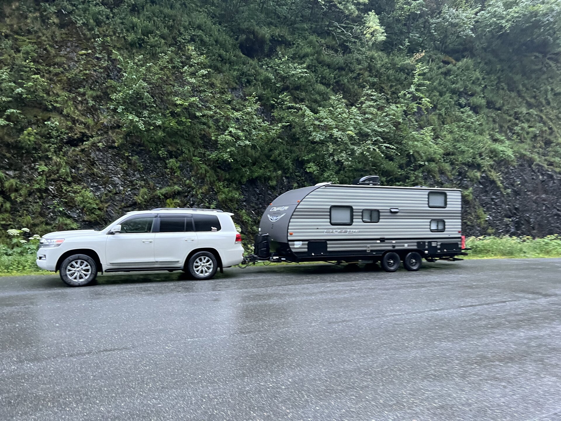

Sorry I have a TLC but highly recommend a WDH. I towed a rental trailer twice this past summer that was around 4500lbs/465lbs at the hitch with about 200lbs supplies in the trailer and cargo area. I drove the trailer home from the rental agency dry and the TLC was not pleasant to operate. The nose was pointed towards the sky, the steering was light and did not inspire confidence for the roads out to Valdez. Just before the trip I got a second hand equal-I-zer 6000lb/600lb WDH and it made a world of difference. Attached picture is with the hitch second to lowest position and trailer bars at their second to highest. It was the closest I could get to the ideal number in the companies calculation for the installation instructions. Also just to note we hit heavy winds coming back through the valley to Anchorage and the WDH was making a ton of noise doing its job but I never once felt the trailer start to drift and the TLC always felt composed. I imagine having AHC will make a difference when compared to the suspension on the TLC but I would wager a WDH will still be needed.
