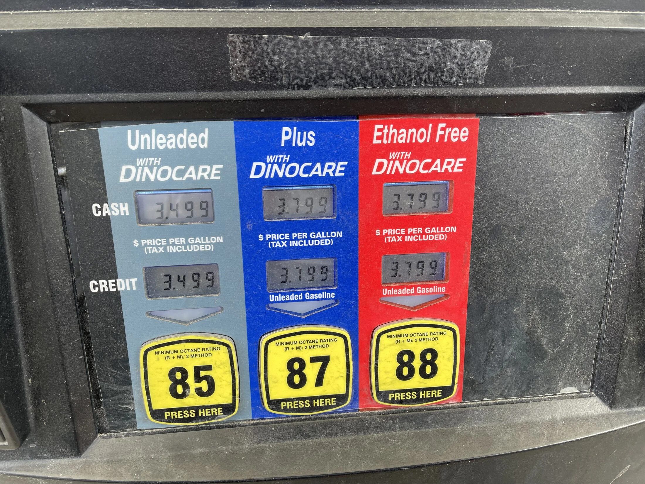

Yeah I pretty much run exclusively 85 (with ethanol--don't know exactly how much), but I'm at ~6,300ft in CO. Common fuel to see around CO.
My local Sinclair here in UT.
BTW, my LX did not like the 88 ethanol free. My KCLV normally runs around 17-18 with 91 and it tanked to like 10-11 on the Sinclair 88. I’ve never seen it that low.
I used this tank in pretty much 170 miles towing getting an atrocious 8 mpg
To @Umbrarian and your point, octane matters particularly to LXs that are tuned for the higher test stuff. Especially in high load operation like towing and long grades, and I likewise see KCLVs and performance fall off a cliff.
Yes, with altitude and less atmospheric pressure, there is lower peak cylinder pressures which requires less octane. What sucks is leaving the local area and returning to lower elevations in summer, and having to deal with low octane performance when towing. Just went through Death Valley Stovepipe Wells which is 10 ft above sea level on a 105 degree day, and they only had 87 octane :mad: . Good thing I was dropping off the trailer for a backcountry leg, as otherwise, that would be knock city. Made sure I got high test before returning to pick up the trailer.
