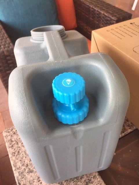

I have been searching for the right water container over the years and think I may have found a good solution.
I typically travel with a couple gallons of drinking water that's in disposable gallon containers, so The storage container is to supplement that. I want enough water for a weekend for wife and I. This is for emergency drinking water and for basic hygiene and cooking. I have tried the usual 5 gallon blue big box retail containers but found the spouts break too frequently and slosh water around in back of my truck. I also tried the water bricks, but they too leak and are kind of a pain in the ass to use. The manufactured water spouts are in the middle of the lid on container, so you cant get much water out of them when stored in the truck. I modified one and put a spout on the bottom and then a vent on top which improved usability but still had leaking issues around cap as it heat cycled through the day.
What if I could find a 3-4 gallon container that fit on my Puma mount and was shaped to not be awkward and unwieldy, had a spout on top so leaks would not be an issue, I could pressurize it to dispense with a built in pump? What if it had the capability to filter river/stream/lake water in an emergency too?
I bought this a couple months ago and have used it a couple times. I am very happy with it so far. I plan to use filtered water in it to preserve the filters for emergencies that I hope I never encounter.
Two stage filtration and storage. I bought it on Zuliliy for $99, not seeing it there any longer. It is well built, heavy and has baffle/support inside.
The filer ratings are 1- 10,000 gallons and 2-250 gallons. That is a lot of camp drinking water and I figure if I start with good filtered water I will not need to replace them before the container is no longer functional.

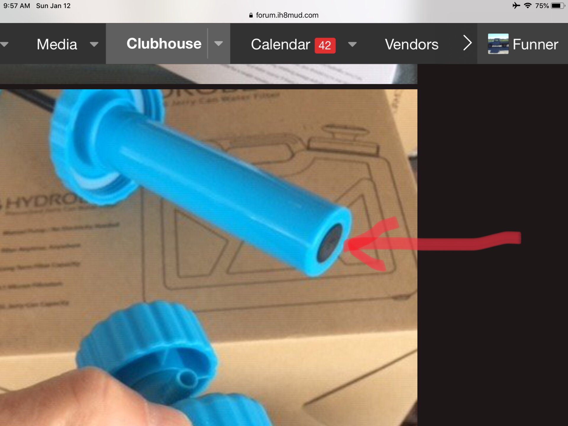

Thread update. The pump has started to fail. I suspect it didn’t like sitting in a hot truck all year. I have reached out to the maker for support, ie asked them if the can sell me seals to rebuild the pump. I will see what they have to say and report back.

Resolved. After closer inspection the rubber valve on the pump had fallen into the tank. Reinstalled and is working fine again. Manufacturer offered support, would sell me O-rings for replacement, just didn’t end up needing them.
