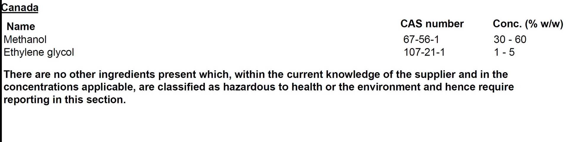

MSDS: says it contains around 30-60% methanol and > 1-5% Ethylene glycol

MSDS
your engine aint meant to burn glycol
