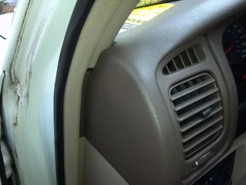

Rainwater has been soaking my DS footwell carpet during heavy rains. My 100 had a replacement windshield about 8 years ago and I initially thought this was the culprit.
Although I spent countless hours on finding what ultimately was clogged sunroof drains on my Rabbit GTI a couple decades ago, it took the members of this forum to help me fix the same issue again. I was seeing a water trickle in the side of the dash where the A-pillar lands, and drips near the gas door pull.

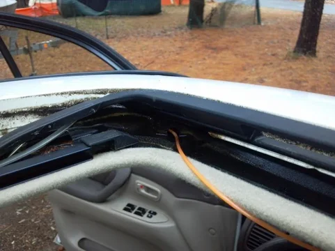

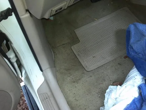

I opened the sunroof this morning after finding my carpet was soaked again overnight. There was an obvious pool of water on the DS, which was on lower ground than the passenger side.
User smm3 had suggested in an eariler post to use string trimmer cord to clear the drains. I did that and water quickly poured out at the rear of the front fender area as I slowly pushed in about 3 feet of the cord. Problem solved quickly thanks to this forum. :beer:
Nice! Thanks for the photos and update. That weedwhacker string idea is excellent and showing where to insert it in the drain will save time when I eventually have to clear mine.
