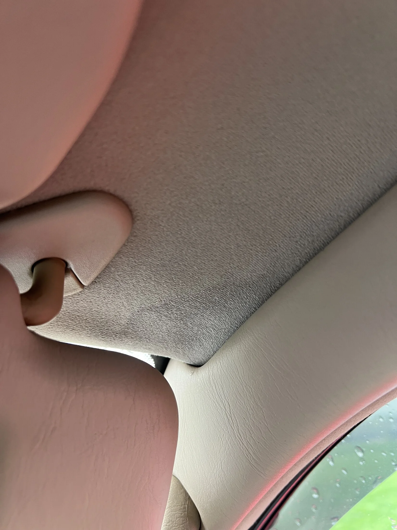

Today I there was heavy rain during my drive this morning and I noticed on my passenger side was wet and underneath the glove box towards the right side I could see slight dripping. Also the top of the passenger pillar near the sun visor was wet. Is this the notorious clogged sunroof drain? Or could it be the windshield. I believe the previous owner had the windshield replaced but not too sure. Hoping this is just the sun roof but some insight would be helpful.

Yes, same spot on the floorboard, but fortunately I didn't have the leak in the roof liner. My repair was further complicated by a broken sunroof so I had to unbolt that as it does not retract. Good luck! (I actually had fun doing my repair, hope it's the same for you!)
