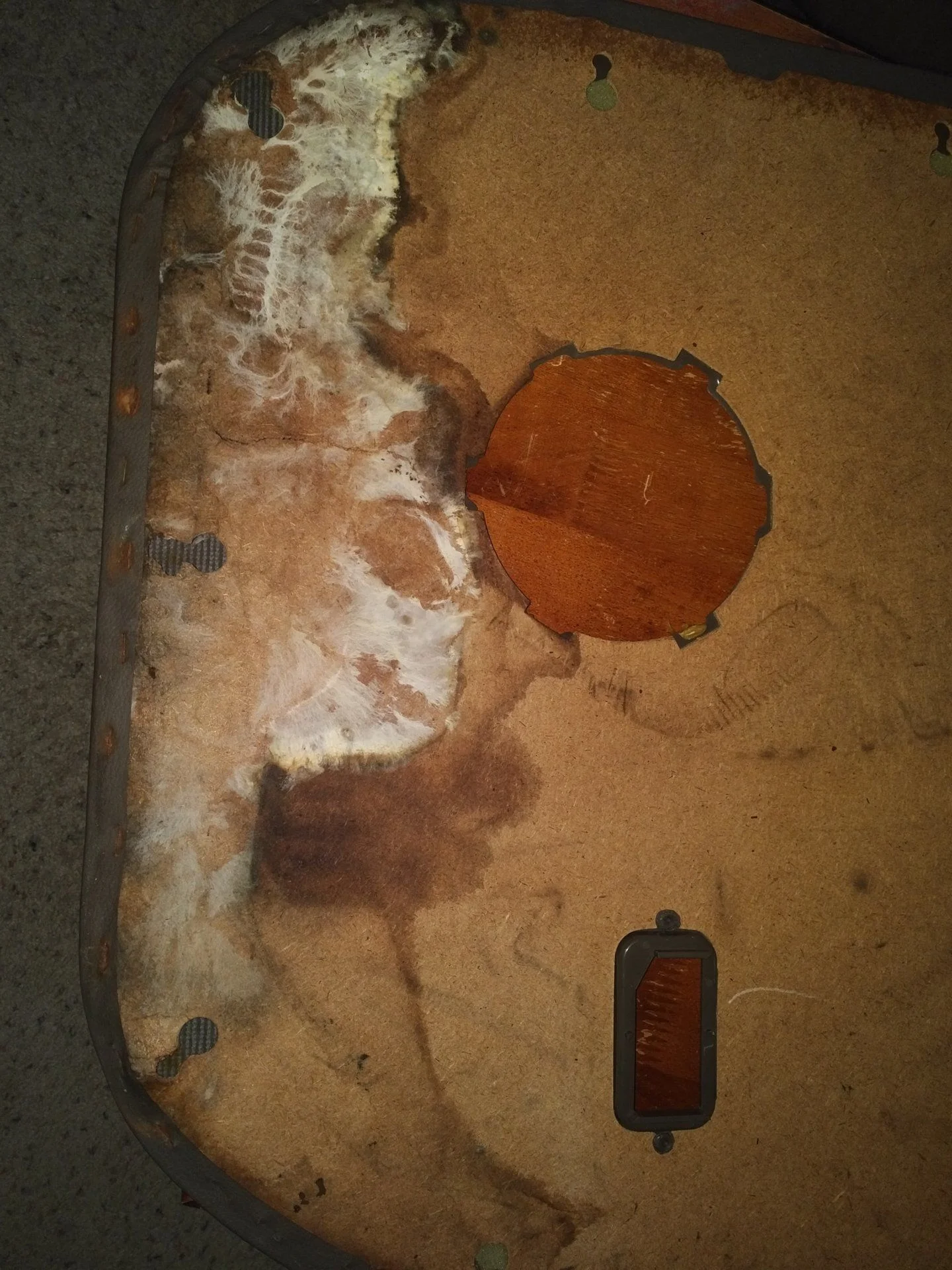

Hi All, this is my first post here. We have recently purchased a 1996 80 with about 242k miles on it. It needed some TLC and I enjoy fixing things up so I've been digging in and getting things in better shape. At the moment, I've removed both rear door panels and have found there to be some water damage and it's pretty bad (starting to mold). The moisture barriers on one of the doors was completely intact and looks like it had never been removed. Surprisingly, this door card was the worst looking. There was a little moisture on the barrier in the area of the where the door panel is damaged.
The truck has been in the garage for a couple of weeks and all of the door/window belts seem to be in decent shape (no major gaps where water might easily pass).
My question and concern is where is this coming from?!?
I'm planning to get replacement door panels or cards but I'm going to be really disappointed if this just ends up happening again to the replacement parts. I'd like to solve whatever is causing the problem. Is it possible that there is not enough air getting in to allow condensation to evaporate? I can't imagine this would be the case, but if so, how could this be fixed? To me, it looks like there has been a significant amount of water sitting next to the door card, not just condensation. The worst of it makes the card itself very weak and very flexible.
Your help is appreciated!

How do the vapor barriers look? The plastic sheets behind the panel are designed to keep water on the inside of the door. Over time they get hard and crack and the butyl holding them to the door stops being as tacky as it should. You can get them from Delta or the dealer and the butyl can be sourced from 3M.
I'm in the process of redoing all 4 of my doors as the panels looked similar to yours on the inside.
Looked fine, however I didn't inspect so closely as to spot cracks.
Most likely the slits in the bottom of the doors are clogged (use a zip-tie to clean them) and the doors filled with rain water, then leaked into the door cards through the speakers.
Also, look into changing inner and outer mouldings (door seal to the glass) to keep the rain water in the doors to a minimum.
Sorry for shooting from the hip; just going on person experience with my truck and other vehicles. Maybe try water testing the door, with the panel removed and see if you can pinpoint if its leaking past the barrier or pooling up due to clogged drain holes as mentioned above.
Your drains are clogged for sure. Also there should be a plastic vapor barrier between the door card and the door itself. Is that gone?

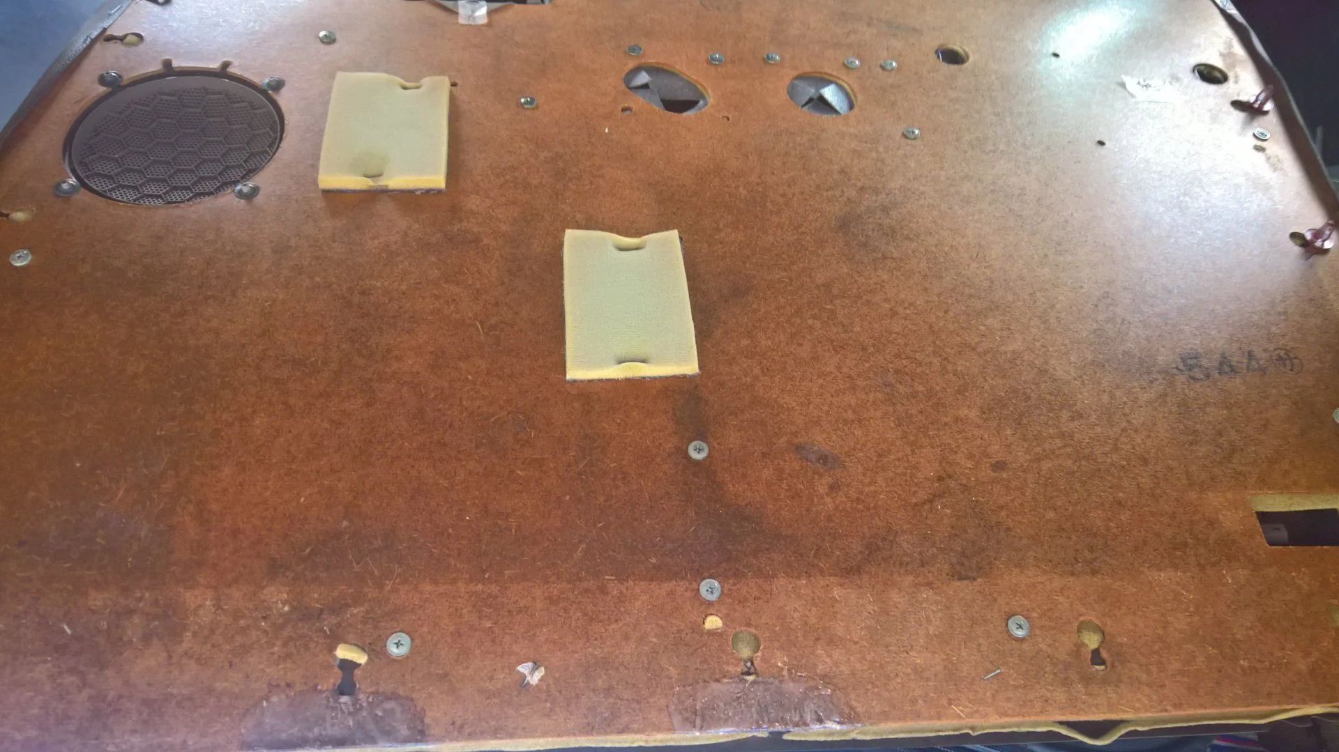

This was mine. Pretty sure the previous owner...elderly lady left the window cracked and never parked in a garage. I ended up removing the panel cover and making new board. Helped with the moldy smell
Uber important to have a completely intact vapor barrier, which probably should be called a water barrier as water normally trickles though the inside cavity of the doors everytime it rains or you wash your vehicle.

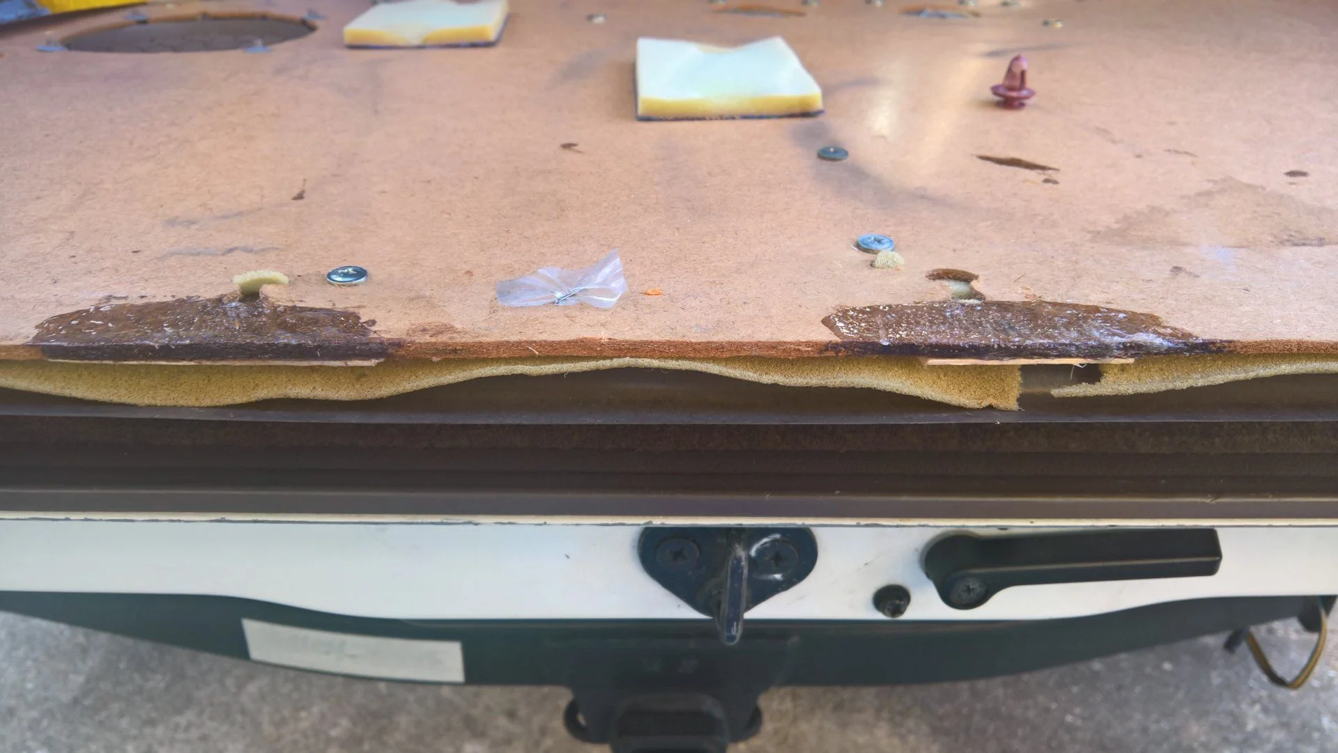

Just finished a quick minor repair of some cracking of driver's side door card. Got some large popsicle sticks from Lowe's paint dept (forget what they call them), then cut small sections and glued them with two part epoxy to the inner aspect of the door card (under the vinyl) between the rivet holes and the outer edge to strengthen that area. Also spread some more epoxy on the other side of the card to add some additional strength. Did not add wood to the other side as was concerned the extra thickness might interfer with the plastic rivets being able to be fully seated once installed back on the door.
I also sprayed the exposed side of the door card with a clear Shellac which was absorbed a bit into the fibers of the masonite board. Figured it might stabilize the wood fibers and protect them a bit from moisture. When I did this in the past to another card I spray painted over the shellac to help seal it up some more.

masonite board from homedepot. Probably not the quality that you would normally make them with at the factory as i am not sure they are treated for moisture, but if you have good plastic liner and use some sort of spray sealant on the board i think it will be fine. In short its way better than it was before.
Masonite is a good choice for the door cards. Make sure you are using the darker board, it is oil treated and tempered. Harder and more durable than standard hardboard.
