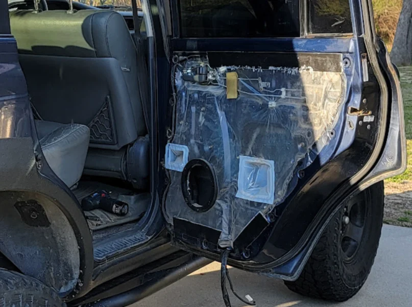

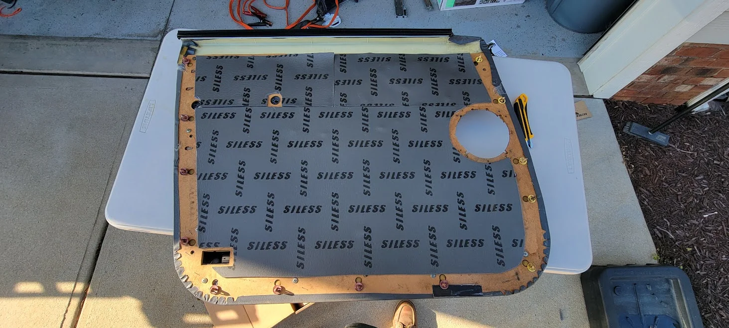

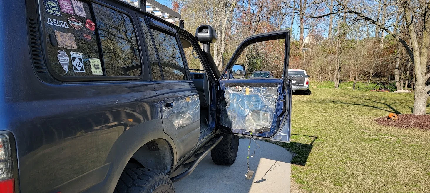

While replacing the driver's side window run, I had to remove the door card to pull the window run down the channels. While the door card was off, I added some 4mm closed cell adhesive foam sheet to the door card for noise and temperature control. I didn't document the process but it was quite easy. I started on the passenger side window run and repeated the process but took some pictures.
I've driven the truck with one door done and it seemed to make a huge difference but that would be because I didn't have a 2" gap in the window run with the sound of rushing air 6" from my ear. I will report back when all the doors are done.

All four doors are done. Many years ago I upgraded the rear door speakers to 6.5" speakers. The metal around the speaker is quite flimsy now. I added a layer of neoprene tape to the metal, covered with the vapor barrier, and then bolted my ~8mm modified speaker spacer on top. The door card went on next with the speaker mounted on the face of the door card.
