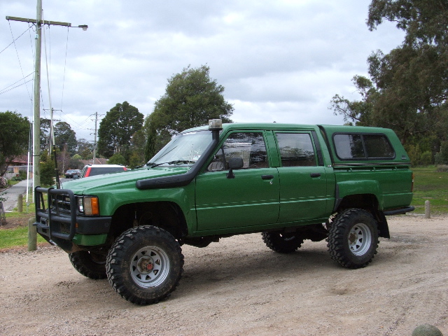

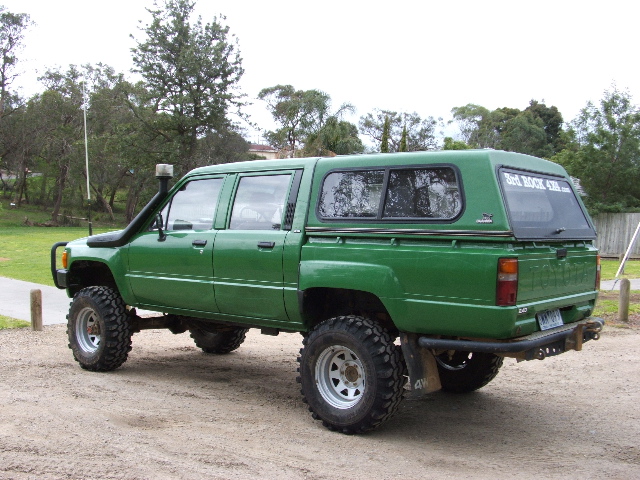

That's alot deeper than what it took to hydraulic my Engine, as I didn't get any water in the Cab or even the Tray. From my experience the water came in via the Airbox join and not by the intake behind the Headlight.
As an alternative Air Filter setup, I'm using Donaldson Part Number: H002437 and a Uni Filter Part Number: PRECLEAN3 SML inside the Safari Snorkel. :cheers: Be careful installing the Safari Snorkel as the template is inaccurate.
