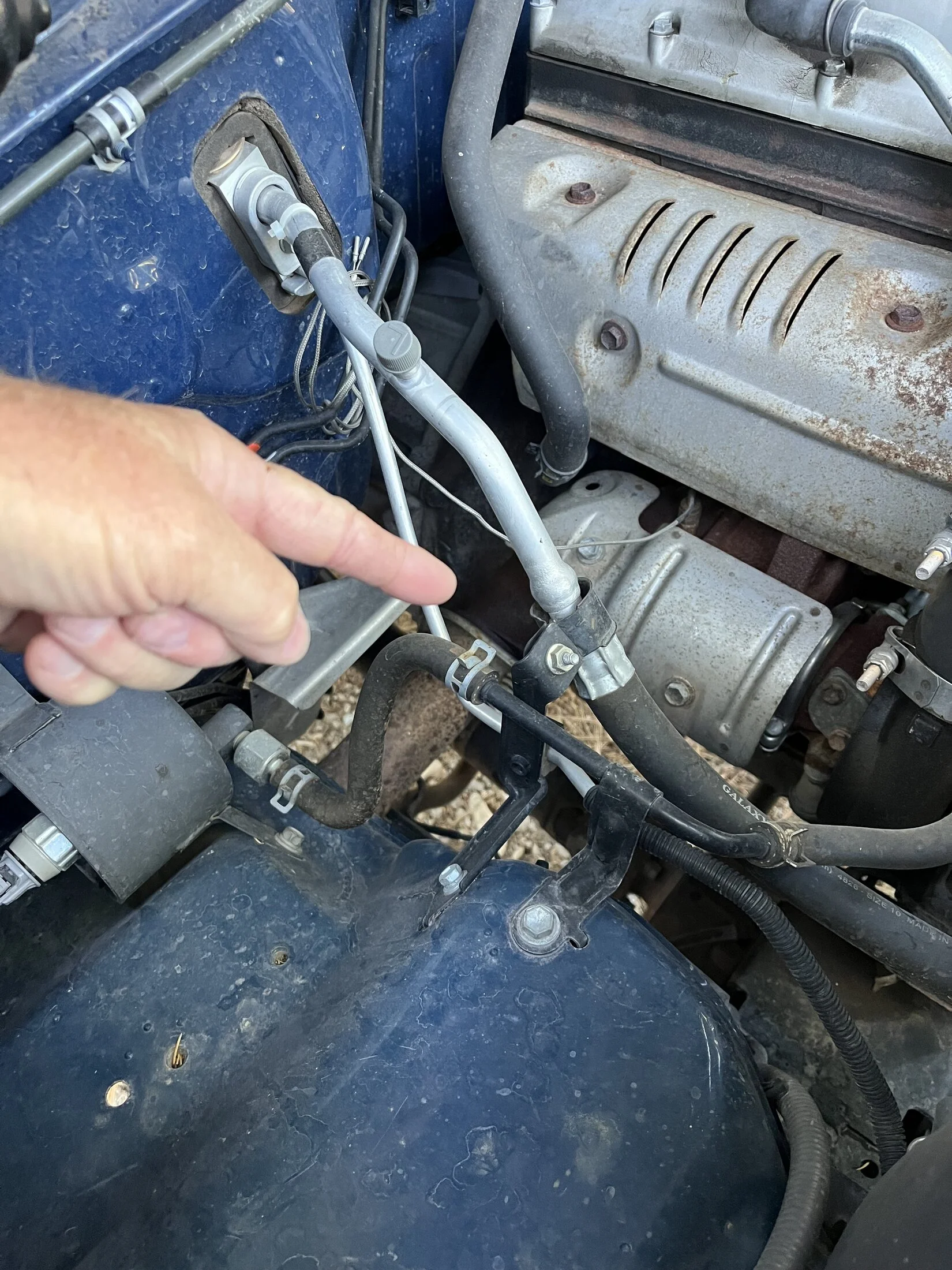

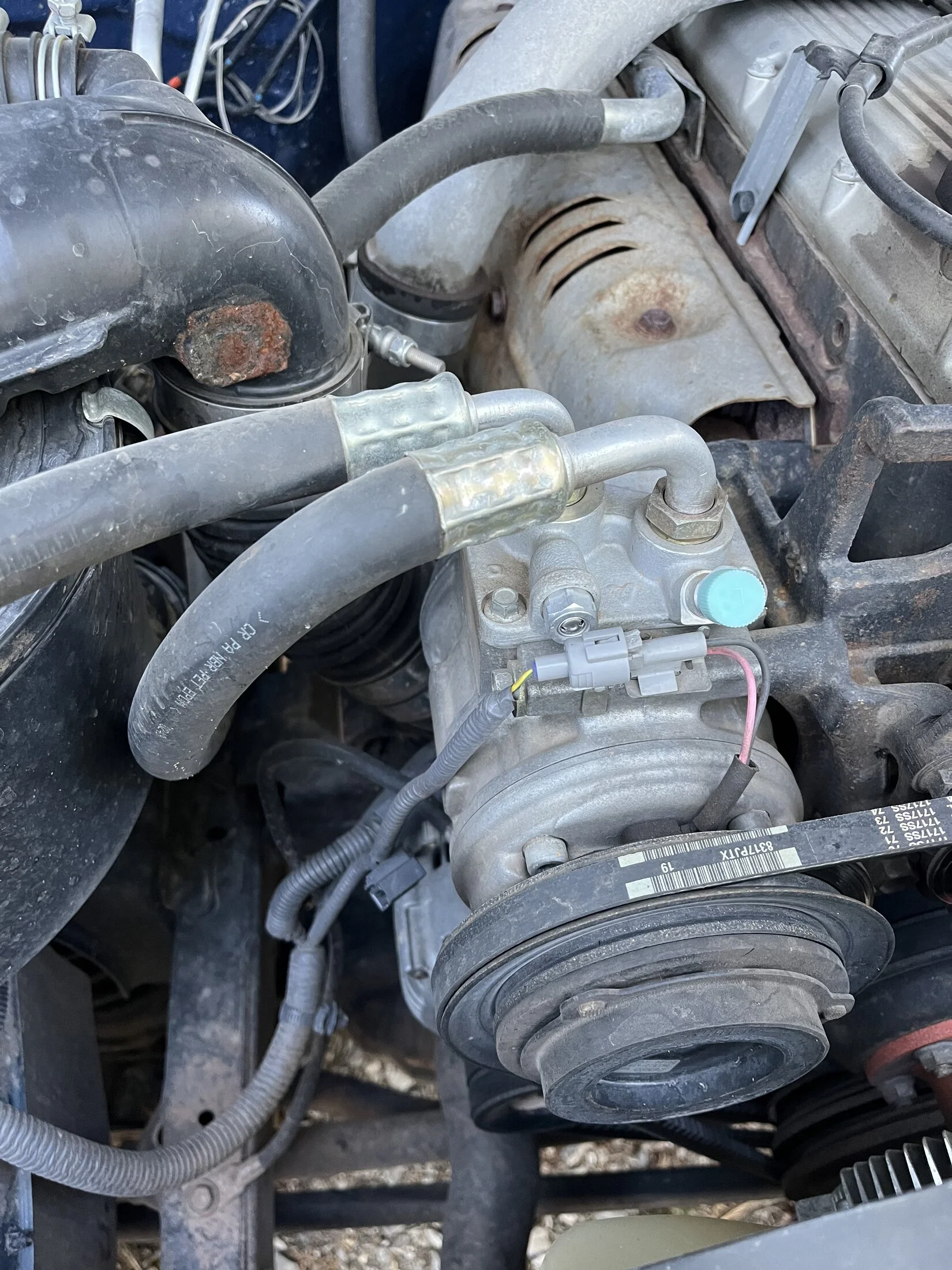

Dave Stedman can help get a lot of Denso stuff. He really helped me figure out my BJ/HDJ74 mongrel factory a/c. I had a local a/c shop here in Austin make and modify a couple of lines.
Top (suction plate) adapted
Aluma weld to factory line
