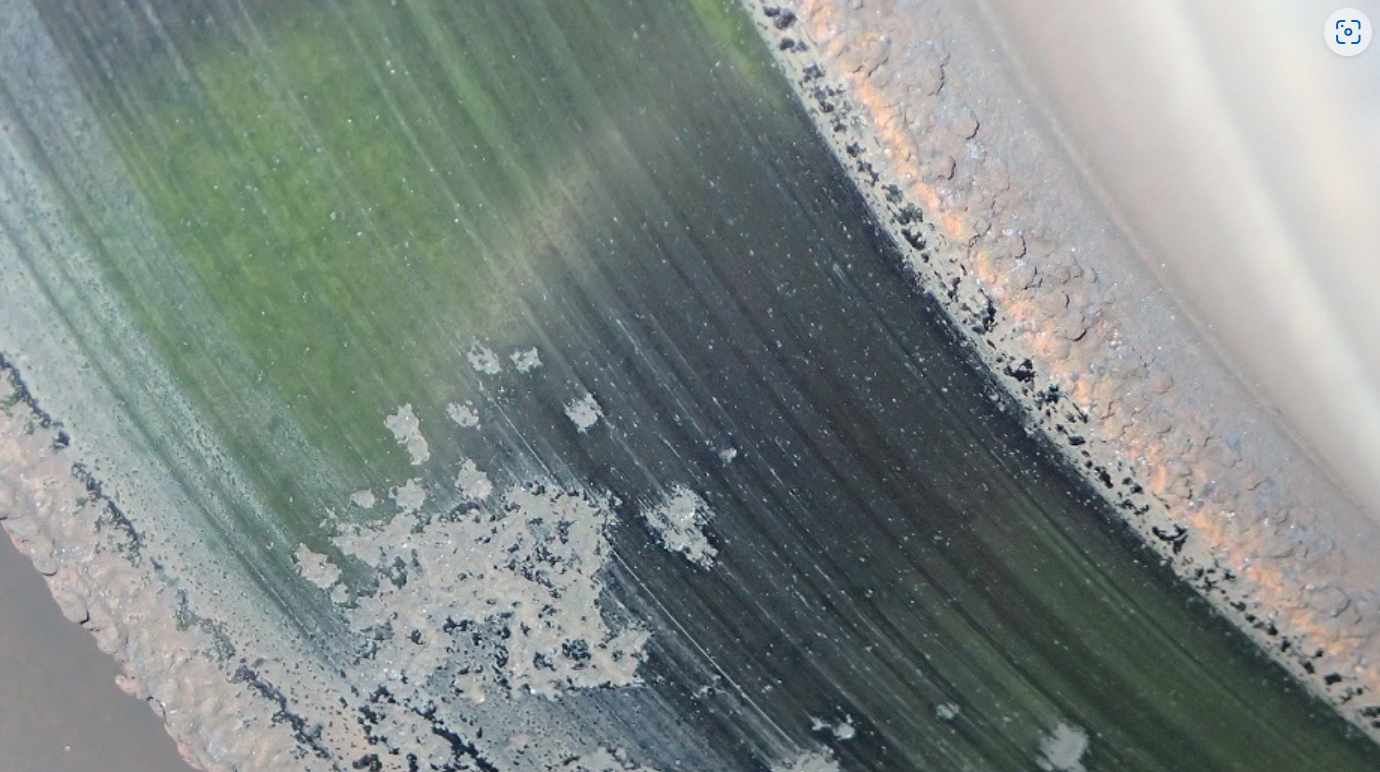

Here is a pic of one of my rotors.
Any thoughts on this?
I'm thinking of sending them back as defective. This is a Florida vehicle, so no salt, ice or snow.
The metal is coming apart, or flaking off.
Toyota OEM Rotors.

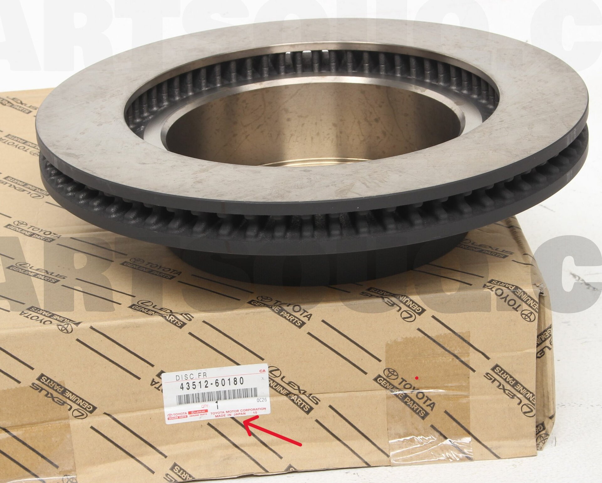

Here is a pic of a legit OEM LC200 rotor:

Unless you have evidence that the "OEM" rotors are manufactured in Japan, I call 👎 on this.
HTH

This is the "Toyota Rotor" I purchased from the dealer. The Part number is 4351260210.
And it looks like this... and it's warped.
That looks like surface pitting underneath the brake pads as a result of the vehicle sitting still in rainy and corrosive conditions like near the sea. Braking will feel like intermittent or "warped". Even OEM rotors will do this given enough time and weather/environment conditions.
Is this the same issue on your Powerstops?
Same, only ocean isn’t needed so I wanted to point that out before someone says that condition wasn’t present. I’ve had this from temp inversions that leave concrete and other surfaces slick from condensation combined with my truck sitting for two to three weeks at a time.

I am questioning your assertion that the Powerstop rotors and Toyota OEM rotors are made by the same company.
Are you still suggesting that Powerstop rotors are made in Japan by ADVICS of the Aisin Group?
