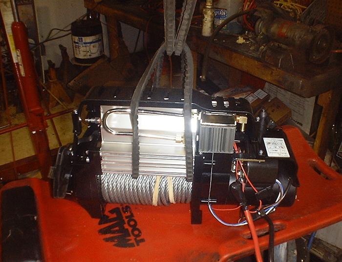

Does the one in the pic look like yours??? I guarantee this compressor runs all the time, and owners manual states it as well... when I get time I'll post the whole ordeal.........:mad:

So you're saying that the air comp runs when the winch runs? Hmm, isn't there a selector lever that moves the gearing from one to the other to prevent this?
Oops I was wrong, just asked and it does run all of the time... Seams to me that would be a lot of extra wear on the compressor that isn't necessary, but that's how it was designed.

From owners manual----------
Hmm, that's a bit disappointing! I wonder why the compressor still runs even after the lever is rotated. So the lever basically pulls the winch gears in/out. Wonder why they designed it this way?
probably figured that the winching run time is / should be very short, so it's not going to hurt anything compressor wise, especially with the outlet open.
Well, they figured wrong for this application............
It's indeed a bummer why Warn did this. However, one can still plumb the outlet into a tank for more air capacity but using a press switch (conventional closed loop) won't be easy. I'd really like to know why Warn made this design!
