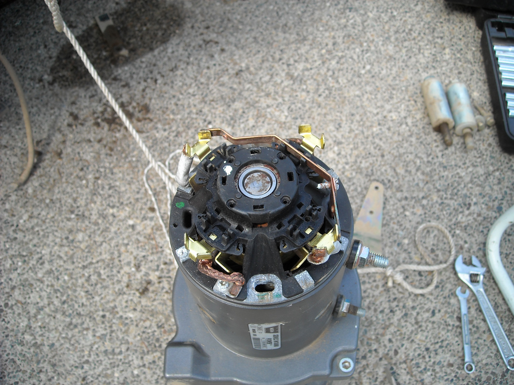

My HS9500 has been non-functional for almost 2 years now, I tried to use it to pull someone out of a ditch in an ice storm, and when I tried to use the motor to spool out the cable, I heard a nasty SNAP and that was it, no more worky.
So today I finally took it off the bumper and tore it apart. I gotta say that even though it's 6 years old, I'm pretty disappointed with the lack of weatherproofing on this thing. BOTH ends have significant water damage, and all of the bolts and cap screws were a challenge to get out. I'm really not sure I'm gonna be able to salvage it. This model is no longer available, so I'd have to replace it with a 9.5XP, best price I'm seeing is around $1250, a 50% increase over what I paid for this HS9500.
I read this thread, and looked carefully at the instructions (I still have them), there is NOTHING in them about opening up a drain in the motor for any type of mounting. I can see the drain in the casting, it looks to me like it was originally clogged with grease. Mine is a foot-down setup. I'm pretty sure this motor is junk, it's very corroded inside. A new one is almost $400 from Warn.
The part that snapped is a small planetary gear unit on the motor side, it's called the "Stage 1 carrier assembly". But Warn doesn't sell just that piece, you have to buy the entire drum support, another $225. WTF???
I guess I'll call Warn on Monday, but I'm pretty sure they're gonna tell me I'm SOL.

I called Warn Customer Service, they didn't seem too sympathitic, although he did say that their winches are covered for lifetime for defects in manufacturing. IMO, this is a manufacturing defect. As far as I know, it's not a maintenance item to have to tear a winch completely apart every year and make sure it's not full of water. This winch has NEVER been under water (I don't roll that way), and I don't think I've used it more than 6-8 times at the most. I tried and tried, but the motor is unrepairable. The bearing at the outer end of the armature is totally rusted to the armature, but it is all crunchy and nasty. I can't get the plastic brushholder out of the end housing either, so now there's no way to get it back together.
He said they can't diagnose a warranty coverage of over the phone (understandable), so I have to ship it to an authorized repair shop and have them make the call. I guess I'll have to take the chance. Now all I have to do is find a strong enough box...

I pulled the winch line off, packed up the winch, shipped it off to Hoaks 4WD Center in PA. I also included copies of all the original docs & receipt, and a 2-page letter explaining how it failed and I discovered the water damage.
Just got off the phone with the tech, Warn took care of it, even the return shipping. New motor, gearbox, planataries, line brake, gaskets, etc. Total rebuild, on their dime. He said it's basically a brand new winch. So, my faith is restored, huge relief.
The tech Eric was really friendly, explained that it's not a bad idea to at least pop the gearbox section off occasionally and check the grease. He also said it's not good for them to sit unused. Even if you just unspool and respool it occasionally, it helps. I guess that makes sense.
