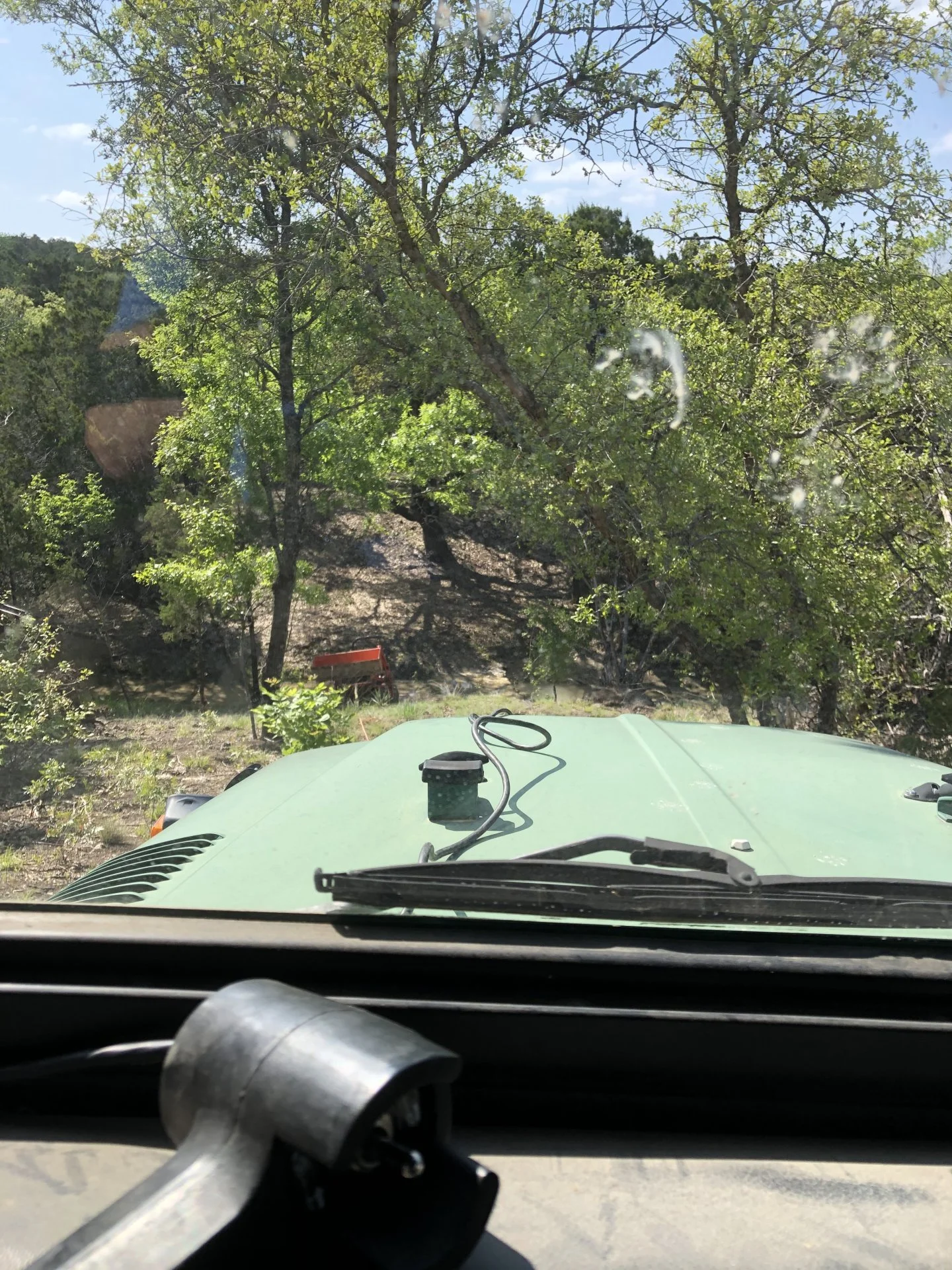

Used mine recently to pull three cemented-in camp grills out of the ground, and to recover a stuck tractor in a creek, way down a steep hill.

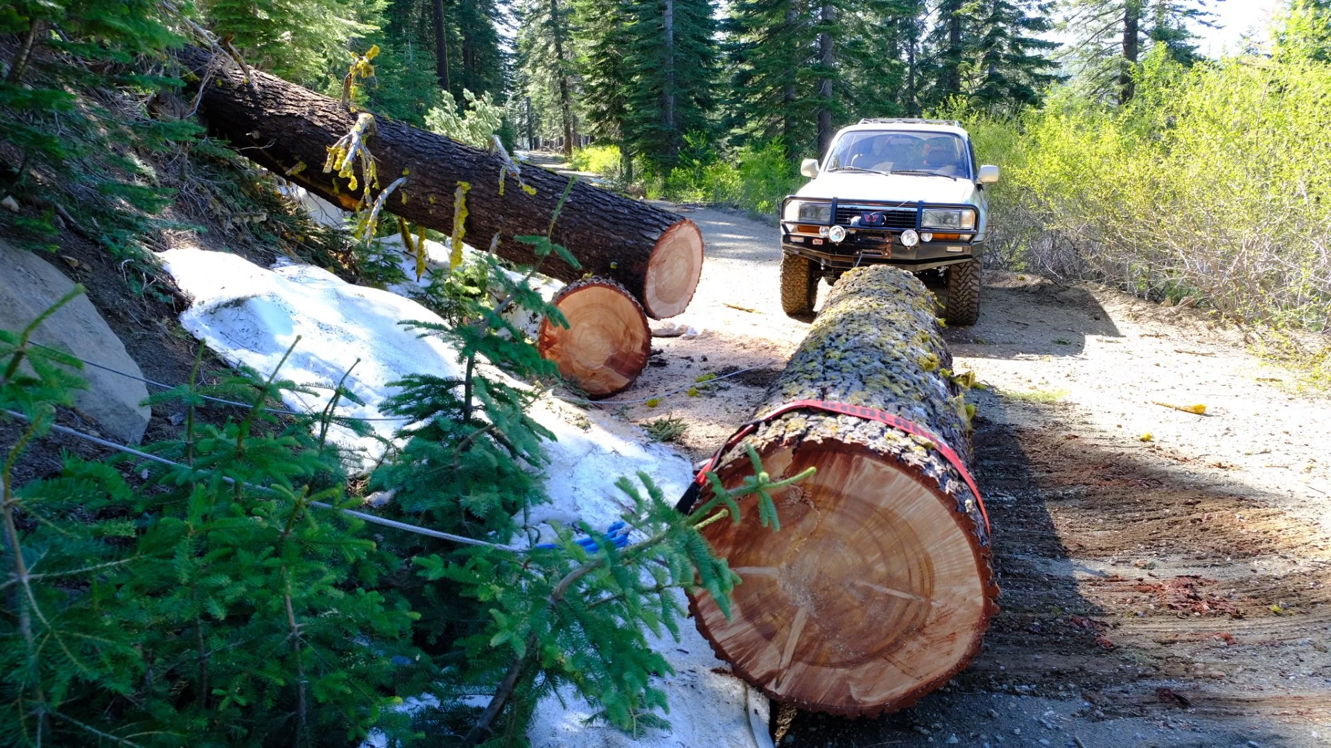

I have both on my 8274's .....the 68608 is on my LX-450 and the 70865 on my 97 F350 crew cab long bed.
The Warn 70865 will absolutely drag my truck, found this out pulling out a tractor that accidentally backed up into a pond
The Warn 68608 is a beast as well, dragging Lots of fir and ponderosa pines off of roads
Both these motors are "top shelf" it takes an 8k 8274 to way over 10k rating (possibly near 12k) with speed and reliability
