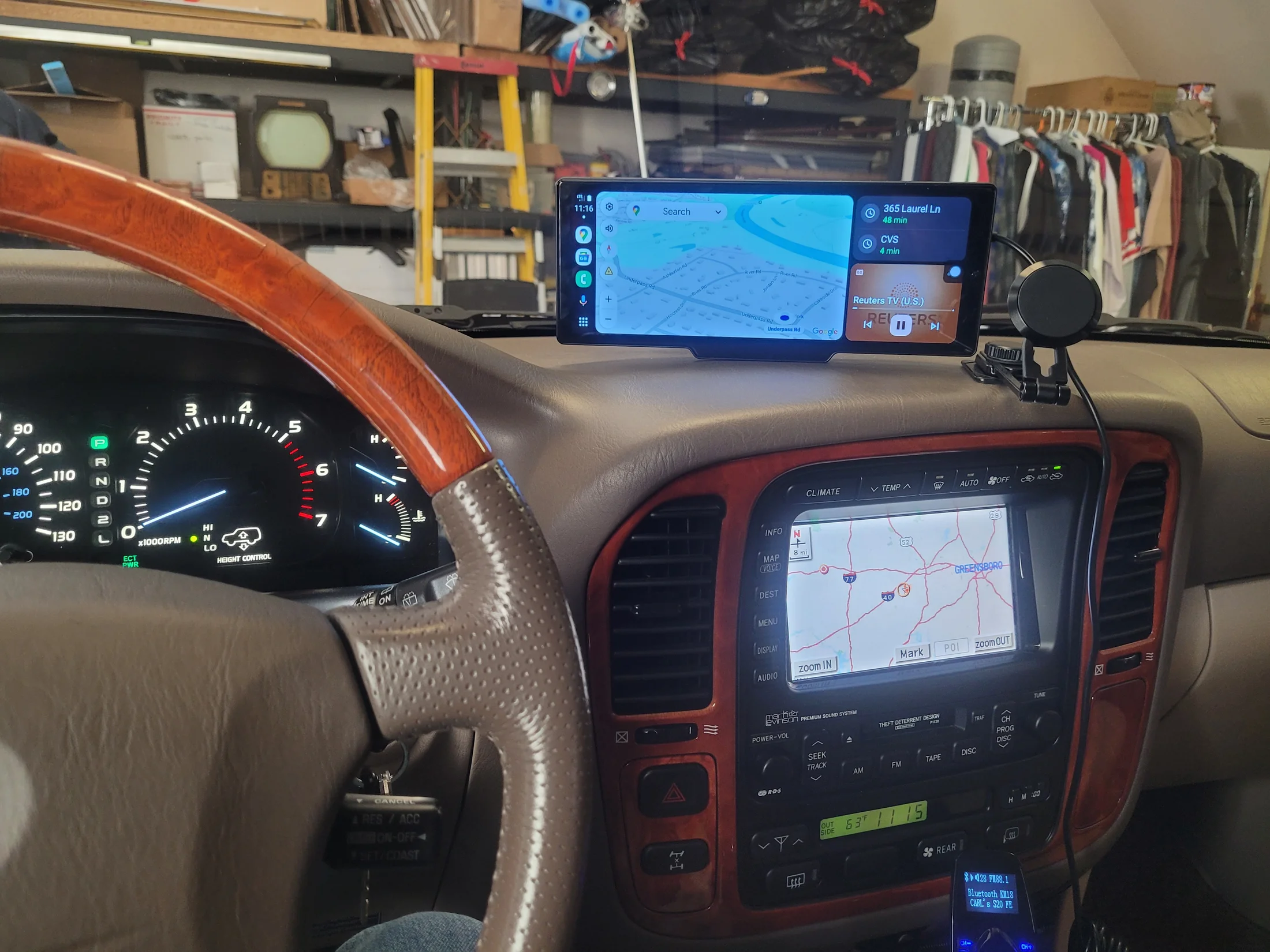

This is the LAMTTO device that works well with my Android phone:

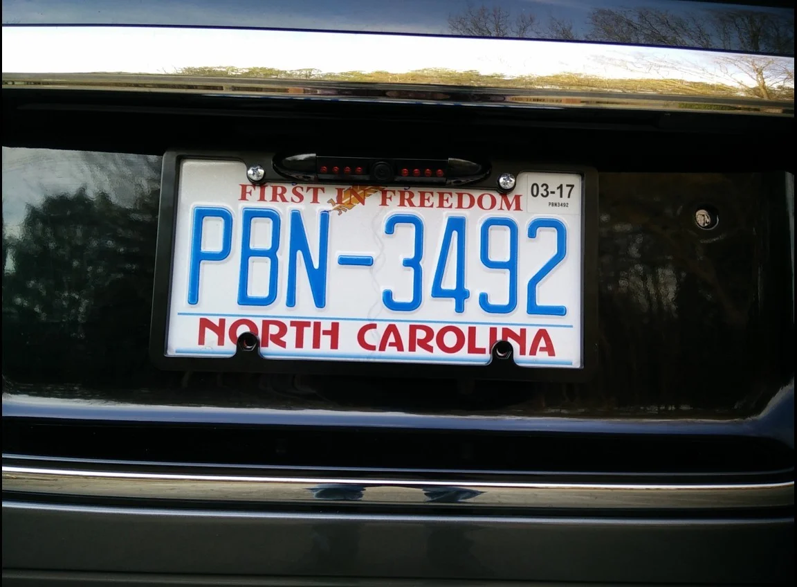

This is the camera in the license plate:

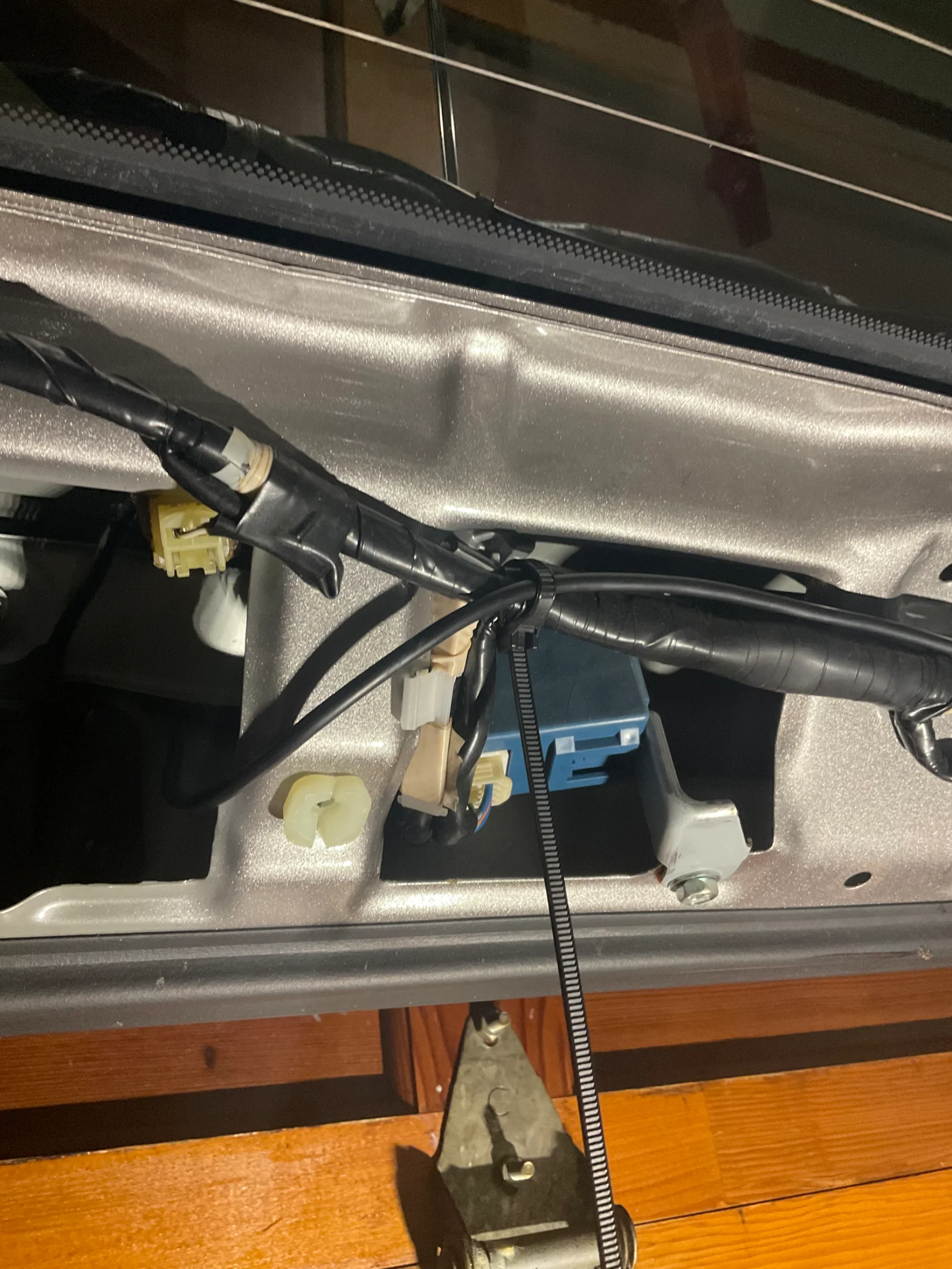

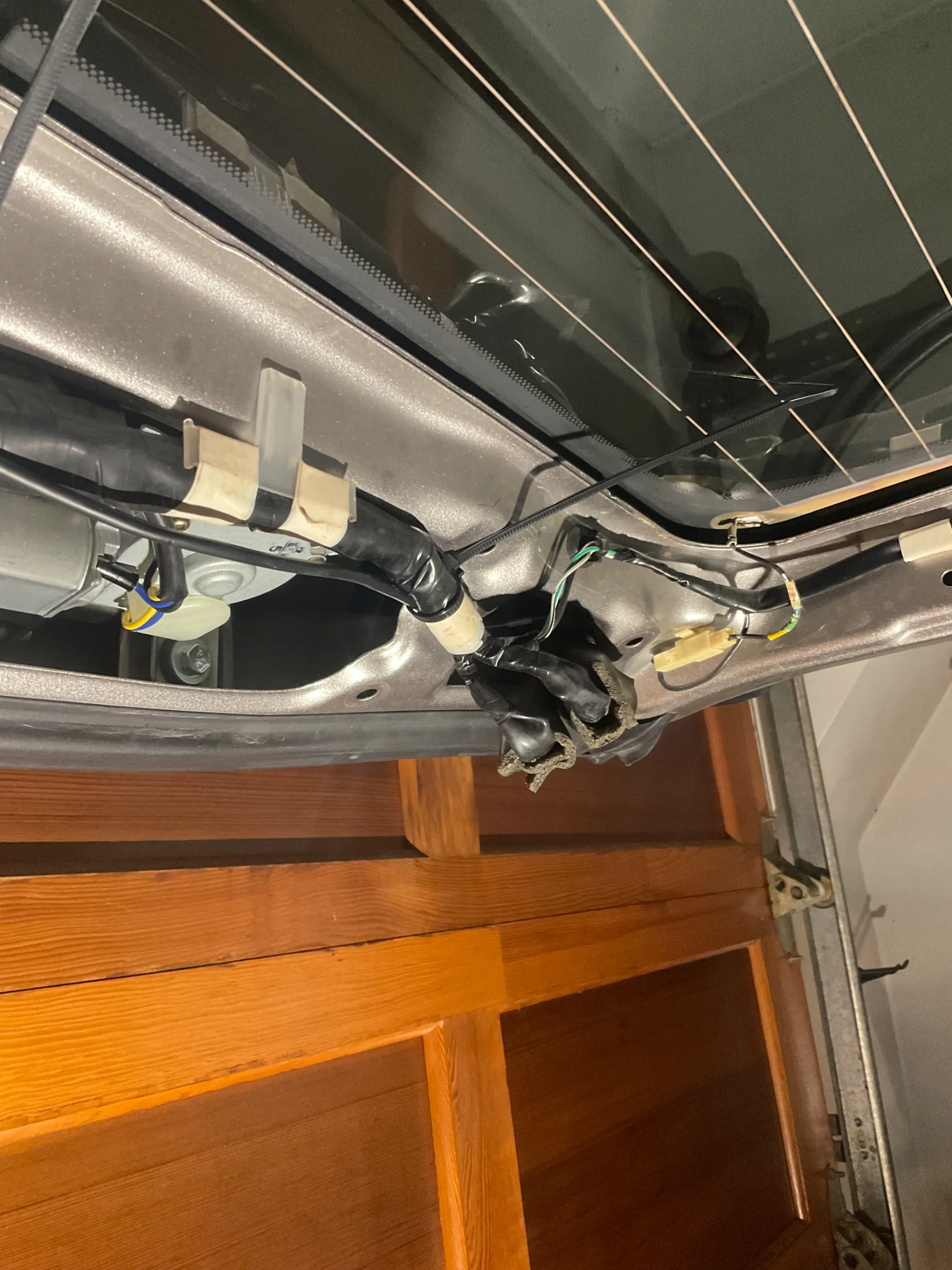

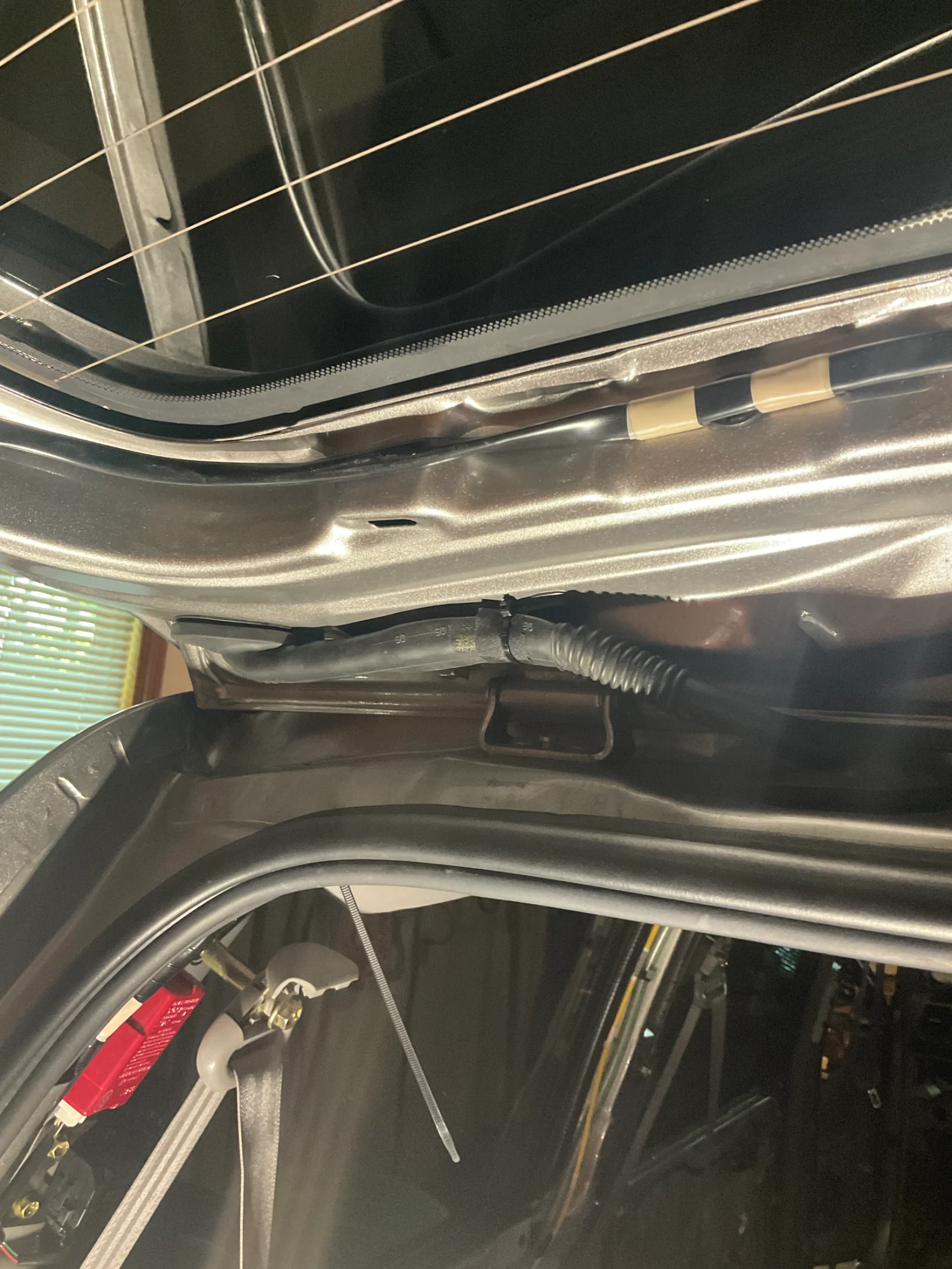

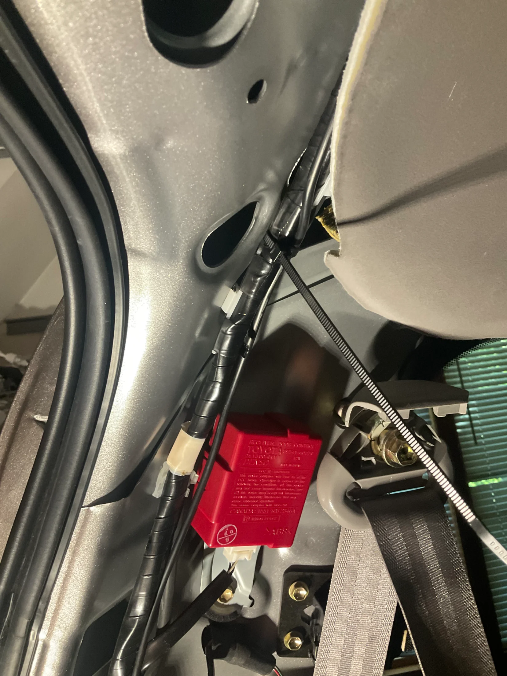

I ran the wire under the carpet and sills, then up and along the top/inside of the far-rear interior trim panel. I just popped off the top of that panel and taped the wire to the body. Then came down and out the corner next to the tailgate where it floats/spans that gap. Don't overthink it.
