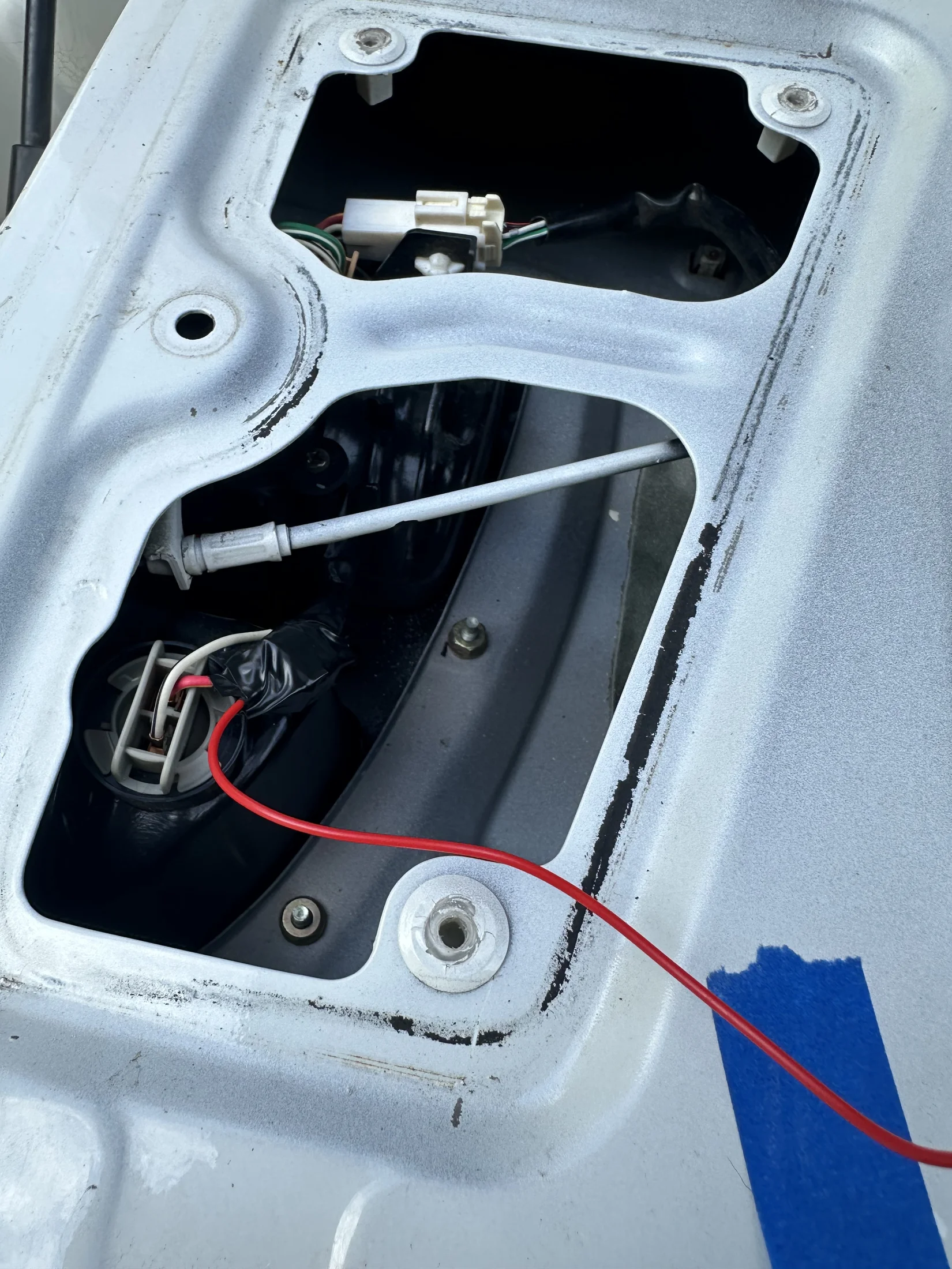

I’m just a little bit handy so I installed it myself and ran all the wires through the body paneling. The back up camera is connected to the reverse lights so it’s only enabled when I switch into reverse.

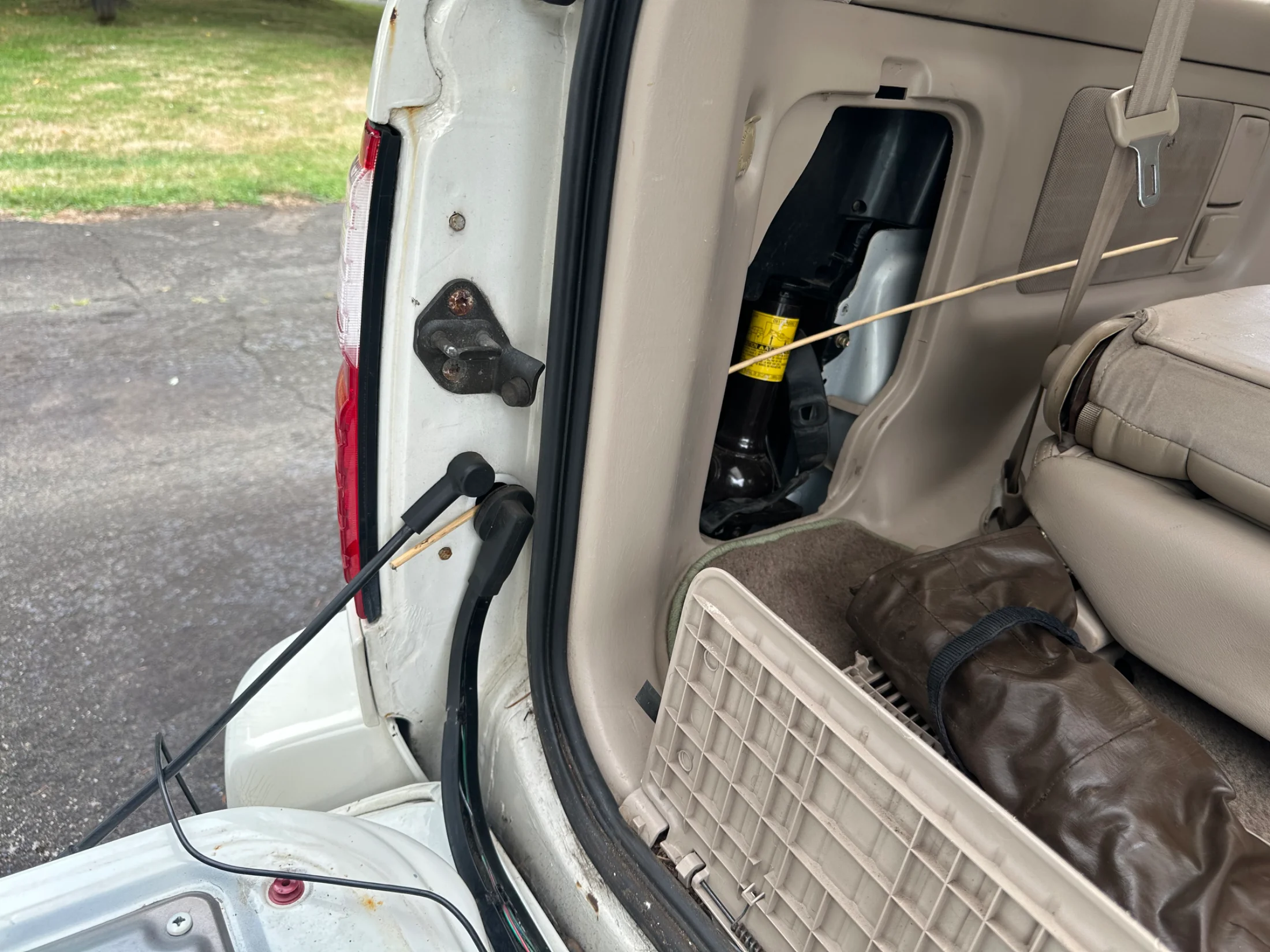

Ran the cable through the rear along with the factory wiring, then put it behind the upper interior panels to the front.

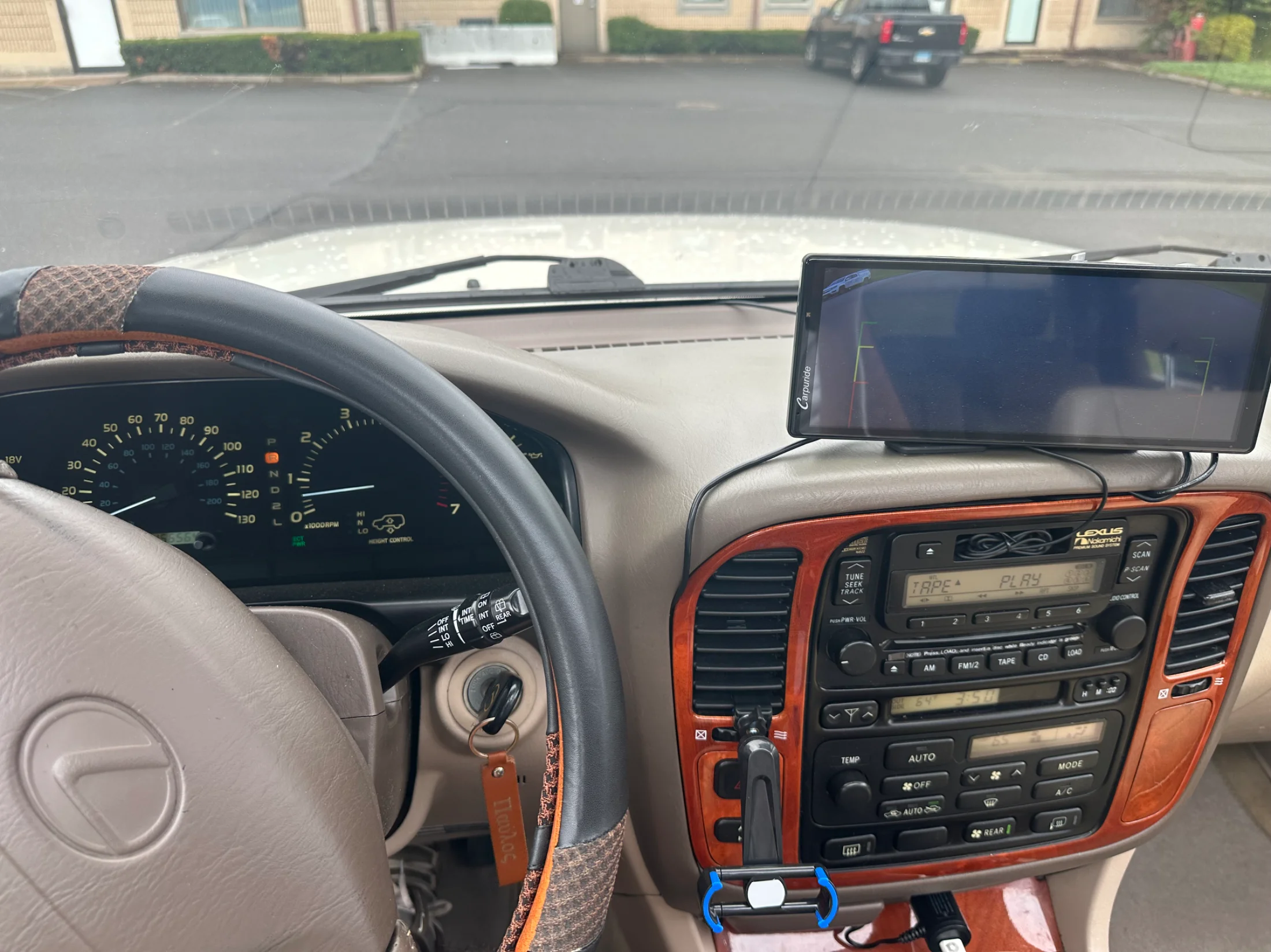

I tucked most of the cables in through the dash and have not yet hardwired it into the fuse box so the excess power cable from plugging into the lighter is hidden away in my mostly closed ashtray.

For anyone that’s wondering the unit is the “2025 Carpuride Wireless Carplay & Android Auto with Dash Cam” with a 10.26” touchscreen.
