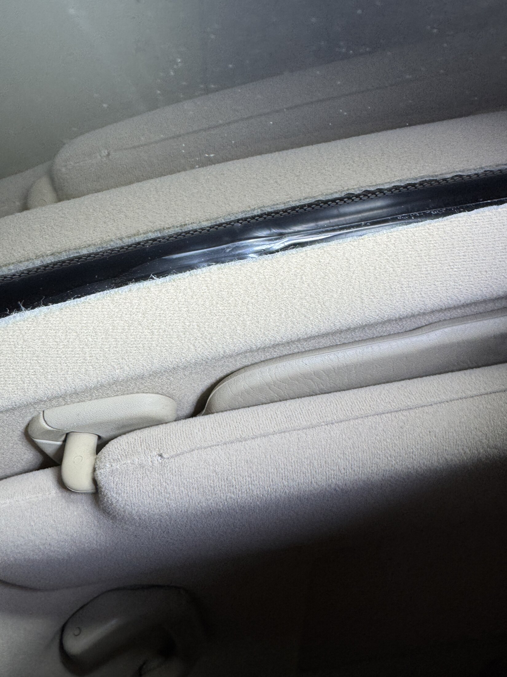

On top of the intermittent nav and backup camera problems, the cruise control gave out on me this weekend. It threw a CEL and VSC TRAC / VSC OFF lights with P0500 being the code for a speed sensor. Cleared the code with my scan gauge but it immediately came back so I knew it would be persistent. It was raining when the CEL came on, so I couldn't shake the idea of water intrusion. Toyed with the idea of buying a replacement speed sensor (part number 83181-12020) and speed sensor sub assembly (part number 33403-19595) but I didn't think the sensor was bad only because of my previous 'luck' with intermittent electrical problems. I figured they all had to be connected.
Lo and behold, this morning when I come out to the car I noticed some water streaks on the inside of the windshield on the passenger side. Traced it to an inner windshield seal. I may have found my smoking gun.
My apartment has a garage so I don't park outside, which is probably why it took so long for this to come to light. I have an appointment with a local windshield shop to take a look and see what the best course of action is. There is a worry of rust, but if it was localized to the top of the windshield then I'm hoping for the best.

Lo and behold, this morning when I come out to the car I noticed some water streaks on the inside of the windshield on the passenger side. Traced it to an inner windshield seal. I may have found my smoking gun.View attachment 3841061
I just went down the new windshield road. The “Achilles heel “ of this job are the 2 trim pieces that are riveted to the body. There are many threads on it. The trim pieces are over $100 each. If they are not damaged they can be reused if removed properly (FSM). I did all the rust removal/repair myself and removed and installed the trim pieces myself with rivets. I hope the glass person you get is competent. The Safelite guy that showed up to do mine jokingly stated they drew straws to come do my windshield. I had all the critical work done. He was very happy. I was happy he didn’t get to ruin my trim pieces and put her metal screws in my cruiser. Good luck with your windshield replacement. Be militant about them fixing it correctly. I had the FSM out for the guy.

I tried to do the OEM glass through safelite and they had to refund my money because they said they couldn't get it. So I went with the non OEM. I ordered all the appropriate stuff from Partsouq (Dams, spacers, small molding pieces, mirror mount) just so when the installer arrived and I plopped the FSM in front of him he had everything to do his portion correct. The parts I mentioned are very inexpensive and gave me good piece of mind. I watched him from inside the house. He was reading and measuring to make sure he installed the dams and spacers correctly. I am pleased with my install. $300 I believe.
New windshield installed and sealed. The old seals were letting in water in the A pillar and behind the dash. Going to be taking it into a shop next week to get a feel for the damage the water caused.
