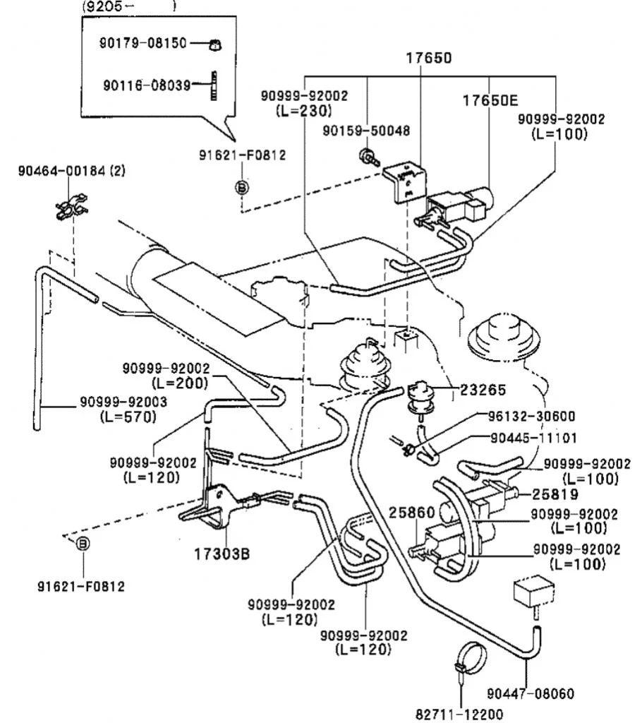

Here is a vacuum diagram for the 2L-TE. Just follow the vacuum lines from the EGR system and delete them. IIRC there is only one line that comes from the vacuum reservoir that needs to be plugged. I posted a basic delete in my first build thread; the only block off plates you will need are at the two ends of the pipe that goes from the exhaust manifold to the intake across the back of the engine.
Here is a vacuum diagram for the 2L-TE. Just follow the vacuum lines from the EGR system and delete them. IIRC there is only one line that comes from the vacuum reservoir that needs to be plugged. I posted a basic delete in my first build thread; the only block off plates you will need are at the two ends of the pipe that goes from the exhaust manifold to the intake across the back of the engine. View attachment 2170501
IIRC? Can you specify which one needs to be plugged? Cheers.
Also, is all the small diaphragm with the arm going to the small to throttle plate able to be removed ? Cheers
It looks like the line that goes through the little tube on the crossover pipe is the one that provides vacuum to the EGR system, that one gets plugged and everything downstream of it can be removed.
