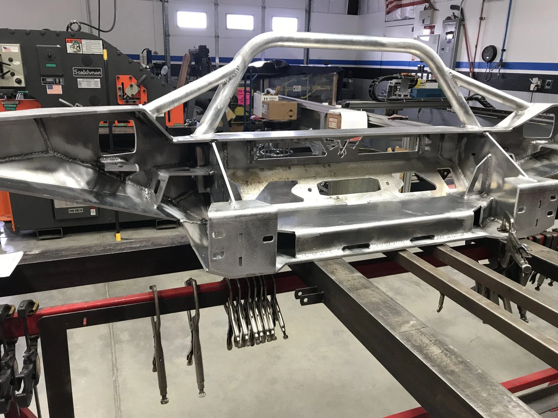

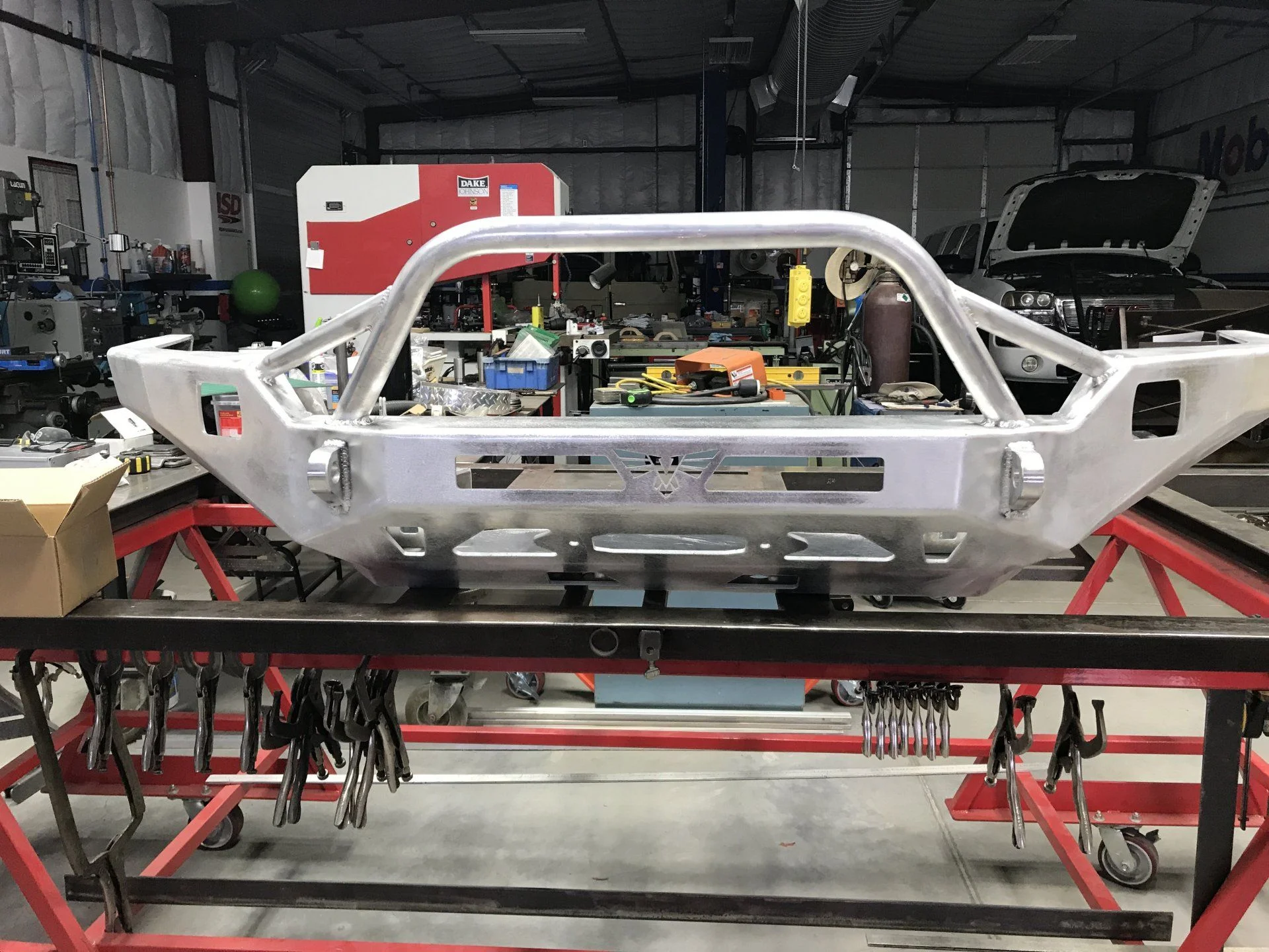

Being a fabricator myself I thought the bumper was designed and built nicely.
The back side details.

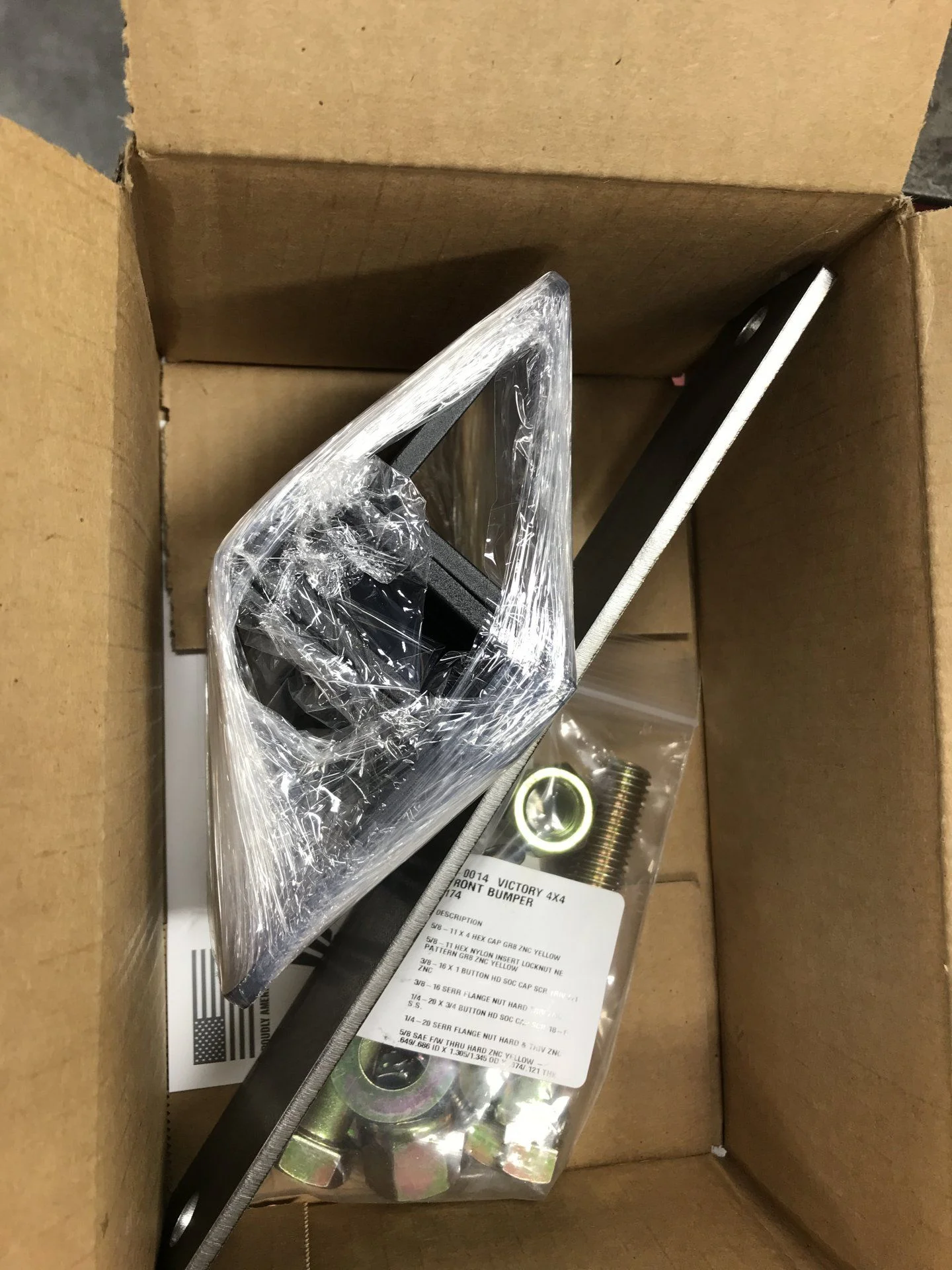

The hardware included as well as side clips.
I smoothed out a couple of welds prior to sand blasting and powder coating. The color was BK168.

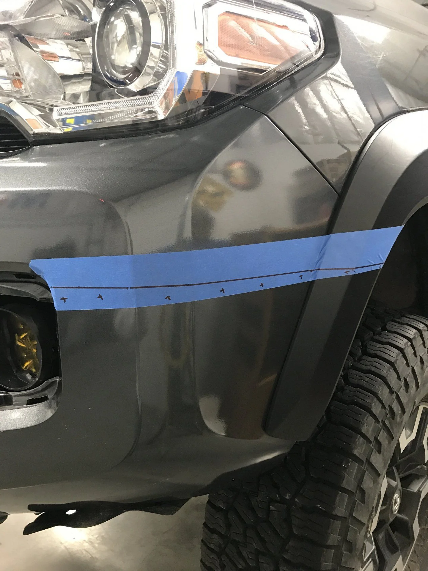

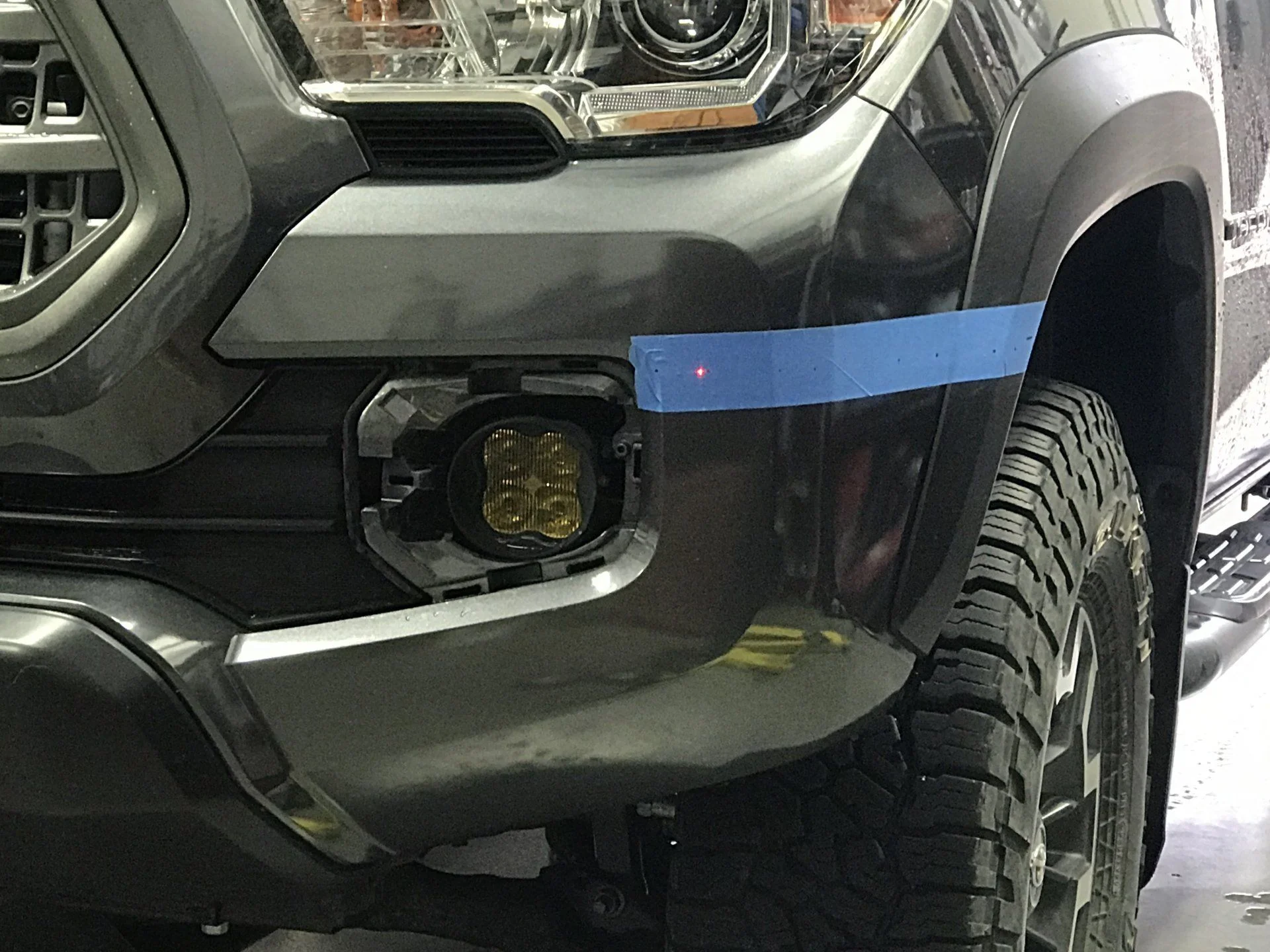

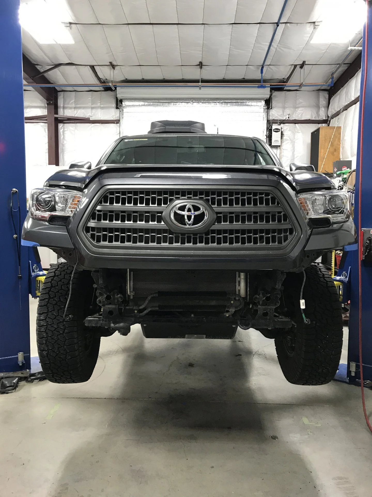

The truck was leveled front to back and side to side by varying tire pressures. Once leveled we used a laser level to plot some points followed by a cut line.
The cut line to follow. We used a 5" DeWalt hand grinder with a cutoff wheel.
I cut the passengers side while he followed up with the drivers side.
This is what we had after the cutting.
The pile.
Ready for the new bumper.

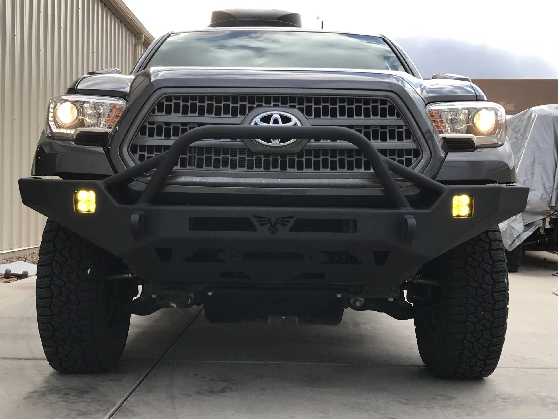

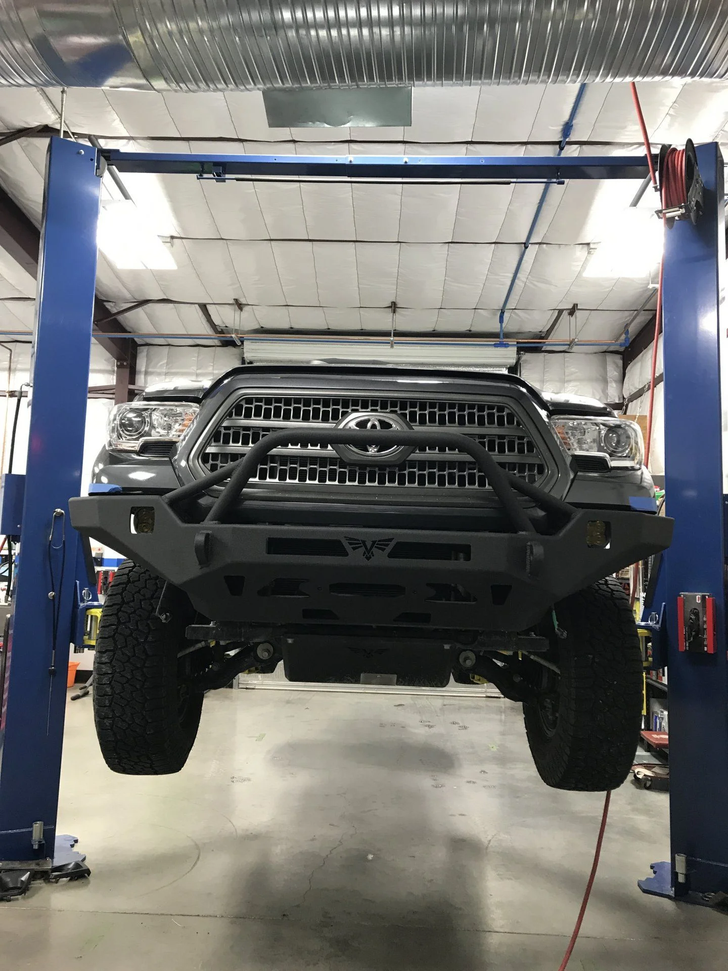

The new Victory bumper indexed right in without issues. The lower cross member will be trimmed cleaning up the look.

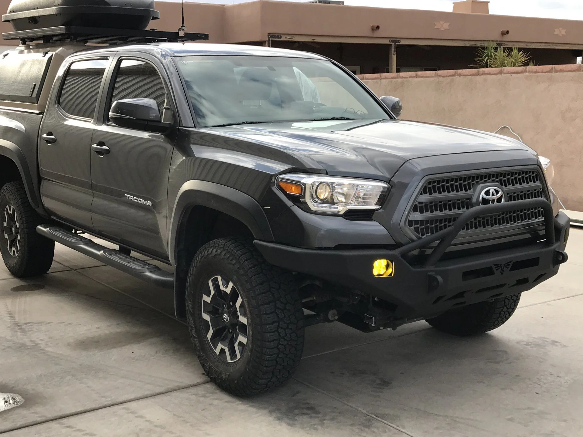

All done! The lower cross member trimmed.

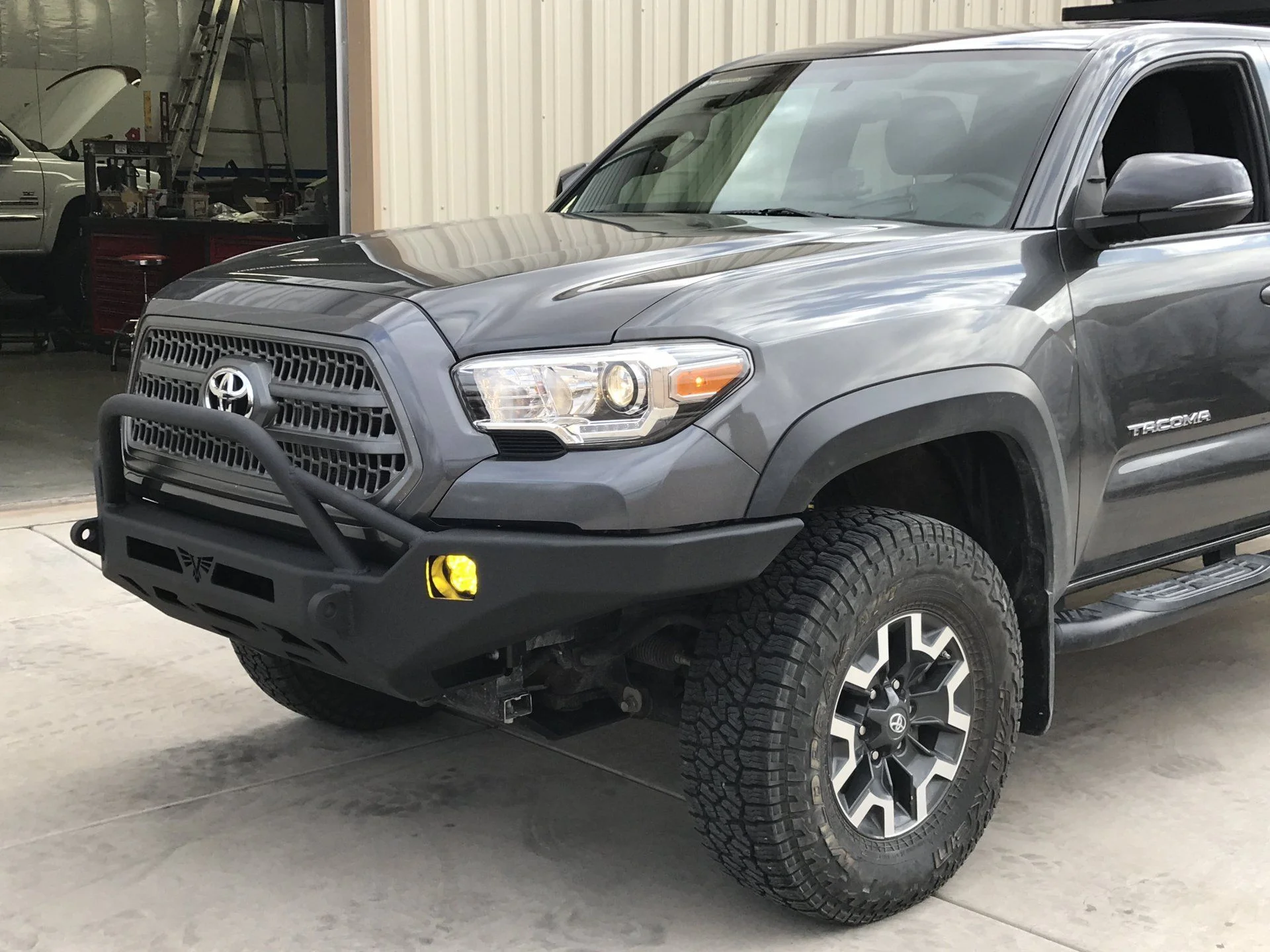

Drivers side.
Passengers side view.

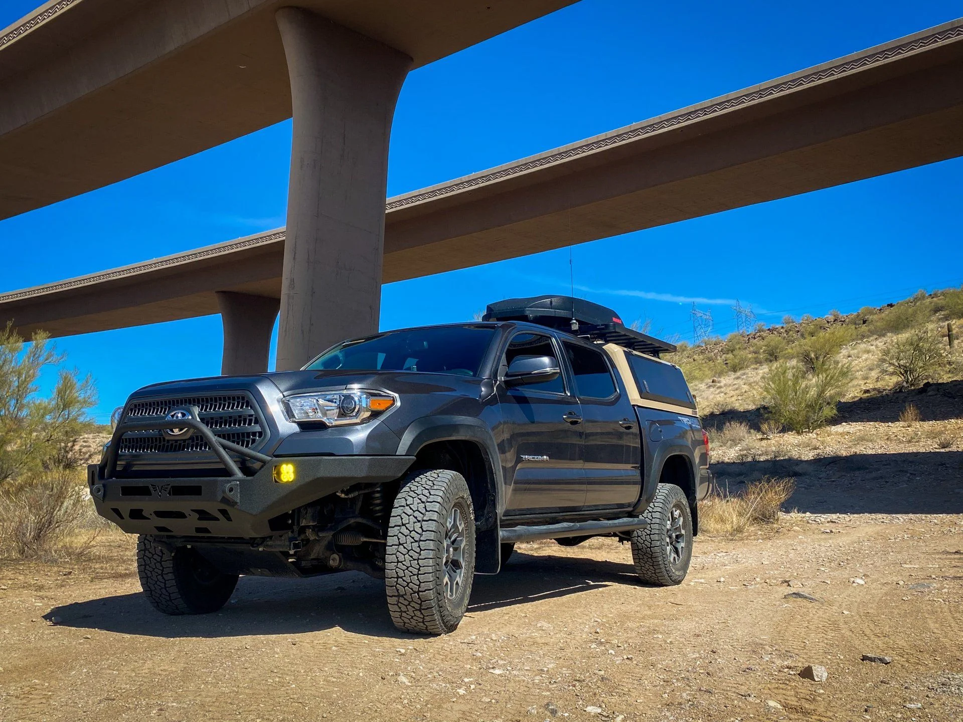

We also serviced his zerks, rotated his tires and designed some sliders for his next visit in April.
Last October we drove this very rig to Colorado and completed Black Bear Pass, Engineers Pass, and hiked the Snuffles Traverse. My nephew really uses this rig as intended. He frequently takes his Wife, two boys as well as their two dogs and drives deep into unfrequented trails. We're planning an Arctic Circle trek in 2023.
My overall impressions of the Victory Bumper design, fit and finish are A+++.
