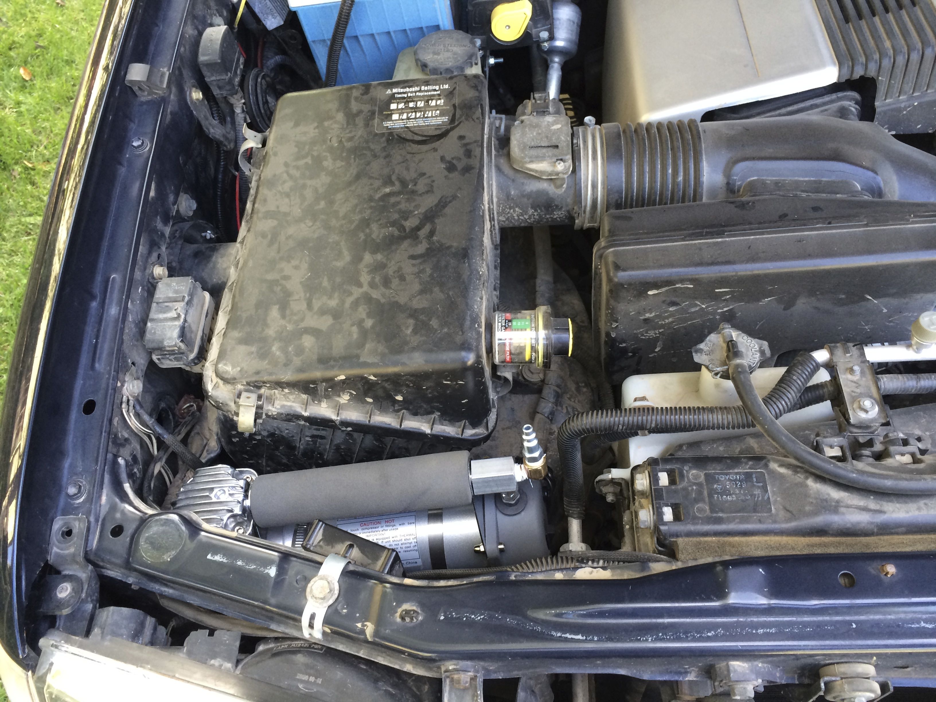

Inspired by SanDiegoCruiser (Thanks, Craig), I decided to finally relocate my Viair 450P to the same spot.
Was a tight squeeze, so added an elbow to make it easier to connect the hose. Works like a charm and should save some valuable space in back for other stuff.
Looks great. I'm probably going to extend the air intake with some hose...
Are you guys not worried about exposure to the elements under the hood?
