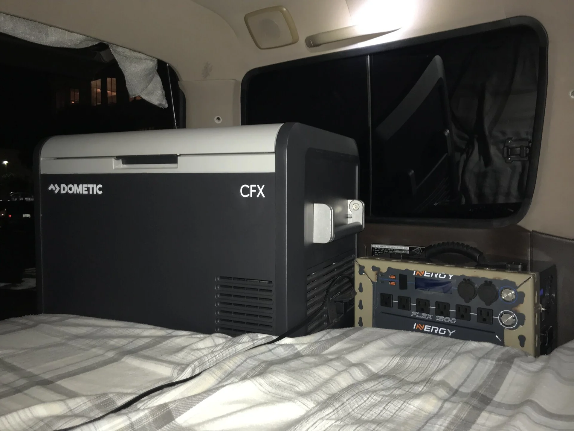

Personally, I'm a big fan of the Inergy Flex 1500 unit. I investigated the Delta Ecoflow, Bluetti, Jackery, and many others, and ultimately landed on the Inergy Flex. I did countless hours of research and built spreadsheets comparing all the specs (charging options and speeds per type, battery capacity, battery expandability, battery chemistry, pure sine wave, regulated DC, number and types of plugs/ports, quality of inverter, dimensions and weight of unit/portability, LCD display with relevant real-time data, price, warranty, etc etc etc.)

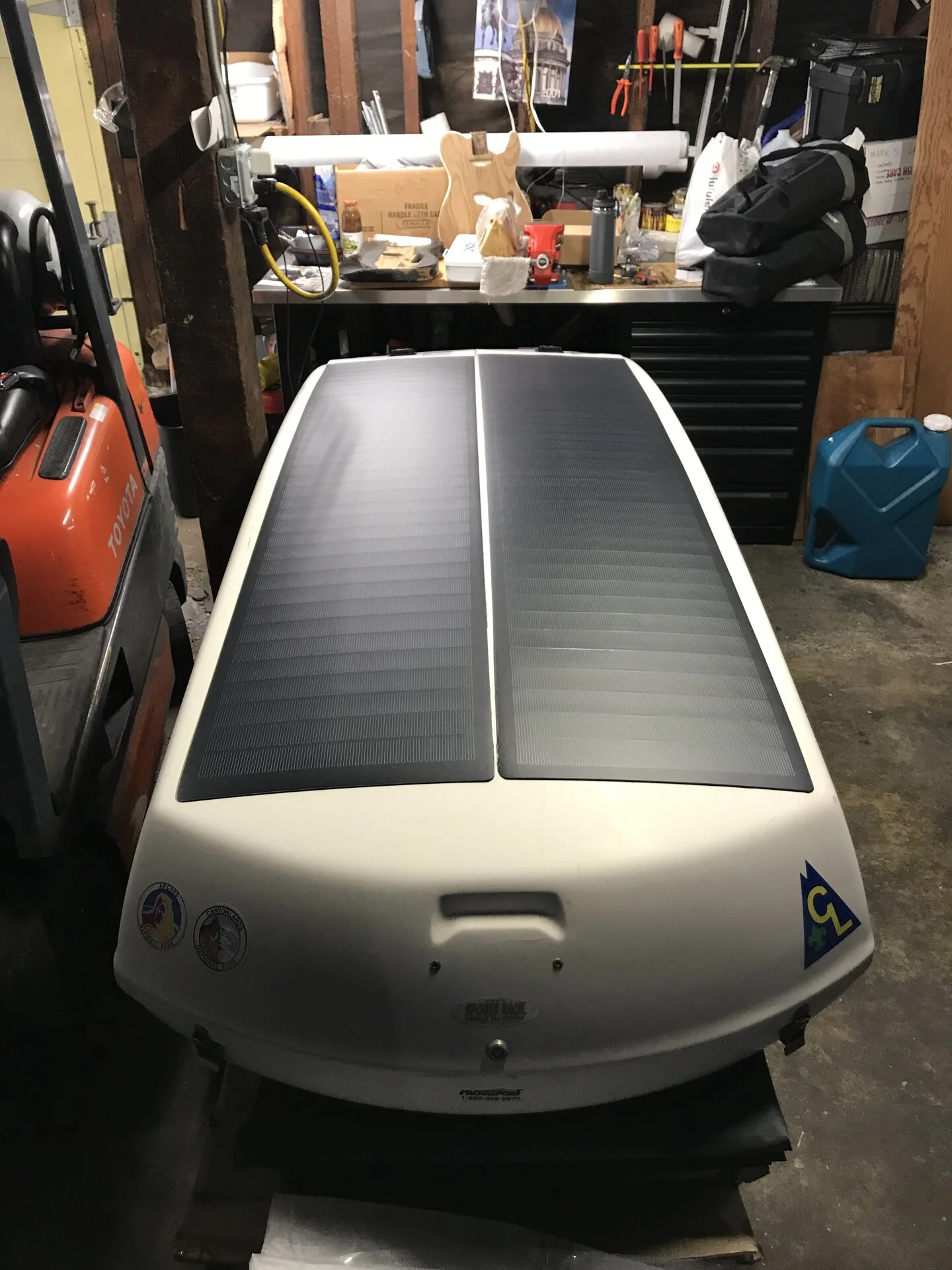

I purchased the Inergy Flex 1500 because it outperformed the others when comparing the spreadsheet specs in totality. I mounted 160W of solar on top of the rooftop cargo box. This system is amazing, super versatile, multiple ways of charging through solar or fast AC. When I'm driving I plug into the inverter I installed, when stationary I can tilt the cargo box lid in the orientation of the sun and get optimized solar charging. Regulated 13.8 DC outputs, 1500W inverter with 3000W peak, pure sine wave, etc. I never had issues running out of power, and with the 1,000 Watts of storage I could run the fridge and all our other electricals (lights, phones, laptops, even movie projector and blender for the girlfriend's smoothies :) while still consistently maintaining charge without fretting. Finally, I fab'd a metal bracket out of shelving uprights and bolted the unit down into the bed platform for anti-theft. Anyway, I recommend these guys.
