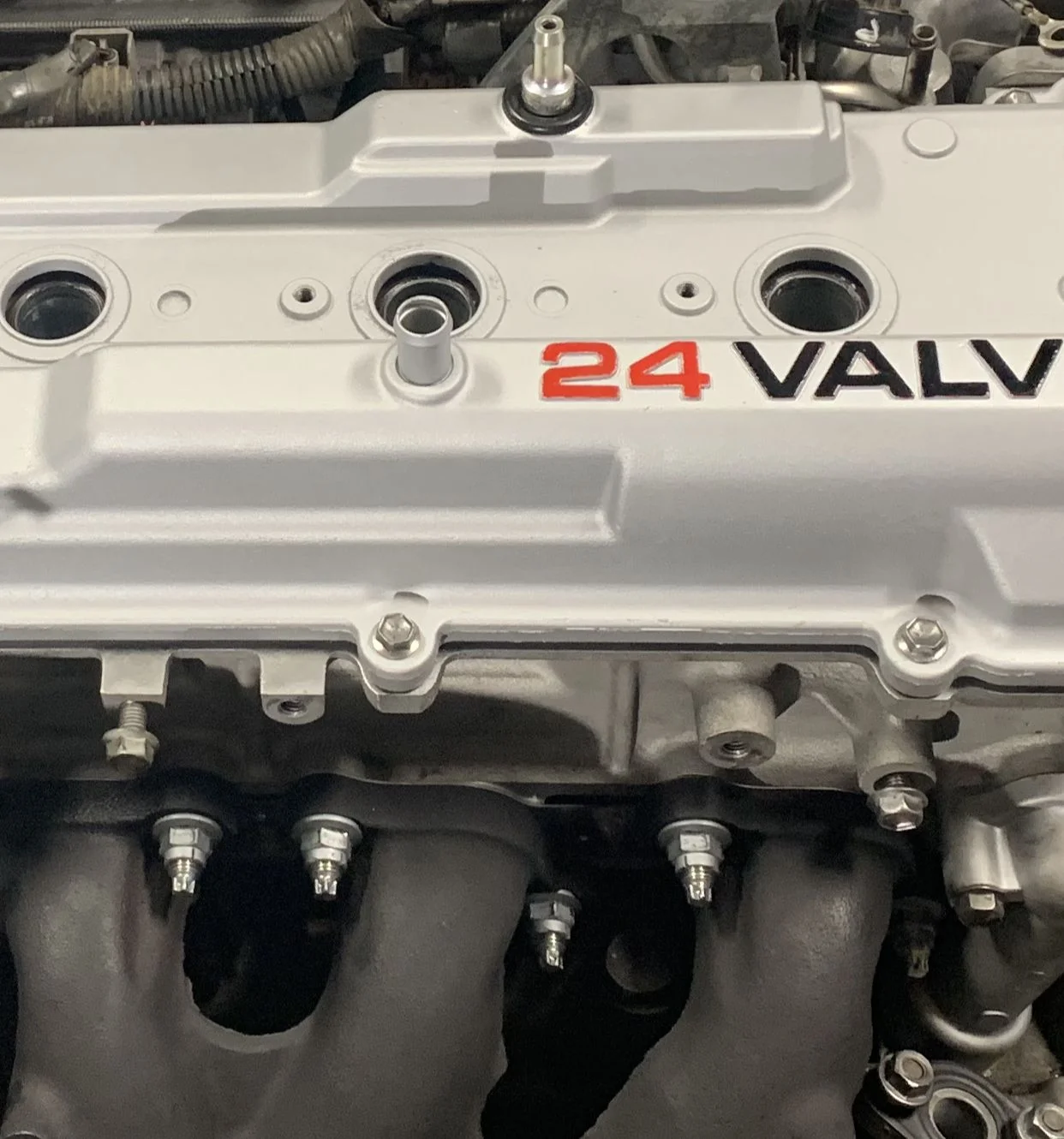

Use a bench grinder with a fine wire wheel. They’ll polish right up like new. Here’s mine with over 250k miles after a polishing.
Wow - you can tell you live in the Southwest. Very clean look. My exhaust manifold looks like it came off a Detroit salt truck.

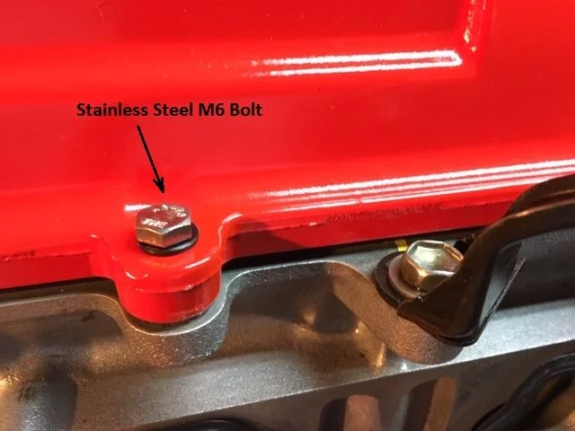

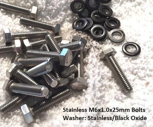

Replaced mine with stainless, light film of antiseize and then just snugged them down. I don't expect to have any problems removing them at a later date.
