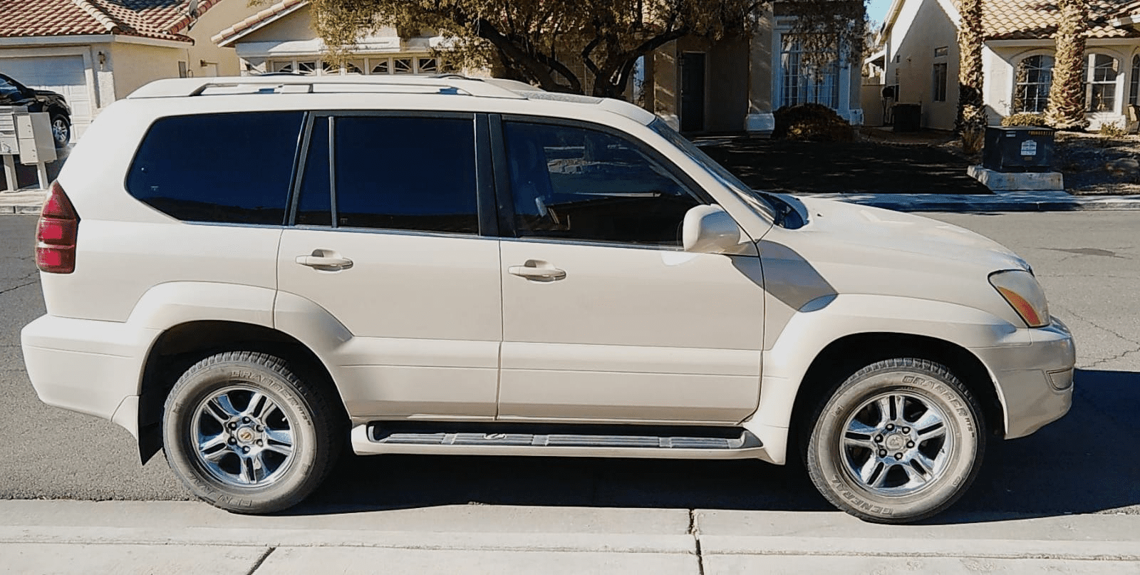

Finally took home great deal on GX470: 2003 Non-Nav Non-KDSS, no third row seats, 225K mi for.... $5900
No major issues so far - TC is dry, rear bags are good, no cracked dash, Timing belt replaced at 185K so I think I am OK for now.
First order of business is basic wash&clean.

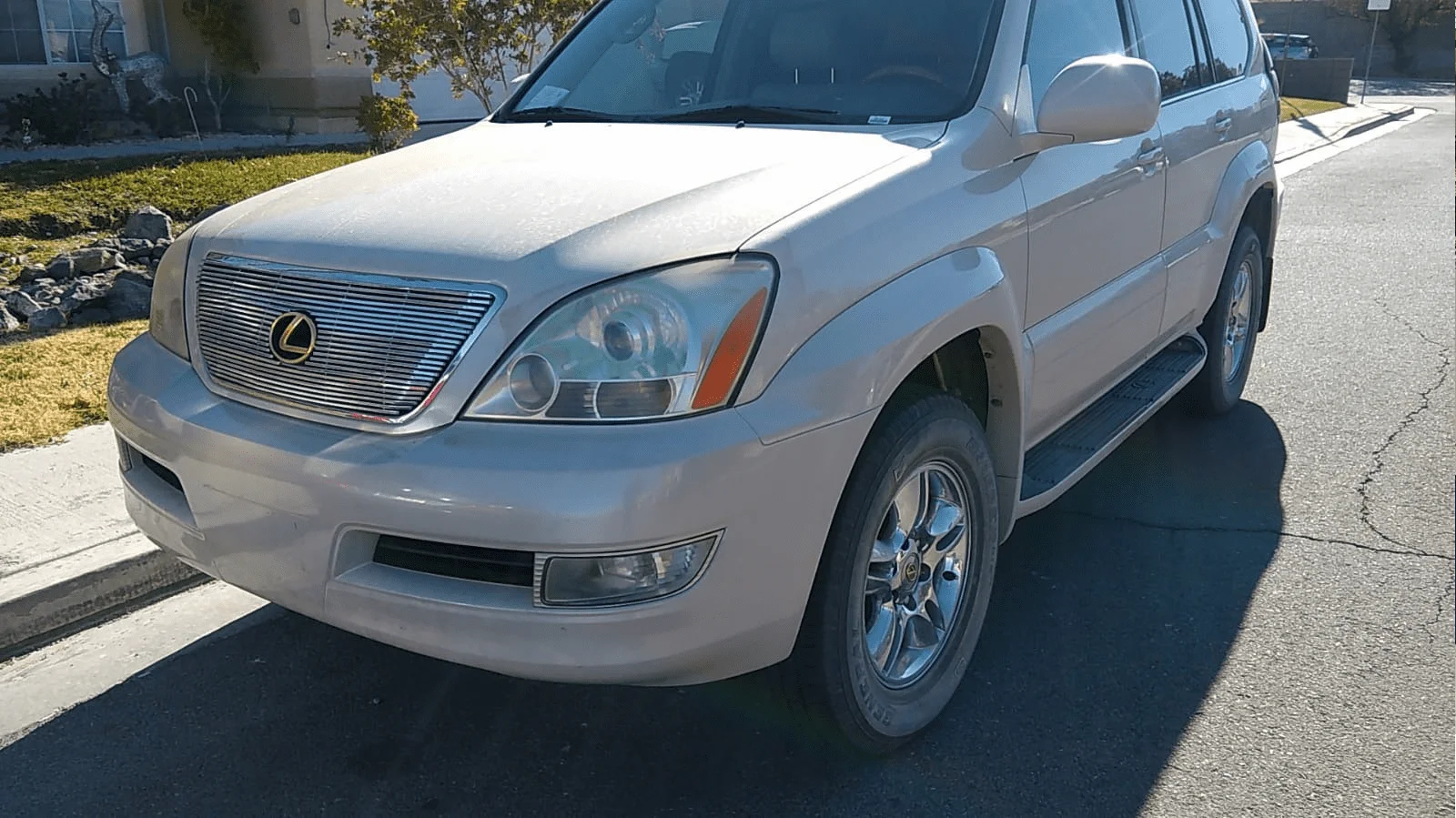

  • Cosmetic stuff - paint grille. I took gaudy cover off but the actual grille is all faded.

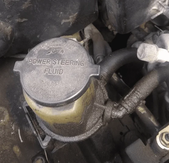

Replaced PS reservoir, return and pressure line (passenger side). Real pain in the ass to do it because old hoses are stiff and dried up. I don't know if there is a trick that I'm not aware of to push the pressure line assembly in place. I had to take one of the brackets off to do it and then reinstall the bracket in place. Turn the wheel to the side and unclip the splashguard for better access.
Toyota return OE line
Dorman OE 4436002020
Sunsong 3401257
Before:
After:
