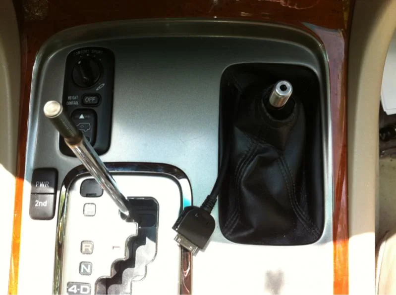

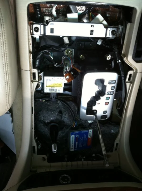

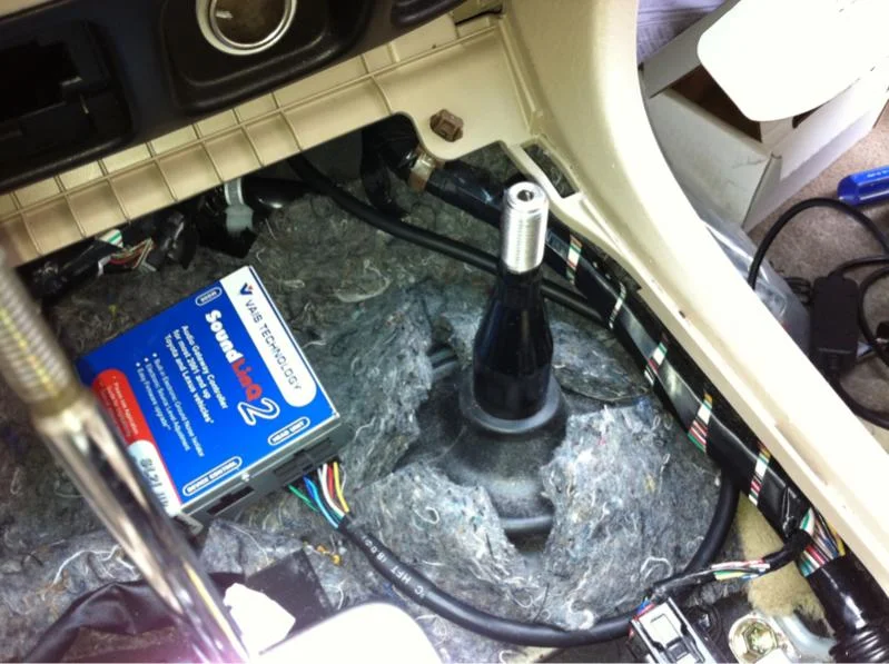

I installed the VAIS SLI2-UP on my 2004 LX a few weeks back. I found the easiest place to install the box is under the center console in between the AHC controls and transfer case shifter. Plenty of space and you have to open that to run your ipod cable anyway. I wrapped the box in foam so it will not rattle. The center console is also a lot faster/easier to remove than the radio/nav stack in case i need to get to the VAIS box in the future.
Pictures attached...not as clear as i had hoped but maybe better than nothing.
Still looking for a good iphone4 mount. May get one from Ram.
